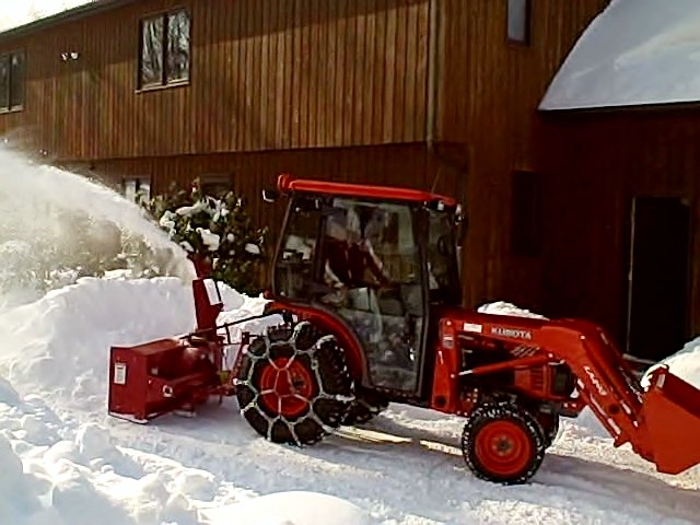

My rear-mounted snow blower weights approximately 400lbs and my B3030 hardly breaks a sweat picking it up.
