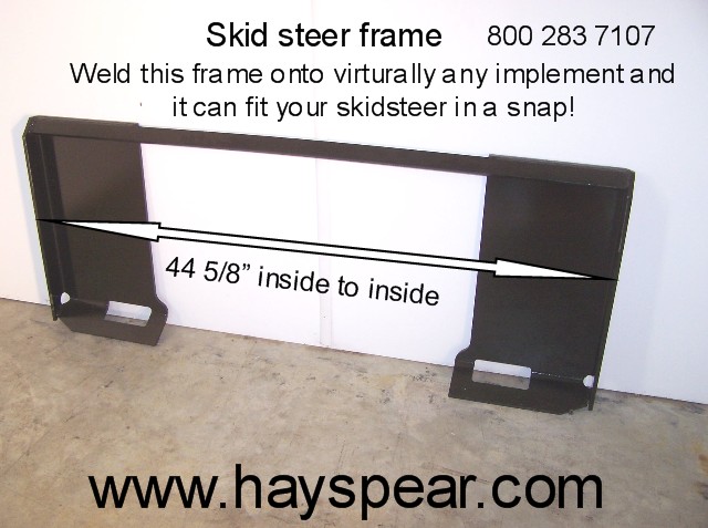

Gar, what type of mount does your HJ2L 54" 4in1 use to connect to the LA403 FEL? Norm
Norm, my 54" 4N1 is a conventional pin mount like my original Kubota 54" bucket. The WR Long guys seem to know their stuff and have been very helpful with my set-up. There is only 45" of "free" space to weld the skid steer type q/a mount to the back of the 54" 4N1 buclet. I'm guessing you will need more than 45". Click here for a pic. Cheers, Gar

amigauser said:
Gar, Looks like 45" might just make it though :). Norm
Norm, I'd give Nelson Long a call (252-823-4570) or eMail (www.wrlonginc.com) and run those number by him to see what he has to say. Again, I'm guessing their skid steer q/a is a bit heavier than Hayspear's. Sounds like the will is there and a way will be found. Custom fab on a bare bucket may also be an option (throw in some hooks and orange paint too)? Cheers, Gar
