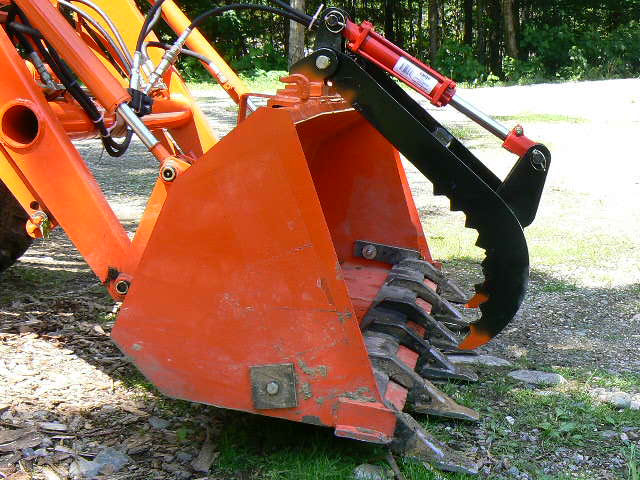

   / B3030 FEL w/grapple hooks
Thanks for the info, I just got off the phone with ATI and I think the grapple kit they offer would be fine. I have to talk with my Kubota dealer (Messick's in PA.) and see if they can install the kit ($850) using the Kubota bucket.

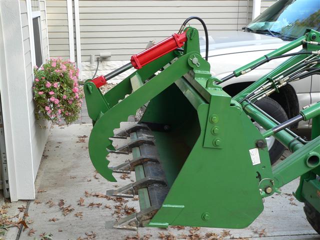

   / B3030 FEL w/grapple hooks #9
Nice pictures of the grapple installed but I do have a question...do you have a problem, since you are not using teeth on tht bottom like a regualr grapple, with getting dirt off the roots, etc?
