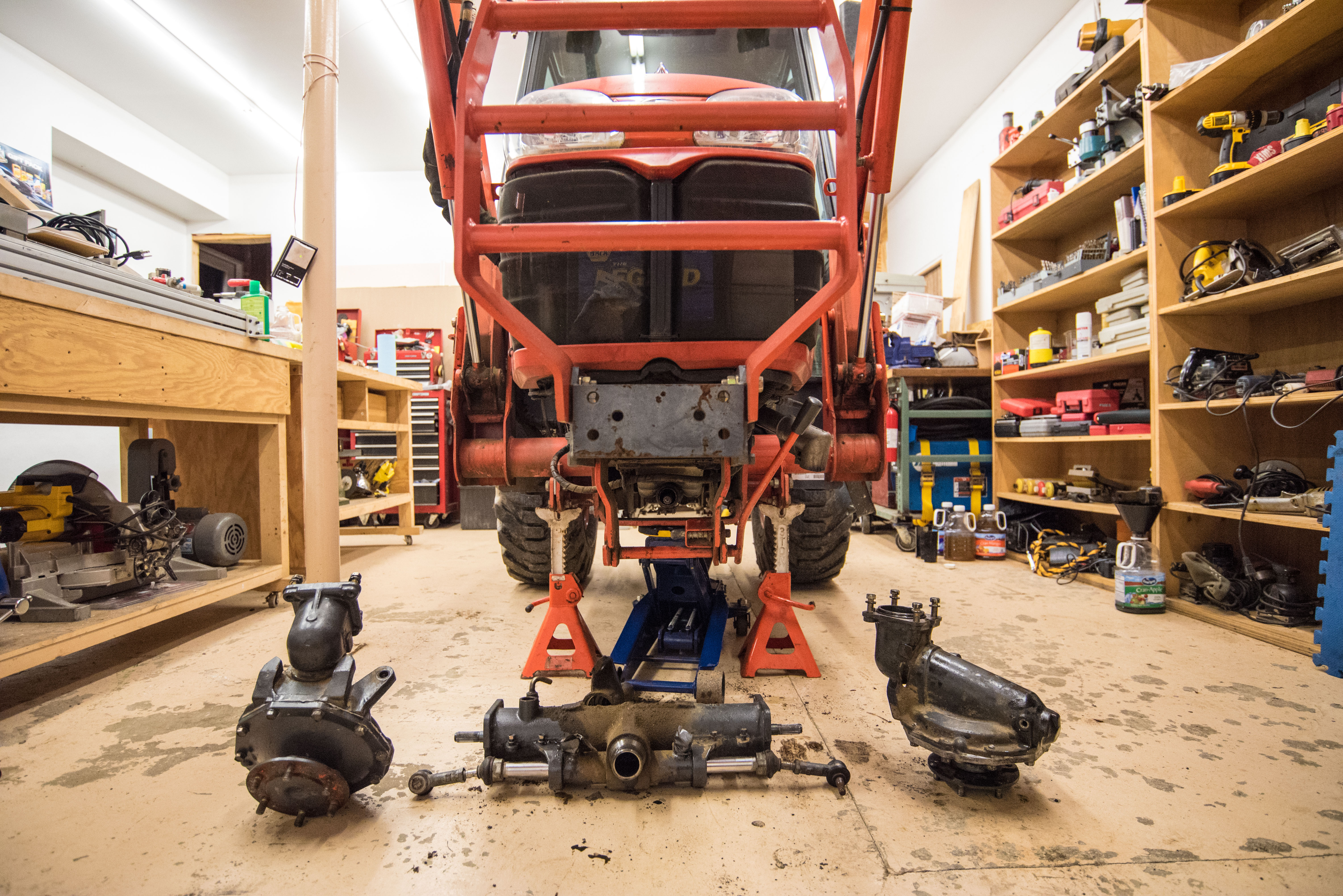

...Any idea what caused the damage to the teeth on the ring and pinion?
No idea. i got the tractor used with 800 hours from a farm in Kentucky (purchased through Barlow Farm Equipment), so I don't have complete history.
Have you shown this to the dealer?
I have not, but Kubota did redesign something. When ordering parts online, I have a choice between two designs based on tractor serial number. My tractor is the first iteration.
Some quick notes:
- Overall, it is a job that can be done in a home garage. The most uncommon tool is an inch-oz range torque wrench to measure the 0.59-0.73 lbf-ft turning torque on the spiral bevel pinion shaft.
- The most difficult part was ensuring proper gear backlash. This requires the purchase of multiple thickness collars/spacers and, in my case, multiple attempts of assembly/disassembly to get it right. I tried to use a dial indicator with an extension probe mounted to a magnetic holder, but couldn't get a repeatable reading. I used the procedure Kubota recommends in the manual, which is to employ a "fuse" (I just used lead electrical solder), which smooshes between the gears as they are manually turned. The thickness of the deformed fuse correlates to the backlash. I found it useful to hold/fixture the axle tube vertically to make it easier to lay the solder on the ring gear; otherwise, it was hard to keep the solder in the right place.
View attachment DSC_9809.JPG IMG_8813.JPGIMG_8860.JPGIMG_8862.JPGIMG_8863.JPG

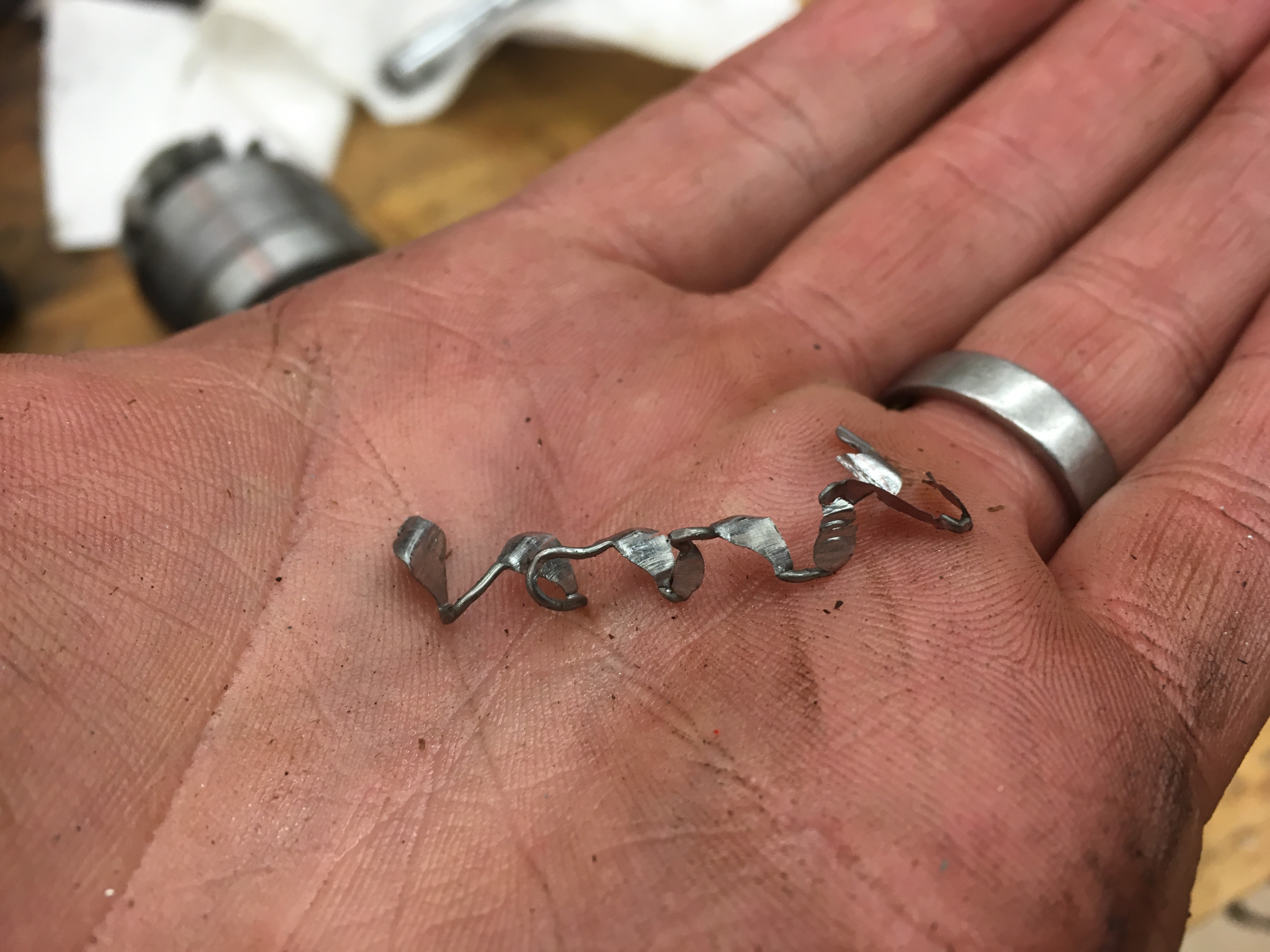

Good job you are doing. You are fortunate to have the skills to to do your own work, would have cost a lot more if you had to pay the dealer. Puzzling about the cause, maybe a bearing failed and pieces got between the gears?

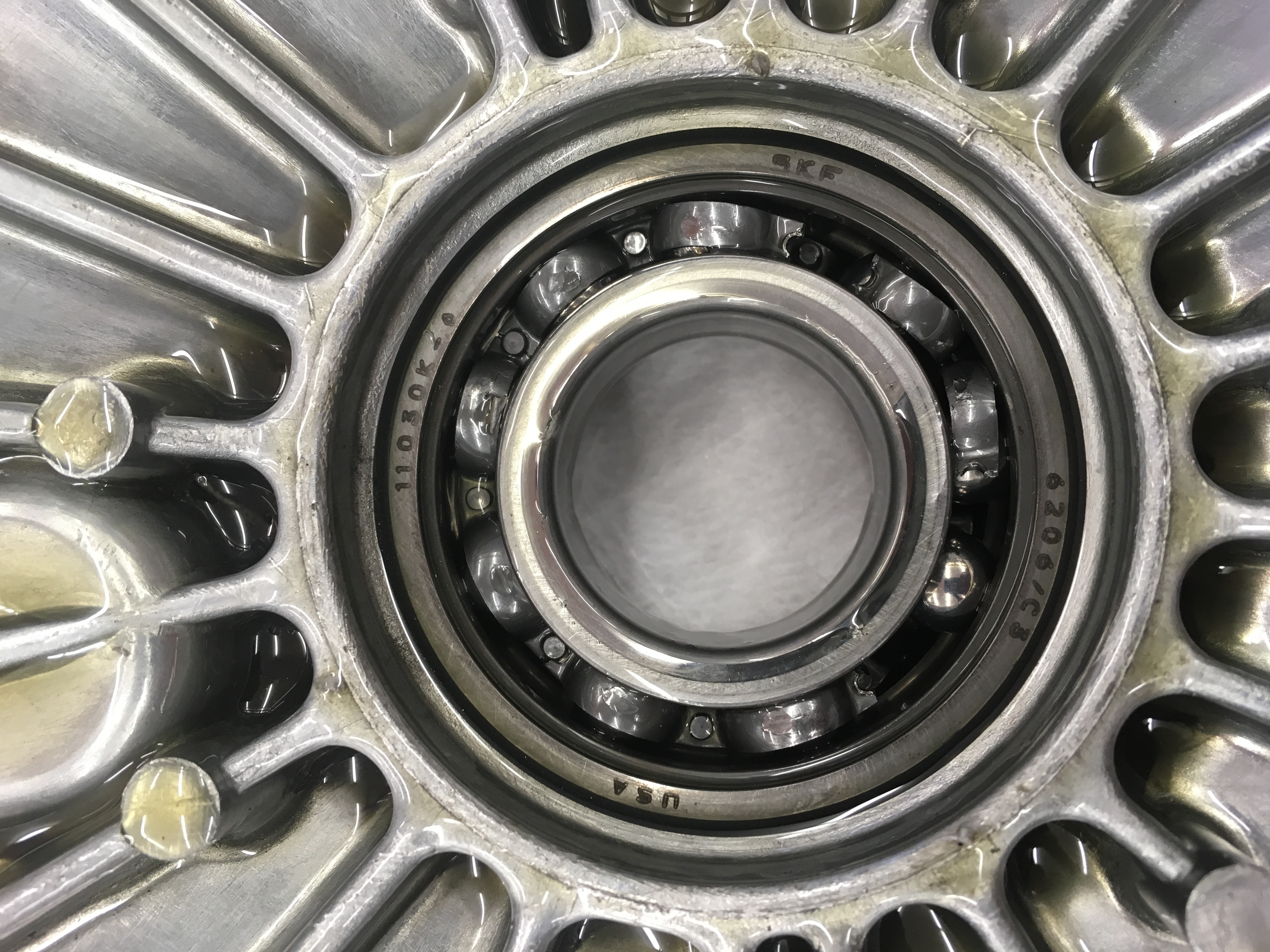

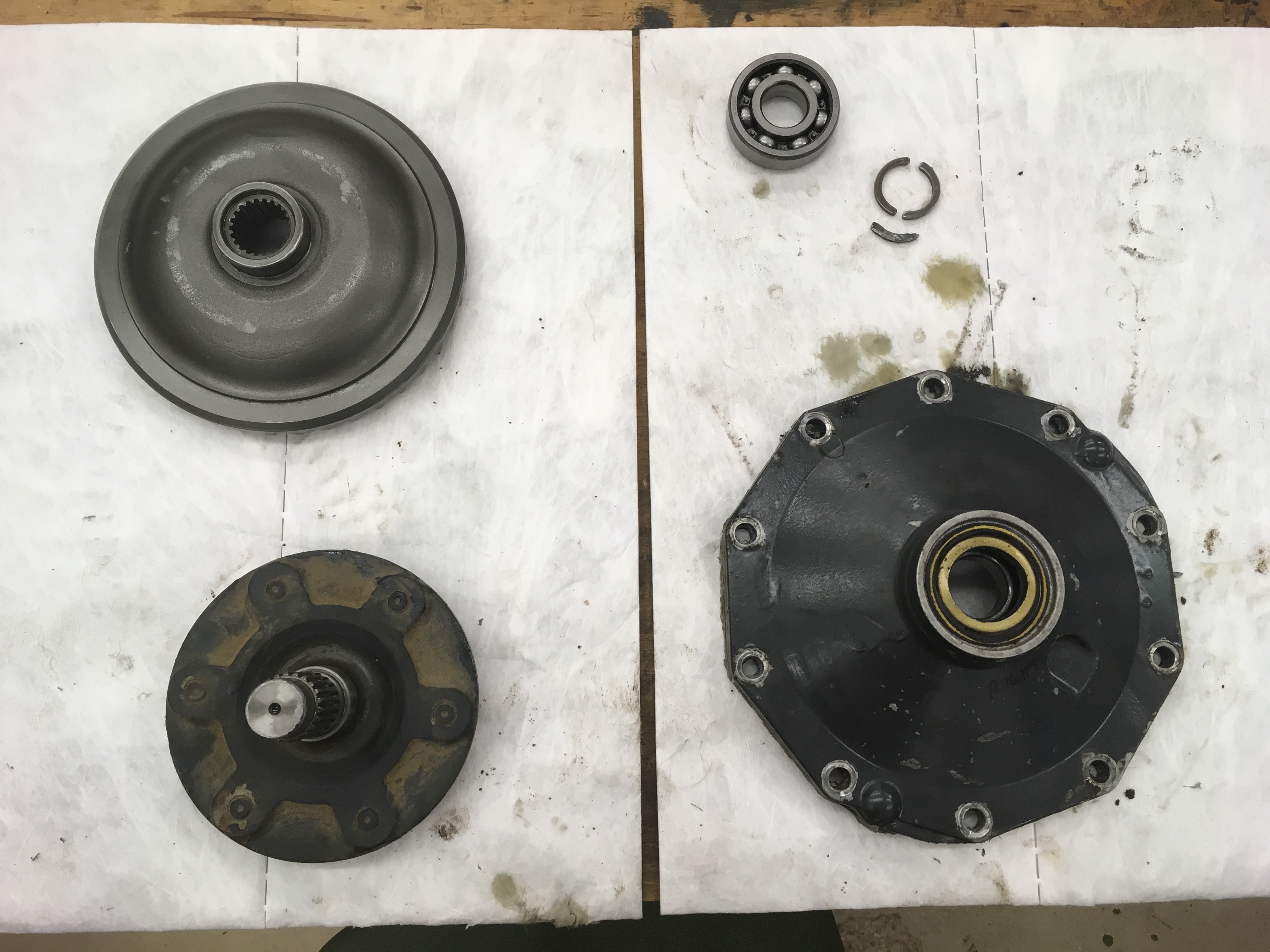

My bevel gear housing uses an O ring to seal. Yours looks to have had some sealing material like silicone used but I cannot tell 100% by the first picture. I will bet if you pull off the bevel gear housings you will find problems as well.
   / B3030 Front End Locking Up (Video)
#16
...maybe a bearing failed and pieces got between the gears?
The bearings in the main axle tube looked okay. I could have re-used them, but replaced them since I don't plan to be in there again.
Yeah, you are correct, the bevel gear housing is sealed with silicone and I did find problems. I tore into both sides and found debris and a bearing with a busted retainer so I replaced all the bearings (which were surprisingly affordable from the dealer at around $5 each; Japanese made).
