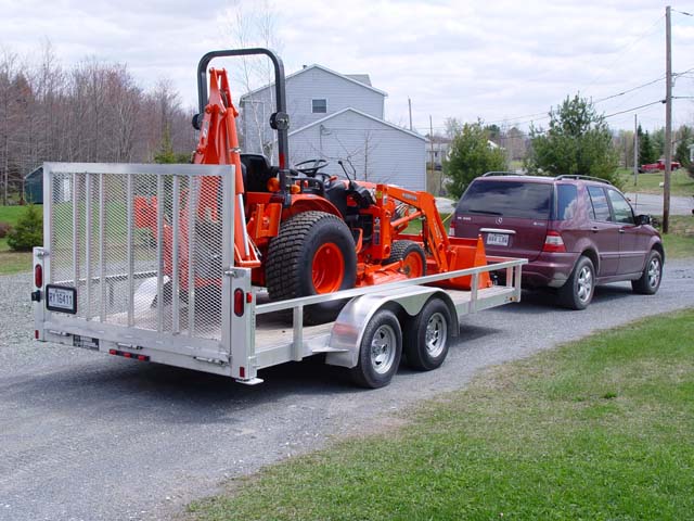

Thanks all for the input. You have reaffirmed my original plan to go with the front snow blower and mid mount mower. I will also get the quick attach for the bucket and pallet forks and a rear blade for grooming and snow plowing small amounts. I will also get the rear ballast box to offset FEL loads.
Now as to those tires...should I internally ballast the turf tires or get chains for traction when snow blowing? Do they even make chains for those bad boys?
And for transporting, I will have either the snow blower or the pallet forks on when I need to take it to my business location so do I get a 77" wide trailer or an 83" wide trailer? I suppose I should make room for the 72" MMM in case I need to transport with it on. And what about the offset between front wheel width and rear wheel width when using loading ramps for the trailer? If the ramps are set close enough for the front wheels will there be enough for the rear wheels?

I have a B3030 with front mount blower which I used this past winter on my gravel driveway, so I can offer a few comments. First, I'd seriously consider getting at least the optional hydraulic chute rotator. I have both hydraulic rotator and hydraulic deflector on mine and they work great.
I wouldn't fill your tires, specially becuase your mowing with it. I'd try and see how your traction is next winter first.
I have the 60" mmm and sometimes wish I had the 72", so going big if you can is a good choice.
I had a rear blade for a while, and honestly I could never really get the hang of it. I do have a box blade now and I like it much better. The sides of the box run along the ground which helps stop the gouging. To each is own, some guys like a blade, others a box, but for me - it's box only.
I was going to order a rear ballast box and I'm glad I didn't. I find that the box blade makes for a nice rear ballast - why not have a functional item attached rather than a designated ballast box?
