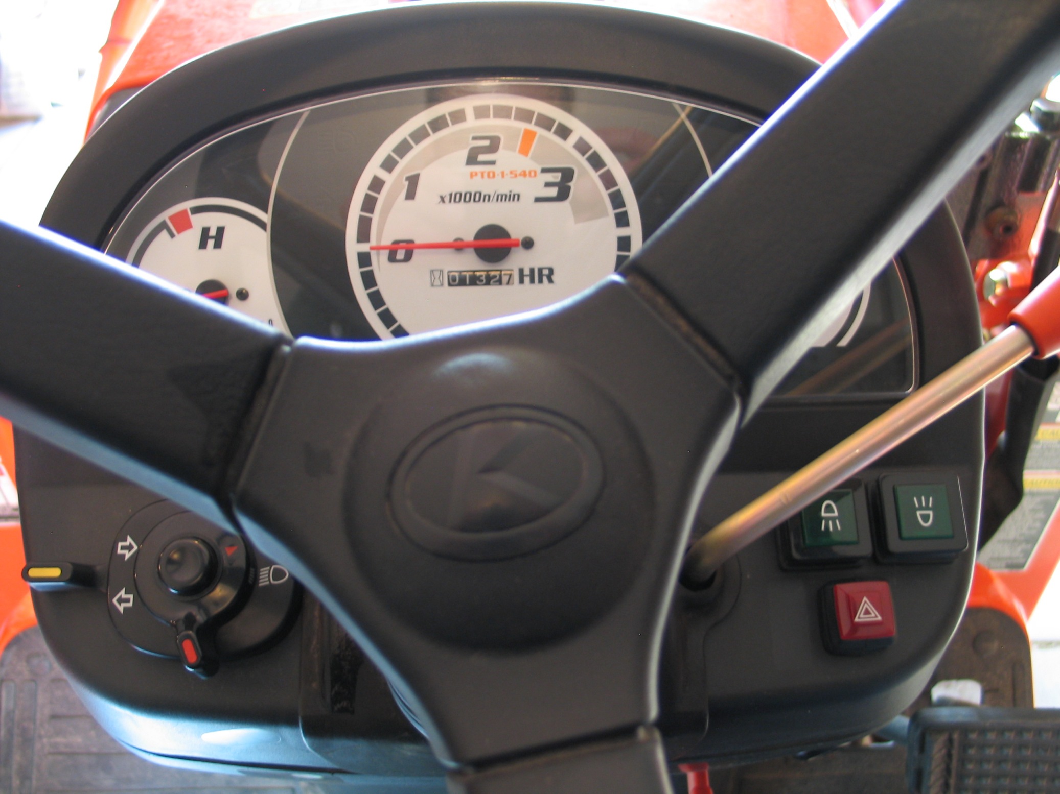

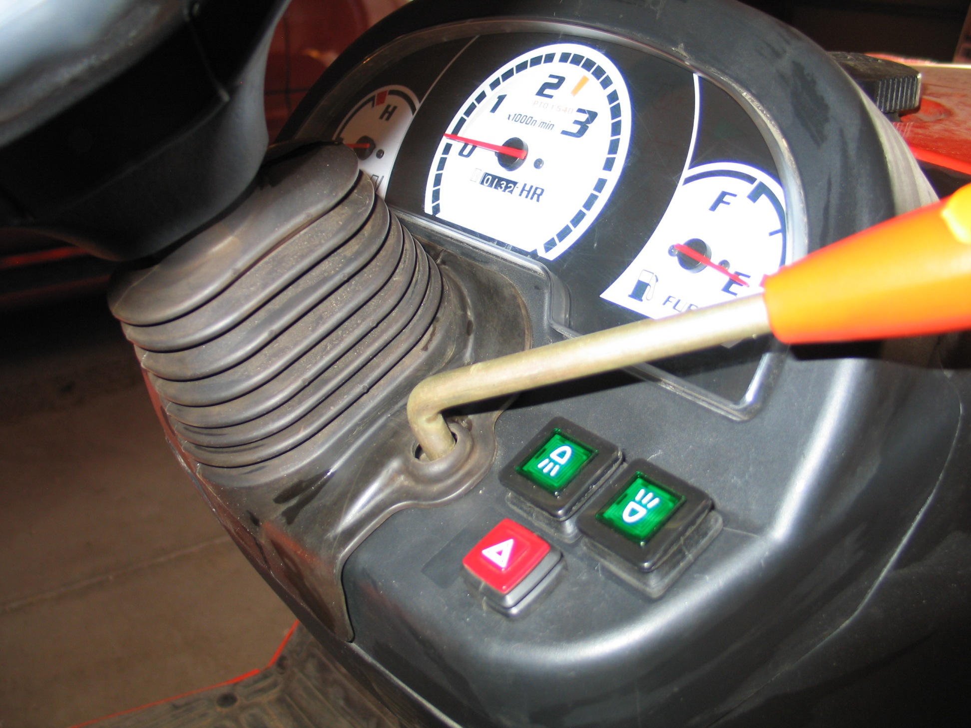

QUESTION #1: Your factory light switches are very tidy. Can I get the Kubota part # from you?
Regarding your fender mount joystick, I had the same set up on my B3030 but wanted the stick to as the Brits say "fall easily to hand".

I've seen your link to your relocated joystick, but the location I have mine at now seems to be comfortable enough that I don't have plans to move it again. I think if I were to move it a little closer in, it would end up in my way more often than not.
