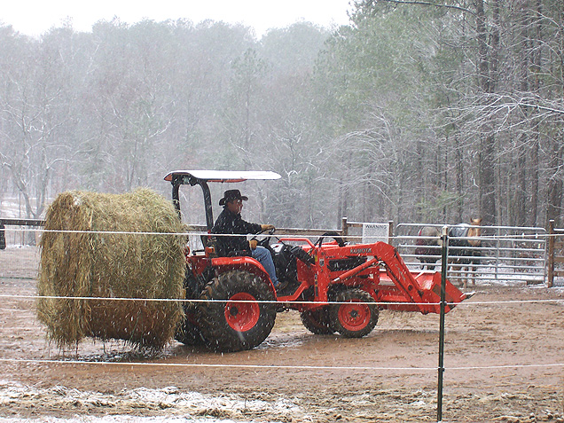

First, congrats on the property! Nice looking place. Thought I'd add my .02 on the hay thing. I have a pretty small place by comparison (10 ac.), with a lot of tight spots I often need to get the tractor into. I have a B7800 which is very similar to the B3030 in size and weight. For me, the big B series tractors are the perfect size and a great balance of power and manuverability. I also was concerned about my lawn, but if I'm careful and don't use 4WD when on the lawn, I can usally keep the R4's from doing any damage. That said, I also need to move hay rounds around to feed our horses. I have found that with a rear mounted spear and some care I have no problems moving rounds up to 900 lbs. in size. Now while it's true I can do it, if I had a bigger place where size wasn't such an issue, I would have bought larger. The more weight to counter balance the bale, the better, and if you jump to the 3940 you could probley even use a spear on your FEL and be able to stack the bales. If you're moving hay only occasionally, working on smooth ground and only traveling a short distance, the B3030 will work great. Other than that, I'd go bigger.
