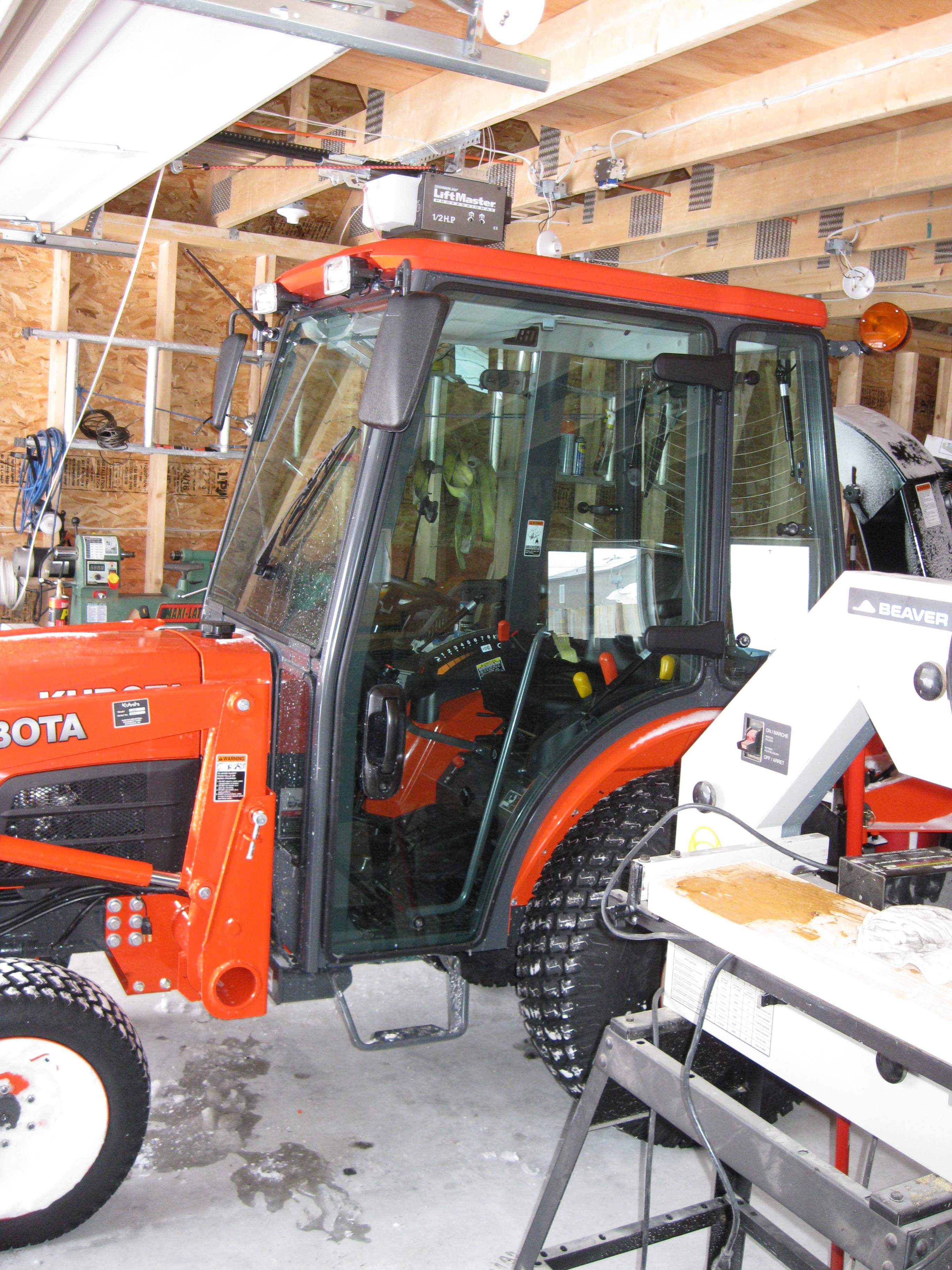

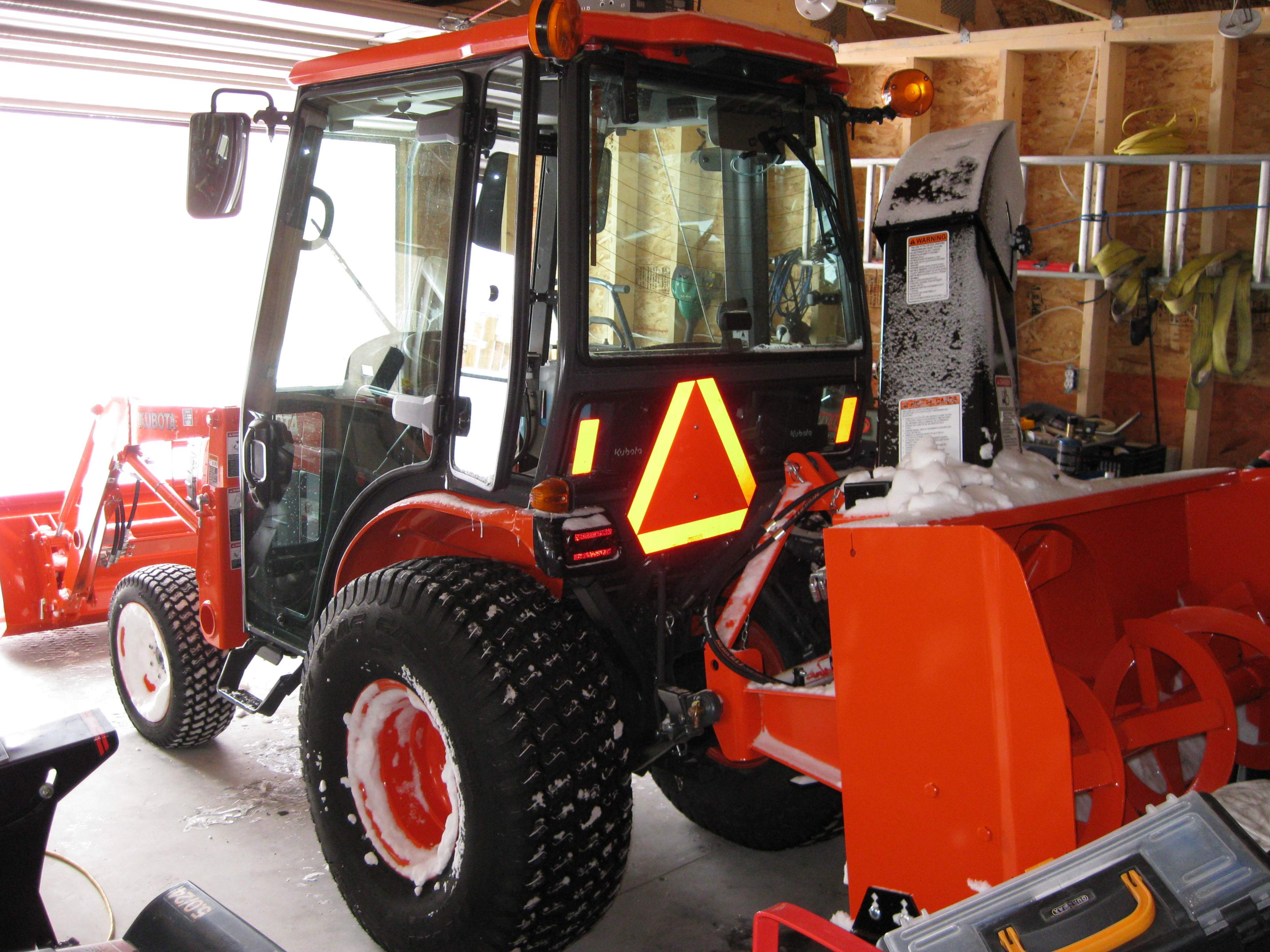

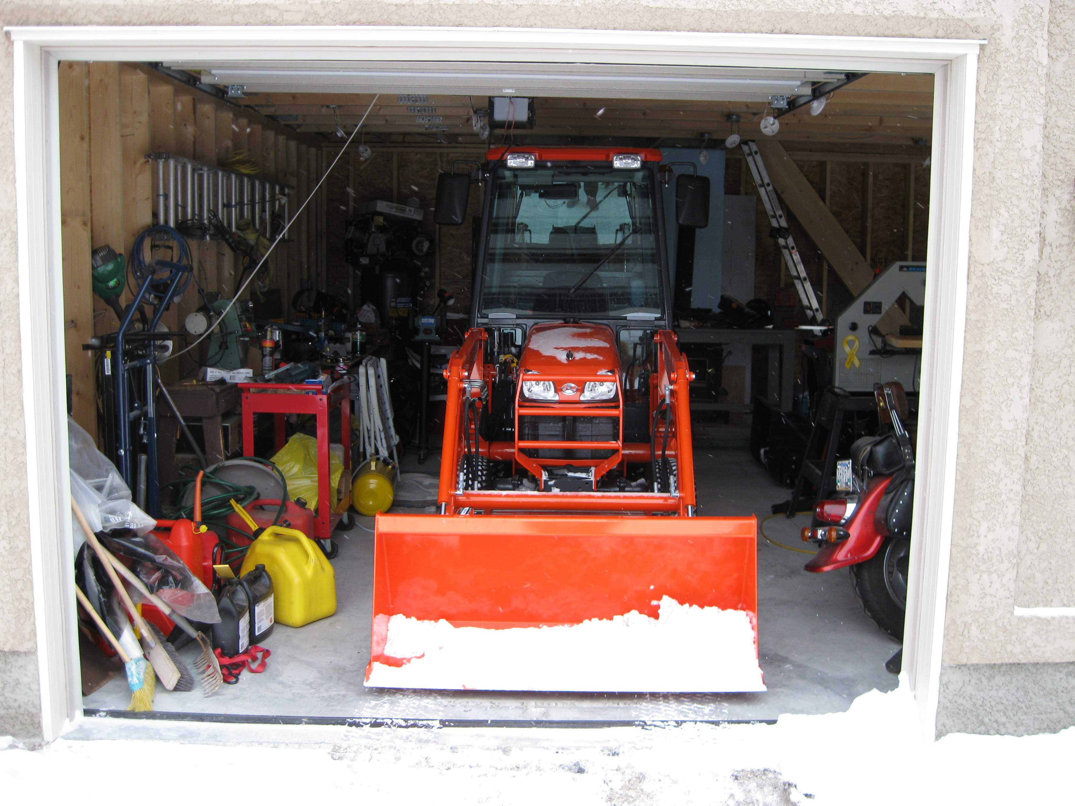

You'll love your new machine. Just got mine yesterday. Been concerned about it not fitting in the shop. Shop door is standard 7 footer. Measured my machine twice at the dealer (turfs are on it) and contrary to the dimensions on the Kubota Canada site, it's a good bit lower at the cab line.
R4's are standard I guess, and no doubt taller.
Took measurements again today, and convinced myself to try. Rolled the door all the back so the edge was above the 7' mark, and made sure nothing was going to hit the cab. Rotated the amber lights downward somewhat as well as the antenna. AND IT FITS. A good inch clearance.
You don't enter fast, and you make sure the snow and ice are gone, but it fits...:D

   / b3030 w/factory cab #19
I drive mine in front first. That way I can start blowing snow right at the garage entrance with the rear blower. No packing down snow with the tractor before I engage the snow blower.
