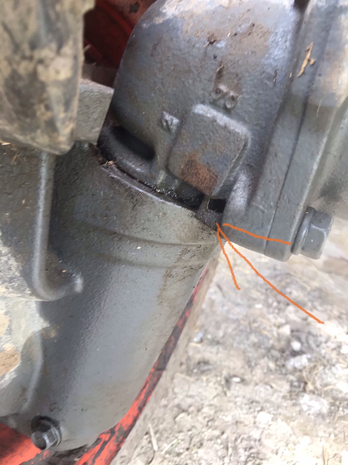

Noticed this today, looks like it has been leaking for a while.
Seems to be leaking at the joint here (arrow)
Is this a DIY fix? I’m fairly handy.
   / B3200 axle pivot leak #2
There's a seal in there. It may be leaking because of normal wear or because it's worn from loose bearings or bushings.
Your shop manual should say how to disassemble and reassemble it
   / B3200 axle pivot leak #3
Yes it is a DIY fix plenty of threads on TBN about fixing it......
Guess I’ll have to get a WSM and search youtube.
*edit*
Found a tube video of the same repair on a BX that looks pretty much identical to a B series in design.
