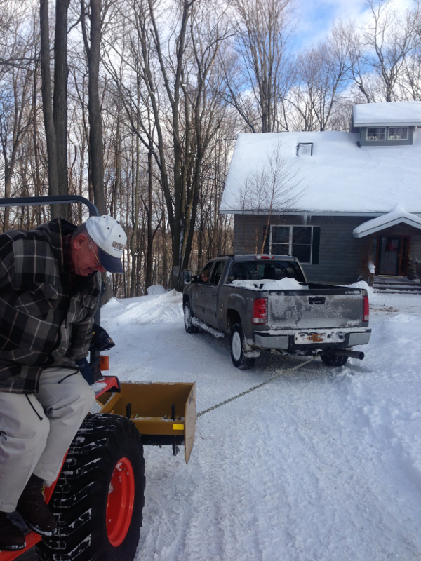

   / B3200 implement size advice #5
I pull a SQ 160 BushHog twin blade rotary (5') with a slip clutch, and a BushHog SBX 72 (6') box blade wit my B3200 this far without any problems. This past week I had to tow out my Sierra 2500 from a snow covered hillside with a 20-30 degree grade. I used 20' chain off the drawbar in 4 wheel drive with the truck in gear idling as I pulled. I had my box blade on the 3 pt for additional weight on my loaded R4's and in low gear I was able to extricate the truck from 1' deep snow on grass ( trucks road tires barely kept the truck from sliding down the hill further with all wheels locked up!). Yea, I think the B3200 is a capable machine and handles the equipt. As above pretty well!
The photo is the end naturally after retrieving the truck from down the hill to the left of the house!
