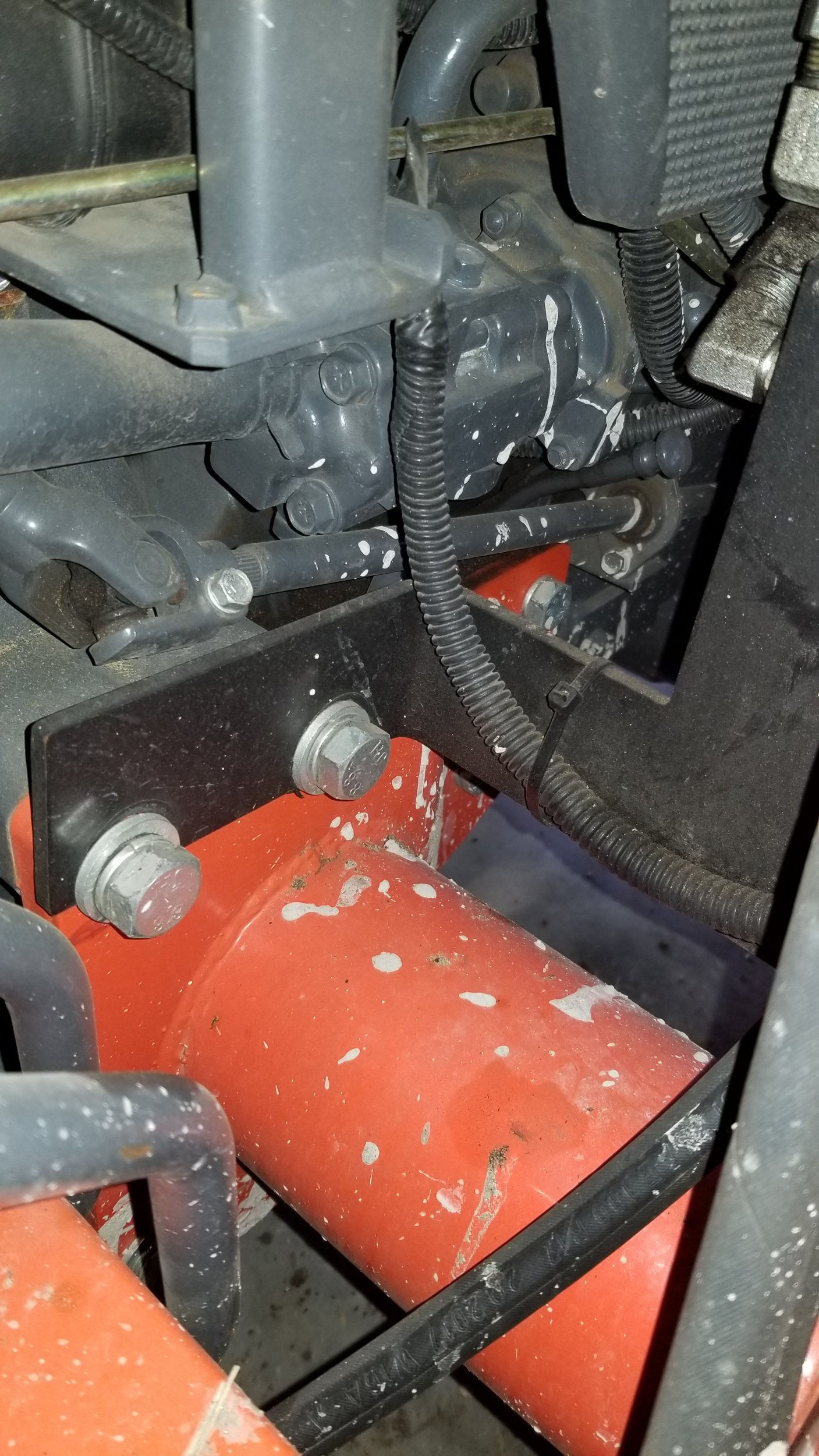

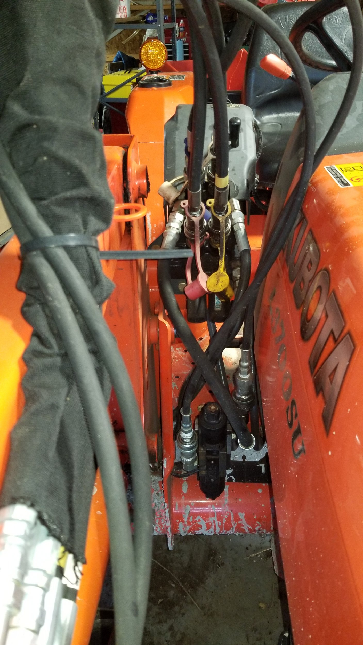

I have a Kubota B3200 with LA504 loader. I want to install a custom 3rd function valve for a grapple. I do not see any obvious convenient place to mount the valve. The B3200 has the loader joystick at the side of the seat and under the fender rather than up next to the instrument cluster. This makes it so that there are no places to mount a bracket for the new valve.
I am wondering what others have done or seen done to mount a 3rd function valve to a B3200? How does Kubota do it, I assume they sell a valve kit add on?

I have a B3200 with the WR long 4 in 1 . WR Long is the way to go.

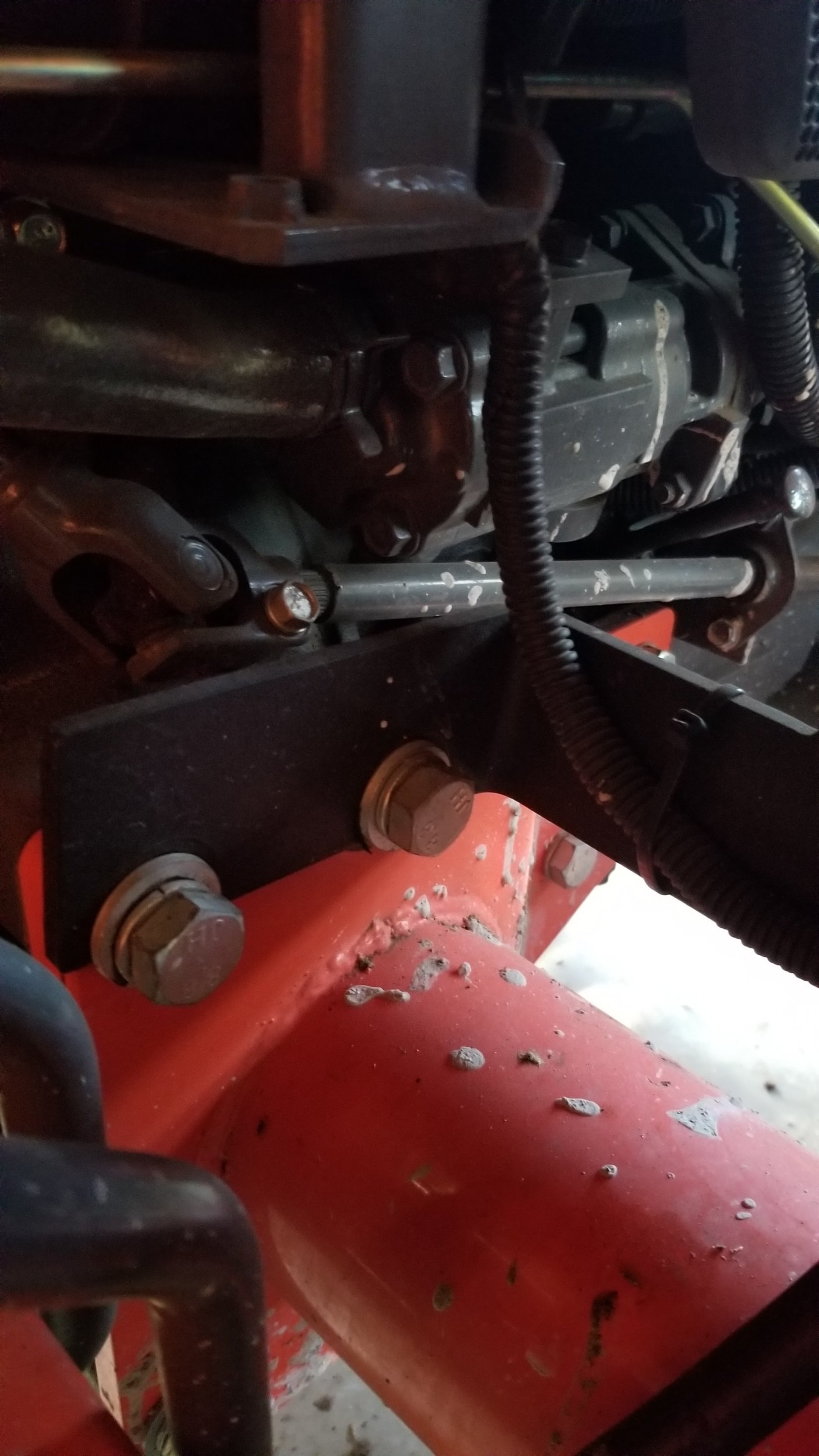

I know this post is old, but do you have pictures of how the valve is mounted to the loader?
   / B3200 where to install 3rd function valve. #7
Here is how my third function valve is mounted to my L 3700. It sits on an L-shaped bracket that has two large bolts that bolt directly to the loader subframe.

The photos are in reverse order unfortunately. However, they show the entire layout of the third function system and the grapple itself. The valve is from WR Long so is the switch and fittings. I think the grapple is also WR Long, it all came as a package.
