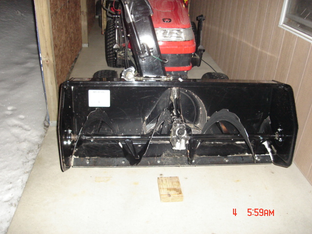

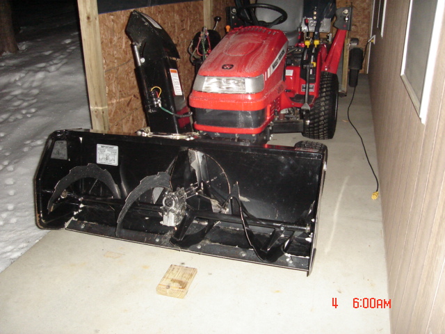

I'll go along with Farmall45B-- We had about 4" of grainy, sugar-like snow followed by 2" of rain a few weeks ago- talk about slush!
I had my doubts, but the blower on my GC2310, which I'm pretty sure is identical to the Bota blower, did surprisingly well. Throw distance was reduced, but still went about 25-35 feet. I was very happy, as I didn't want to deal with frozen ruts either! I just went slowly and kept the RPMs up.
