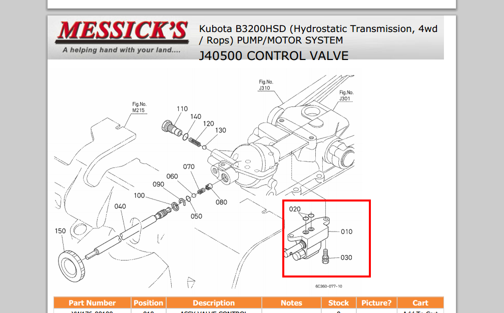

   / B3300su Hydraulic Pressure Relief #12
OK. I should learn to check the book first.:banghead:The B's are different from the L's. There is a relief for the 3pt that is adjustable. It is part of the 3pt valve and factory specs are 1960-2070 psi which is lower than the rest of the system. It is a bit involved checking the pressure as it requires a special fitting. Unless you suspect the 3pt to be low I would leave it alone.

You are correct, the loader valve is the only relief for the system. It is also the PBP for any other add on's and also supplies pressure oil to the 3pt.
   / B3300su Hydraulic Pressure Relief #20
