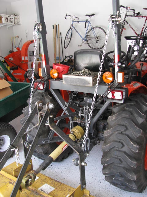

RE: 1/4"-ing: I could not get 3-Pt to hold King Kutter 48" rotary mower ("bush hog") at precisely the level I wanted. Ran limit chains from ROPS support bracket down to front of mower, solving that problem. If you search TITLES, "ROTARY MOWER LIMIT CHAINS" my post will come up. Now mower maintains exact height I want, easily adjustable by moving chain in grab hooks link-by-link.

I have 5/16" Ken's Bolt On Bucket Hooks in line with the FEL arms. I use chains in conjunction with these grab hooks every time the tractor is worked. See link:

Your experience with the 1/4" valve and your 48" rotary mower is what I have read from others. I don't know how comfortable I will be resetting the height of an attachment each time I use it and especially having it "sag" while being used and needing to be adjusted. The height chains are a good fix but a little bothersome. I noticed by your photo that it looks like your toplink is connected lower on the mower bracket. Can it be pinned higher on the mower connection for the toplink? If so, that may be a parial reason for your mower dropping (more strain on lift arms to maintain height?). Just a thought.

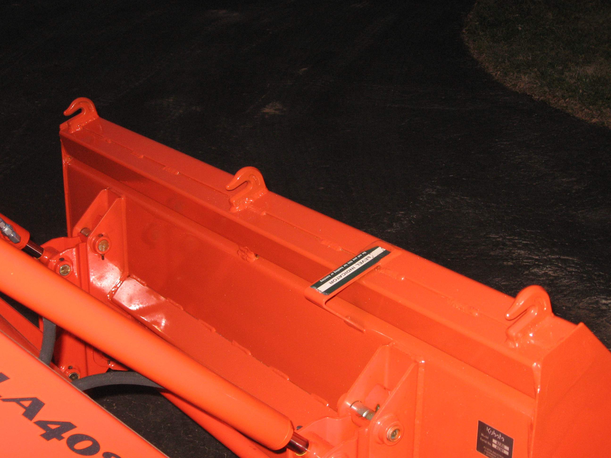

Here is picture of my B3030 (which I love) with reinforced top lip on bucket and three weld-on hooks.B3030 hooks.jpg

That's a great looking setup. Did you weld a piece os square stock under the lip and then weld the hooks? If so, it would be stronger than my suggestion. Great idea and looks good also. I guess a person could find someone that can weld and end up with a much more stable and reliable finished product. Thanks for the idea.
   / B3300SU #8
My dealer welded the square stock and the hooks as part of our buyers agreement and it has worked very good. I allso have the quick-attach bucket (pins) and have had no problems. The skid steer type would be great (more attachment selections) but adds a lot of weight which drops capacity of front loader

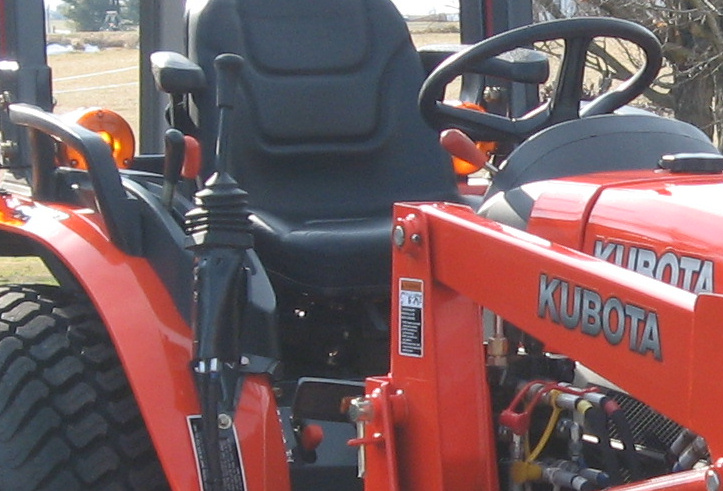

I also opted for the remote joystick for my fel, it is what is standard with the cab model. It is easier to use and not as distracting as the standard sticking up at the side of the steering console.joystick.jpg
