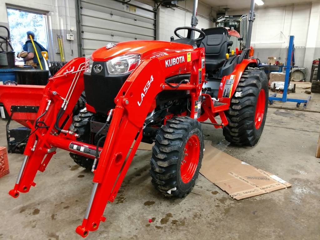

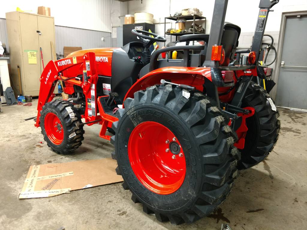

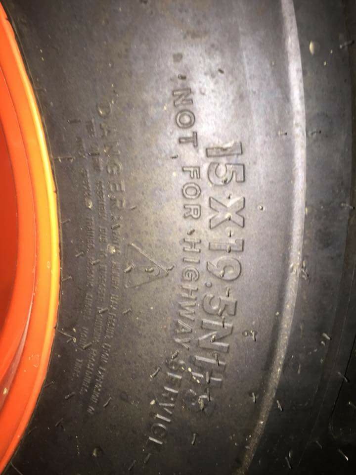

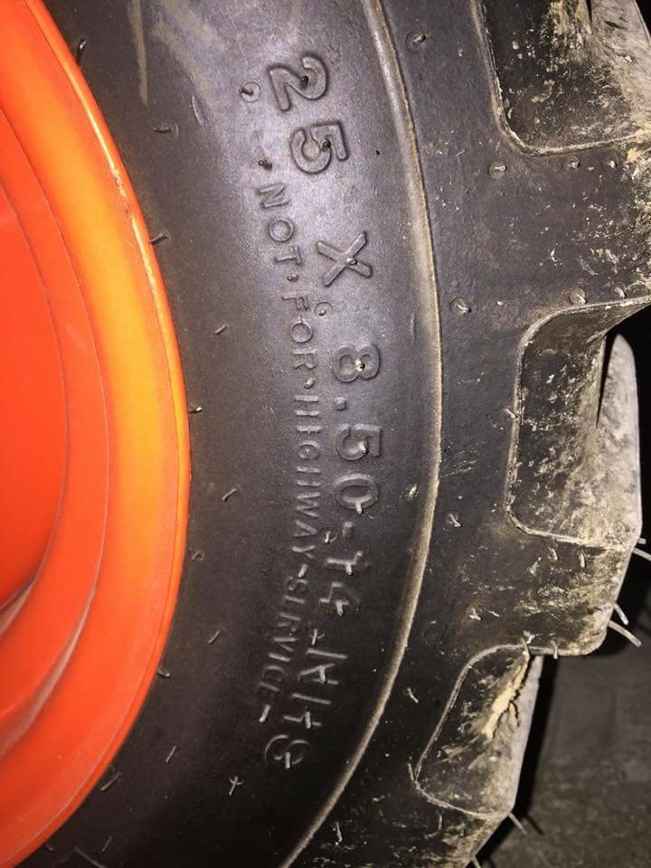

Correct. The standard B3350 and the B2650 have all the same tire and wheel sizes.
The B3350SU has the option for the larger wheels and tires. They will also fit the B2650, but you can not use the mid mounted mower with them because the larger 41" tall tire is trying to occupy the same physical space as the deck wheels. You would have to plasma off the deck wheel brackets and move them with custom made brackets if you were so inclined.
The standard tire is right around 37" tall and the larger SU tire is around 40" tall.
You give up around 7% of the gearing torque multiplication from the increased tire size.
