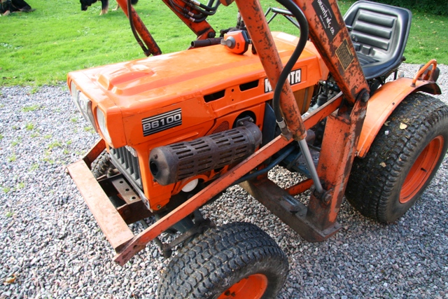

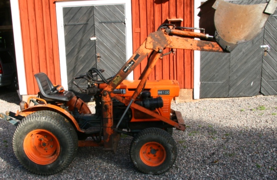

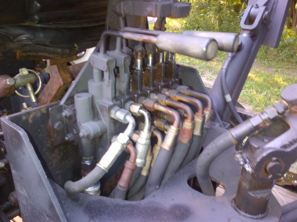

Some pics of my B6100 with a Brantly SL 500 FEL.
The hydraul FEL runs of the "ordinary" hyd pump.

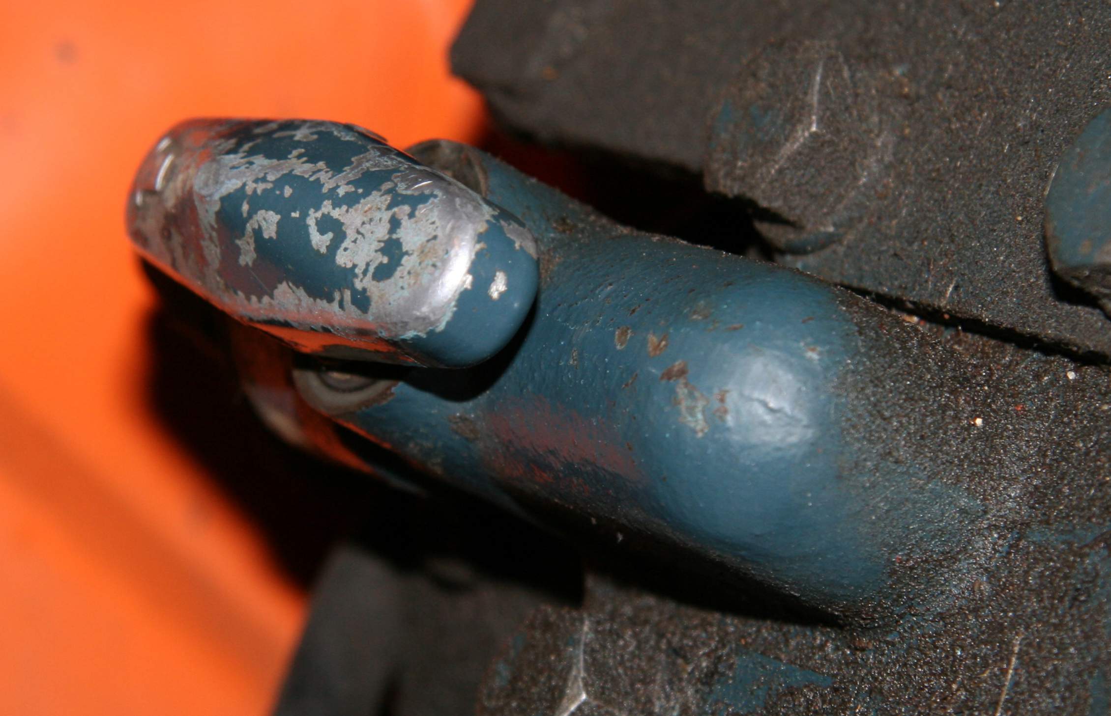

Switching between 3pt and FEL is done by the diverter vent. That is my headache today since there is a leak inside the vent. This makes the 3PT to slowly sink during ordinary operation. I guess I have to disassemble the vent and swap O-rings...

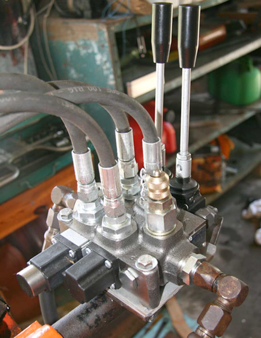

I finally got this loader project all done, got some new tubing with fittings made, and received all new hyd hoses so now its all together.
Fired it up today, fully expecting all four hyd cylinders to leak like a sieve, since they've been sitting for like 20 years outside. But, lo and behold, they did not leak, but I could initially only get the bucket to curl, couldn't raise the loader up at all. So as I mentioned originally, I am using this old AICO two spool control valve, and I think its trashed.
It will now raise up and curl, but it does so slowly, and jerkily, and there is a bunch of "sponginess" or "give" to both the curl and raise/lower movements. In other words, when I raise up the bucket, and put my weight on it and bounce, I see the cylinder rods move in and out a couple inches......almost like there is air in the cylinders. I imagine this all relates back to the old junk AICO valve. SO, I am going to order a new two spool valve, this one looks good to me: https://www.surpluscenter.com/item.asp?item=9-8283&catname=hydraulic
Hopefully that will get this thing working like it should. Otherwise it turned out pretty good I think, should be a useful little beast now! Heres a few photos:

Why not bleed the air out of the cyl by operating the valves fully about 5 times.
If the pump does not have any suction leaks, the air should be gone and things should operate.
Install a hyd gage in the IN port of the FEL valve and check and set the FEL valve relief.
If you are going to order another valve, this valve will serve you better, and it has float and regen.
Surplus Center - 2 SPOOL COMPACT 10 GPM JOYSTICK CONTROL VALVE
Sure it is more money, but will do more, and it is joystick controlled.

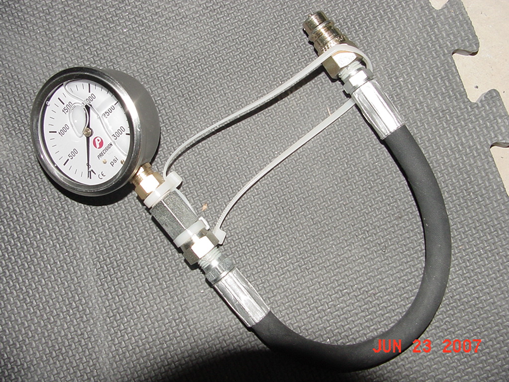

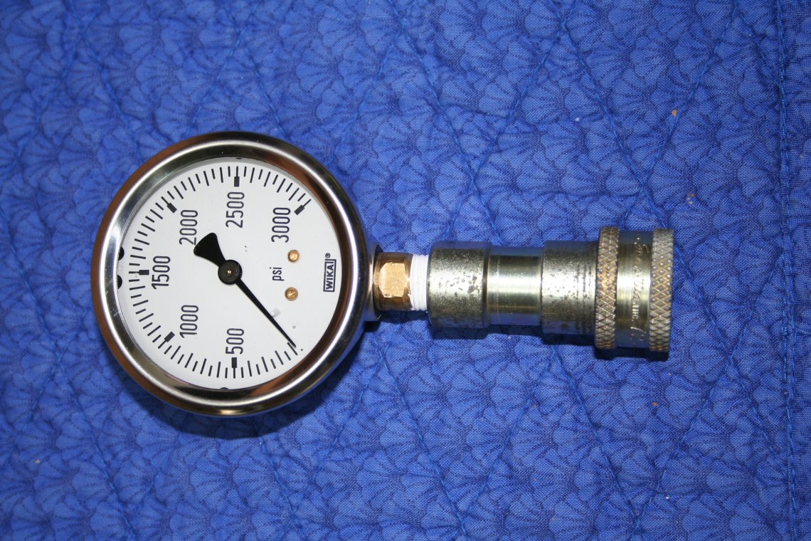

Ah ha. Well those actually do sound like useful functions. I'll have to see about getting a gauge set up....I have a couple gauges around, what pressure range gauge would I need?

A 3000 psi hyd gage set, something like this.
