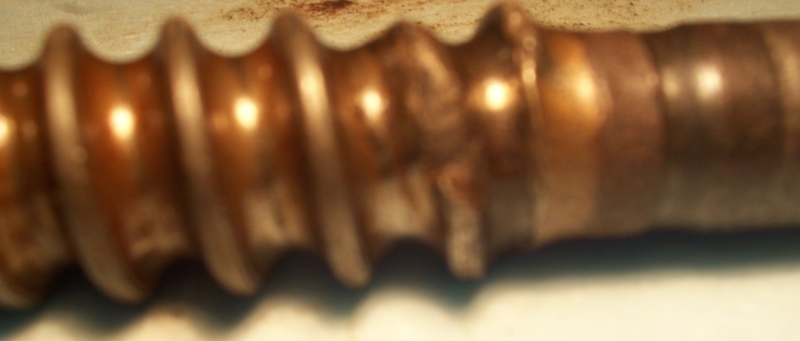

Does it 'stick' or 'pop' at all? if so the thrust bearings in the steering box may be shot. Had this problem with my b7100. Change the fluid and take a look at it. Unfortunately for me the junk from the bad bearings nicked the steering shaft worm gear and even after changing the thrust bearings it eventually self destructed. I had to replace the whole shaft and steering block (comes as a unit) for $150+ in parts. I think the bearings were about $6 each... might want to tear into it anyway and see if they need replaced.... fairly easy to do and could save you some $$$ in the long run. Not too mention I had a **** of a time getting the new steering shaft. Supposedly a mix up with Kubota changing to new part numbers but I am not so sure they are not phasing out b7100 parts.

As others mentioned.. some play can be removed with the sector adjustment stud.
If the steering wheel rises and falls when steering lock to lock, then a thrust bearing is gone...

Just like many others, I lost my steering on my B6100 today moving some snow. Thanks to this thread I knew what to look for.
Looks like both the thrust bearings are shot and I have some damage to the worm gear. I wanted to post a picture of the worm gear to get some opinions on whether it needs replaced or could be repaired?
Pictures 1 & 2- Steering shaft showing the damaged worm gear. Any chance it will be salvagable?
Picture 3- Bottom of steering post. I see a damaged oil seal (maybe part #09500-16287). Is that a sleave on top of it that comes out?
Oh yeah, my steering box was pretty darn dry as well. Thanks again to all.
