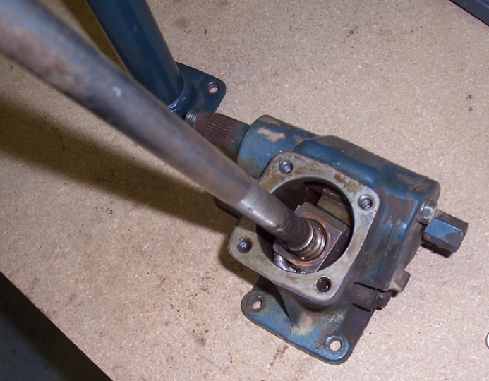

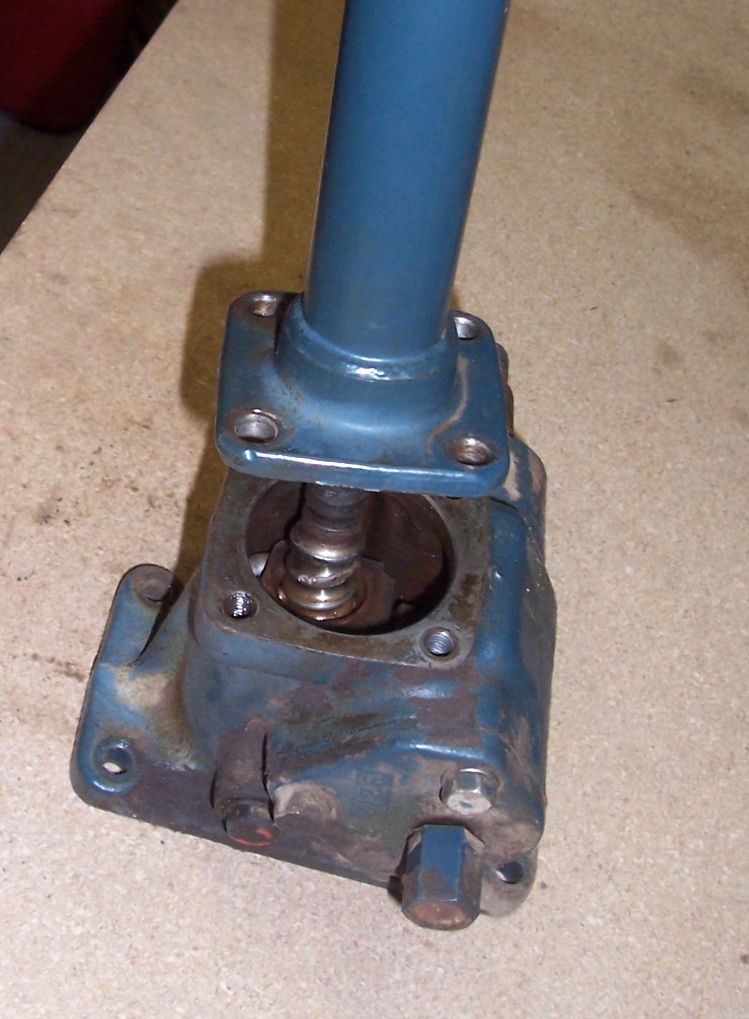

Just like many others, I lost my steering on my B6100 today moving some snow. Thanks to this thread I knew what to look for.
Looks like both the thrust bearings are shot and I have some damage to the worm gear. I wanted to post a picture of the worm gear to get some opinions on whether it needs replaced or could be repaired?
Pictures 1 & 2- Steering shaft showing the damaged worm gear. Any chance it will be salvagable?
I would say no based on my experience... mine only had a small nick to start. How do the bearing races look? Mine were slightly damaged at the ends where they insert into the block. It didn't take long for everything to get much worse. I think the bearing races let a bearing by and the worm gear really got trashed. I got a new shaft, block and bearings etc. as one unit from the dealer. I did see somewhere on the internet where you could buy just the bearings and races but I can't find it now.

Picture 3- Bottom of steering post. I see a damaged oil seal (maybe part #09500-16287). Is that a sleave on top of it that comes out?
If I remember right, the piece the bearing presses against is pressed in. I think I used my slide hammer with a hook or L in the end and it popped right out.

I'd guess on repacement of the worm drive shaft. :(
Check with the dealer service manager.:D

Charlz- The races look pretty good. Not sure if all, but most bearings were still in the race when I pulled it apart. Anyone have an idea of how many bearings are in there to start?
I thinking I may just order 2 sets of thrust bearings and use the first set to put it back using the original shaft to see how long it goes. I think I will also then go ahead and buy a new assembly now as I really don't know how long these parts will be available.

I have been thinking about this all day. Going to go ahead and getting a new assembly and when it goes, I will do the power steering. Thanks all.

myyaz33: thanks for posting these pictures. I'd only seen the line drawings in the manual up 'til now, and didn't really know what was going on in there.
So, care to share the details of where you found the $135 deal? What comes in that assembly exactly? It sounds like it would have to be everything between the steering wheel and the pitman arm.

Here are a couple more pictures of the steering system.
Now that I have my order placed, I can safely share where I got it from. (Sorry for my selfishness) Sam's Tractor. Here is the link Kubota
