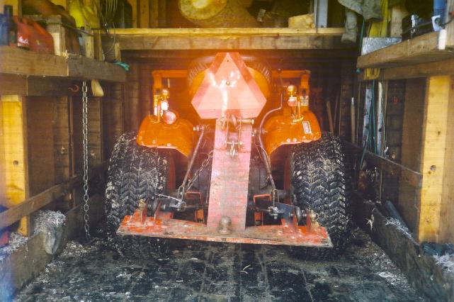

As to the trailer hitch I'll attach a picture of one that was built for my B7100. It worked well for me and may give some ideas on what would work for you.:D

"Egon" That hitch looks perfect I've been searching for something like this.
It looks like you can lift a log and still use the ball while there is some protection to the tires and pto.
Questions:
Did you consider adding a triangle as a brace instead of a T?
Does the ball get in the way when lifting logs or whatever?
Is a regular draw bar incorporated into the the horizontal at the bottom.
Does the shelf created on the horizontal help when lifting.
Is there anything that you would add like say extend the top lift 3 or 4 inches to assist in clearance.
Can I take this design directly to my welder to make one for me.
Thanks again this is great.

Mld:
There is bracing on the side you cant see.
The Ball does not get in the way.
There is a regular drawbar in the bottom location on the tractor. I never used it.
One can slide the shelf under items to lift. They may fall off when going ahead. It comes in handy doing this to lift a log so a chain can be placed under it.
What you see is an idea made from materials at hand. { Free }
When one is made for the new old John Deere I'd have a tendency to use more tubing and have three receivers for trailer hitches welded on. Also there would be chain hooks welded on.
The picture may give you an some points to ponder if you design your own. There are limitless method's of putting such an attachment together for your own personal use.:D:D

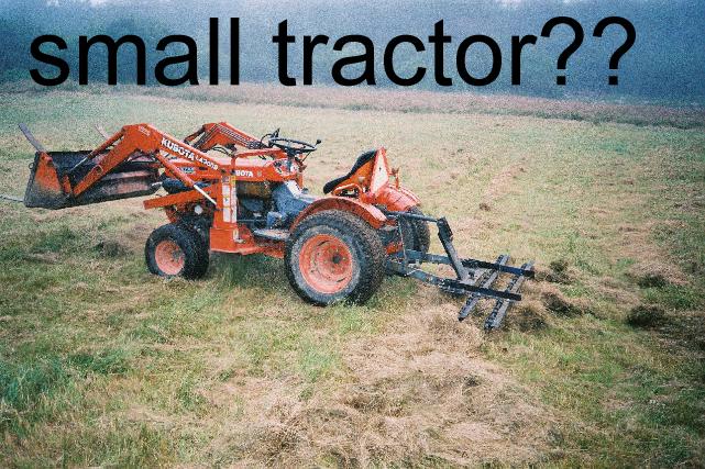

The attached picture shows a sorta home built rake - harrow that I use for seeding or the very odd time raking up mowed grass clippings.:D

the stock drawbar is rigidly attached, so if you want this hitch/shelf to raise and lower you don't want it attached to that draw bar. wonder what would break first!?
if you're looking for other uses of the shelf and think the ball may get in the way, just have the fabricator allow the ball to be bolted on and off. then you'll always have the option to remove it later if needed.
