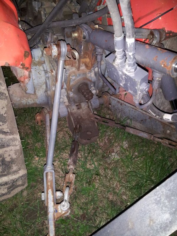

Check out this diagram.
http://www.tractorbynet.com/forums/...076621-b7100-3-point-hitch-402999-3point1.jpg
In your first pic, the assemblies at the bottom are in the correct sequence.
Left lift arm (needs to be flipped over)
Top link.
Right lift arm.
There should be a shaft that becomes the lower attachment point on the tractor. #34in the diagram.
It threads through; lift arm, tractor, check chain, check chain, tractor, lift arm. (hope that made sense)
#24 in the diagram is the check chain attachment. Yours seems to be a two piece assembly each piece already on the check chain. Check chains are oriented towards the center on my B7100.

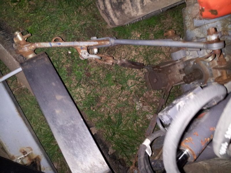

Ok. Been out tinkering with it. I think I have it 90% complete. I know I don't have any pins in the end of the bar yet, I need to buy some new cotter pins and bolts for the rear end, It's leaking fluid out of the bolt holes since I removed the backhoe brackets. Man, what a pain to switch between the backhoe and the 3 point. I had no idea it was going to be this much work. Oh well, I think I'm almost done
BTW the 3 point lifts and drops perfectly now!! All I needed to do was loosen the colored bolt a little and now the 3 point goes up and down perfectly. Here are the pics, ( on the last pic I have used my legs to spread the bars as far out as they can go ) 20130604_010125.jpg20130604_010142.jpg20130604_010156.jpg
