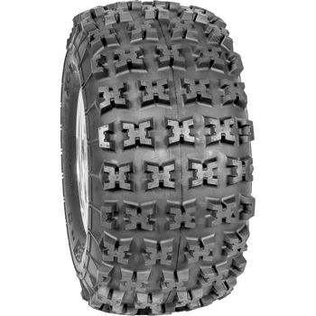

I found these at Costco.com:
Greenball XC-Master Rear 6-Ply ATV Tire
I sure would love the grip, but they are wider than those I have now.
Decisions, decisions.
Edit: looks like the weight load is pathetic, only 300 pounds, not enough for tractor even I dont have front loader.
