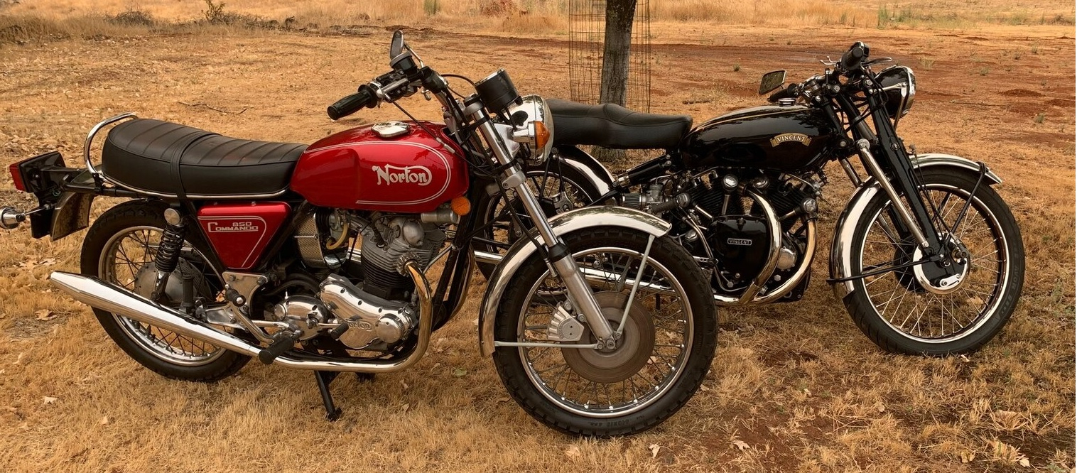

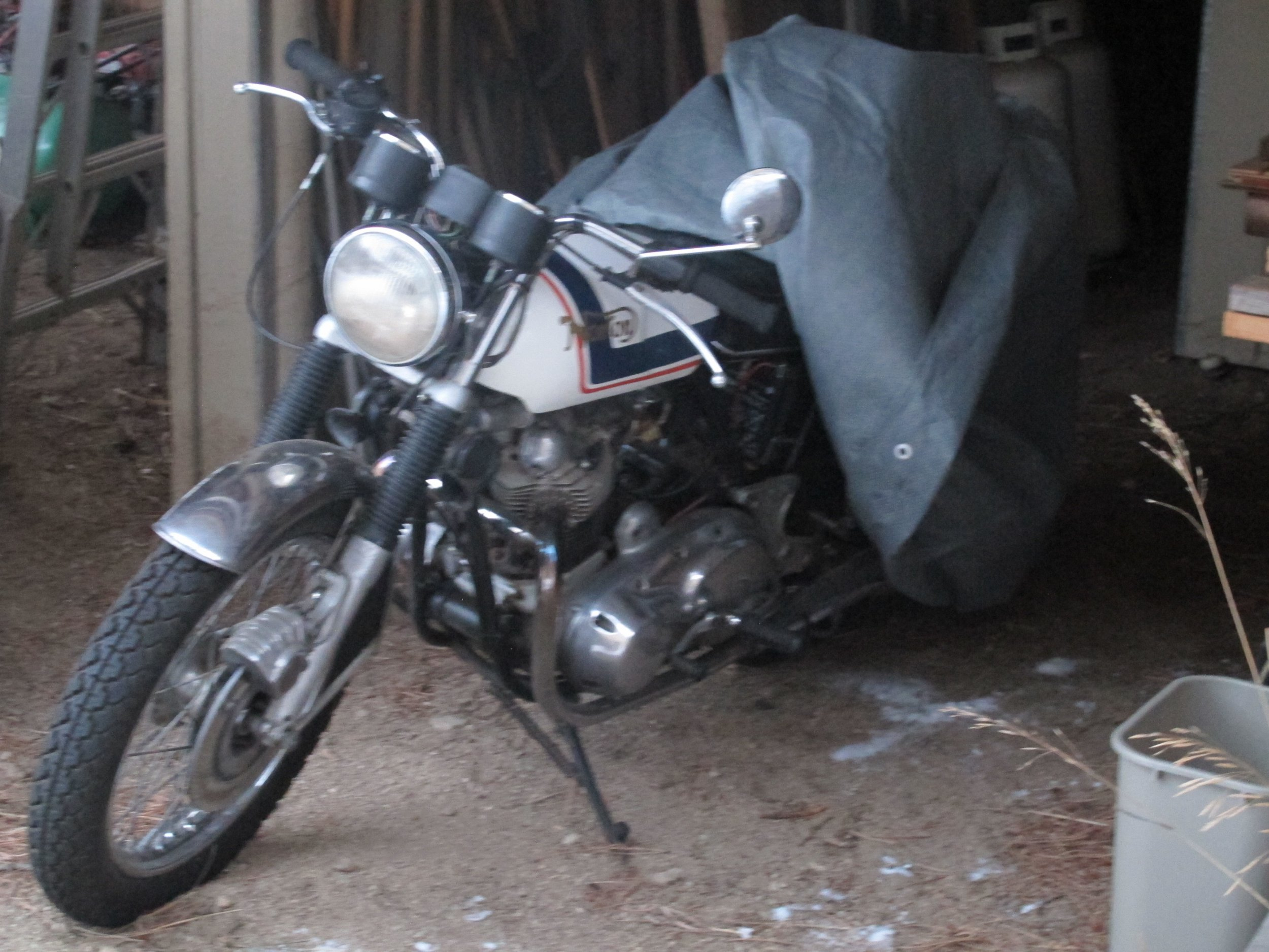

Full-size photo of my toys. I had a 750 Commando in the 90's and regrettably sold it. Found this 850 in 2018. I've had the Vincent for 43 years.

Good grief.... a Vincent. Astounding. From before my time, I'm afraid. I've never even seen but one. No, make that two. A friend stopped by a few years ago to show me his Vincent powered Indian. Maybe the cleanest conversion job I've ever seen.
I probably changed that layshaft bearing on the '76. I seem to recall doing so back in the early 1980s....or was it the ' 70s? Whenever the Norton Owners Club wrote an article about it I think. I've had the bike so long now I forget. Will definitely take a look at the rear brake. Thanks for the warning. Although mine being an 850 ES (electric start & kick start) with the reversed side shifter so may be different.
It is a a blessed bike. with 12K miles and just now finally a few little things needing attention - speedo cable & battery for instance..... But engine & transmission & electrics still as new. Actually everything is....dusty but original. Basically it gets ridden around the local area a few times a year for over 40 years now with only routine maintenance.
Unfortunately I haven't ridden in 2 years now. Getting older....it's time to move on.
