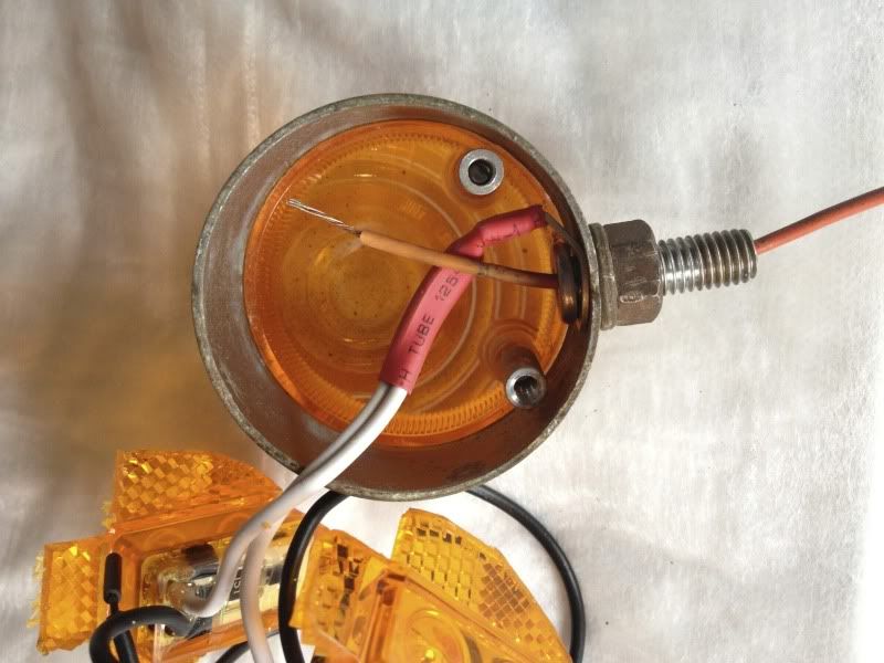

Hi. I was looking to kill some time so decided to change my hazard flashers to LED on my '94 B7100. Why? 'cause I like LEDs - no rational reason behind it. It was a cold winter day and I wanted to spend some money. I think I did it the hard way too. I subsequently found that you can buy some LED bulbs that will fit into the auto sockets and may be good. Oh, and I think the incandescent bulbs are brighter anyway. So with all those things going for it, here is what did:

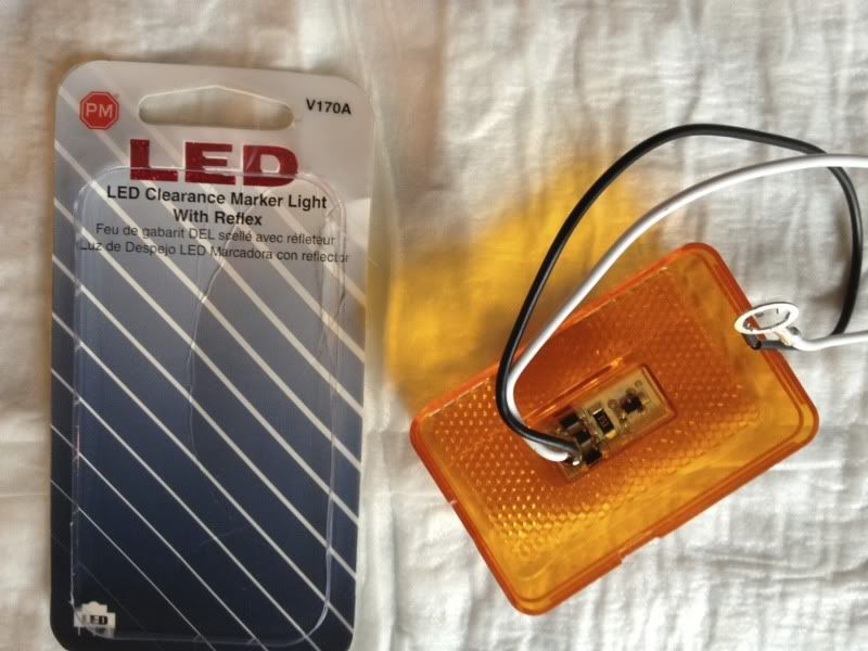

Bought some LED marker lights from Meier:
and then cut them down into this shape to fit the lens:

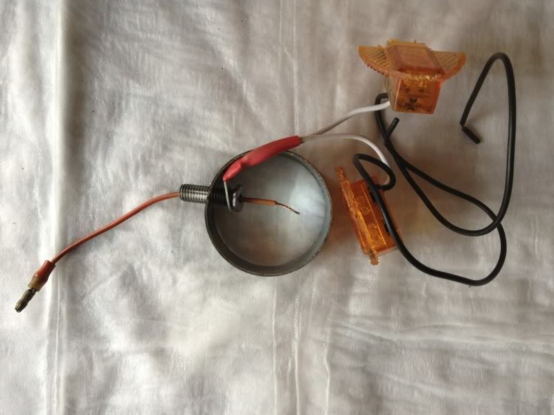

I took the lamp apart:
and then reusing the mounting bolt with the hole in the middle (important part, don't let that one get away..) wired it all together:

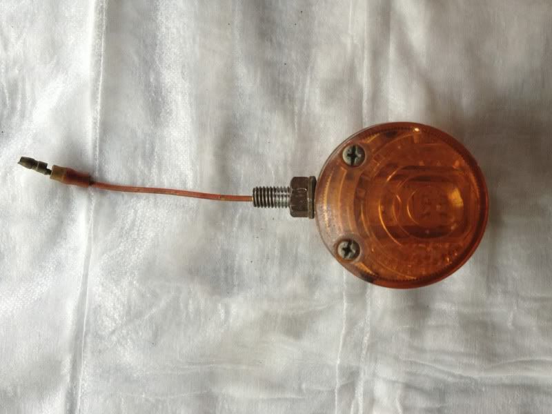

and put it all back together:
It lights up ok, doesn't get hot, and sucks almost zero from the dynamo. Most importantly, I can tuck my thumbs under my armpits, rock back on my heels, and say "yup, did that".
