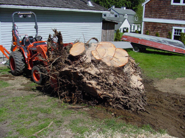

I have the 4692 BH and have really put it to hard use. I have removed some incredibly large stumps with it, but more importantly I find that I am using it all the time for the smaller projects as well. Renting is definately a cheaper option, but then you don't have it to use for the smaller stuff all the time. I'll post a couple of pictures. Hope this helps.

I have removed large choke cherry stumps and medium sized oaks with the loader and a chain. All have been in sand however. I just dig around 3 sides and under the stump. Next I cut large roots by wrapping a chain around them (one at a time) and cut the root by pulling back on the chain. Then I drag the stump free. In sand, I've cut the time down to about 45 minutes per stump.

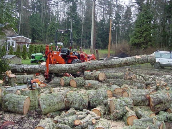

Here's another pic.

Rentals are great for defined projects, but like you, I have a lot of small projects that come and go. Greg also points out that some uses can be surprising...I really like his use for the firewood situation and plan on duplicating it with my own hoe!

I had to rush my post yesterday so I just said a few words and threw some pictures at it. (Had to get to work so I can pay for my tractor). The point that I really wanted to make was how useful a BH is for a lot of smaller job. Here are some examples. Last weekend I planted a 100ft. laurel hedge (about 80 plants). I could have dug each hole by hand (hard clay). Instead I used the BH to dig a trench, filled it with compost and planted all 80 plants in about 2 hours. (Didn't even break a sweat). Without the BH I would still be digging. Earlier that day I moved our invisible fence wire and had to cross our gravel road. I have dug that trench by hand before and it took a long time. 5 minutes with the BH. This weekend I am removing turf around some plantings we have in our front yard. Basically heavy duty weeding. I'll do this with the BH. It is a very simple process to remove turf with the BH.
All of these jobs never crossed my mind when I was buying my tractor. I have found that some of the more delicate or smaller jobs can be done a lot more efficiently with the BH. Loaders are great for the big, move a lot of dirt, jobs, but the BH is way better for smaller finish work type jobs. My point may be summed up by saying that if you don't have it, you don't realize how much you miss it. Now that I have had one, I could really say that when I made my purchase last September, I bought a tractor for my BH. Your property sounds very similar to mine, and a BH is really useful when working in tight quarters in wooded areas.
