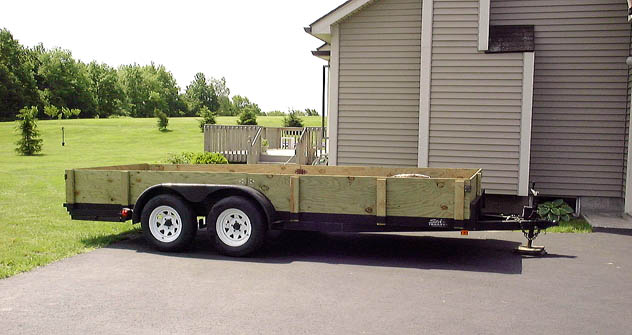

I have a RFM for my B7500 right now but I'm thinking about buying a MMM but I wonder if the tractor will go on a trailer with the MMM attached without dragging?

I don't have my trailer here at the house so I can't measure. But I think its 78" between the fenders. I might be wrong, but its close to that. With a 60" MMM you should have no problems. I like having slide out ramps vs a drop down gate, this allows you to have something hangover the edge if needed. I know when I have my brush hog and loader on the loader hangs over the back edge a few inches, and the tail wheel has to hang off of the front. Plus I made sides that work great when hauling mulch. (I have attached a photo with the sides on) I have heard that the trailers with the side rails that are about a foot tall are not as strong as the flat beds. Plus the rail will get in the way when you need to load or unload something from the side. I hope some of this info helps you out.
