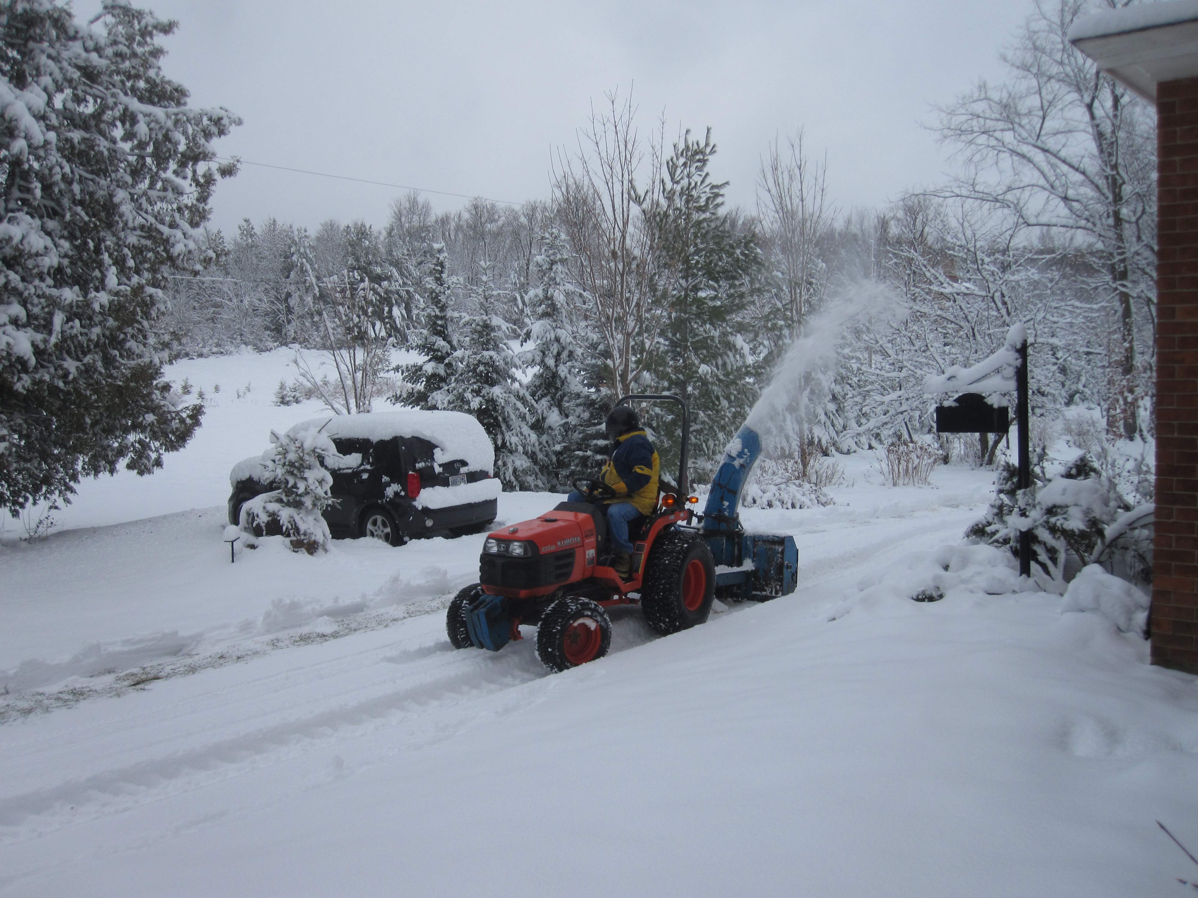

My 2WD tractor could barely move without chains in the 8" of wet snow which fell overnight, so I decided to try the Kubota I had bought privately last June. So far it has outperformed my other tractors on lawn mowing, bush hogging (4') and block splitting, so I decided to try it on the Lucknow 5' snow blower to see if the 4WD would make a difference. The tractor already carries three suitcase weights on the front, left over from the rotary mower.
My 35 hp TAFE has a cab and a good loader. Otherwise there wouldn't be much reason to keep it after I was able to clean the 650' driveway with the B7510. Mind you, I did get wet and it wasn't very cold out.

Yikes Rod, it looks like winter there!
And yes, the little B-series can do surprising things.

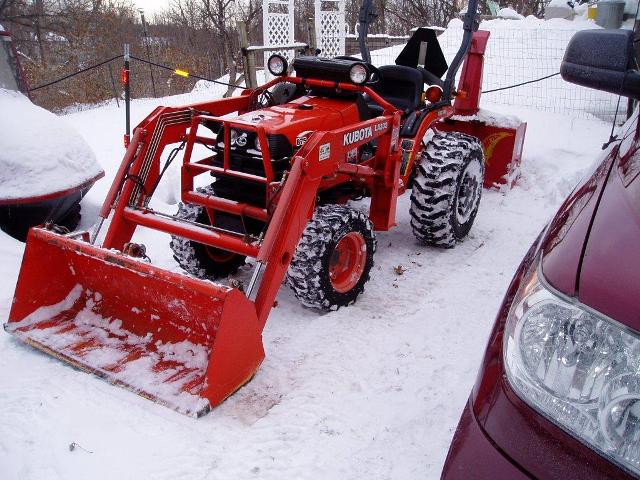

I have used a B7500HST with a 54" blower to clean my driveway for 10 years. It works best when there is a LOT of snow to move.
