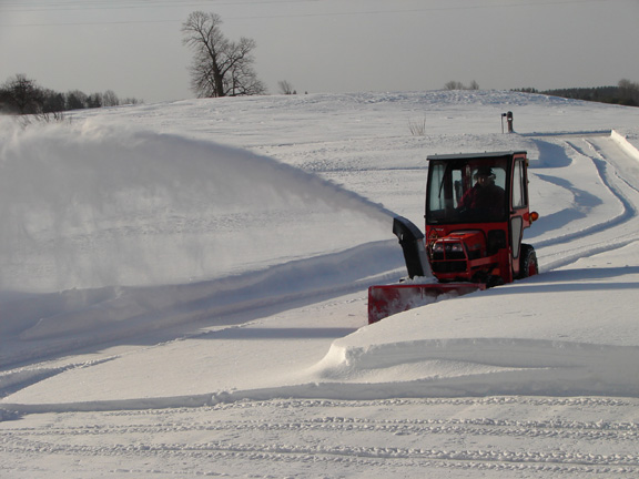

I have the B7610 with the front mount 2781 blower with hydro shute rotator. I also have a Curtis hardside cab with a heater. Now all of this may not be necessary, but if you get a lot of snow it sure is nice. Backing up can be a pain. The cab is so nice when the wind starts blowing the snow around, which is most of the time.
I can take the blower and sub frane off and put the loader on in less that 15 minutes. It seems like every time gets a little easier.
I will try to attach some pictures so you can see what it looks like.

Another picture
Obviously you can't use both the loader and the blower at the same time. This was a pic from the day of delivery.
