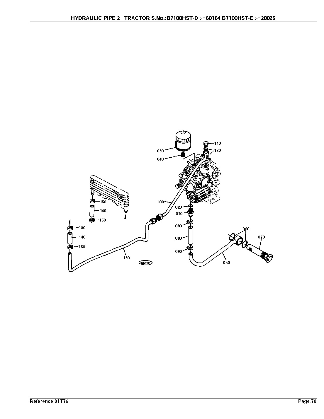

Does it have a metal mesh screen in the side of the gearcase? It would look something like part 070 in the attached pdf or jpeg from a 7100. If so did you give it a clean?

alchemysa: Yes, mine has a similar screen and I checked it at the 50 hr service. it was clean. I did 'rinse' it in a small tray of super UDT (owner's manual said use a non-flammable solvent and I could never figure out what that was:confused: ).
