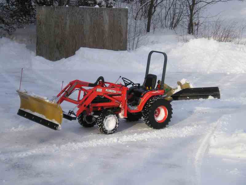

   / b7800 - FEL worth it for snow? #18
This is the rig to go with.
   / b7800 - FEL worth it for snow? #19
That set up is a very bad idea I M O. You hit an unseen obstruction and bend the loader arms, or worse, the loader will never be the same. put a kubota 2019 power angle front blade on the machine ( front subframe) and you will be way better off!
   / b7800 - FEL worth it for snow? #20
- Not sure where you are coming from on "bending loader arms". I am plowing my own driveway, and at walking speed. Using either the front or the rear blade the whole tractor is likely to kick sideways if I hit a bank or obstruction - the entire rig is pretty light.
In my view this is a great set-up - a huge improvement over having just the bucket out front.
- The front blade makes it possible to plow moving forward - a huge improvement over looking back over your shoulder.
- you can use the blade to stack snow, just like a bucket.
- the front blade is heavier than the bucket, so when it is lifted up you have much better traction for using the rear blade.
- I haven't used the Kubota front blade, so I can't comment on it. I did not like the idea of having to change over the entire rig each season.
At any rate - I love my set-up and am not worried about bending my loader.
