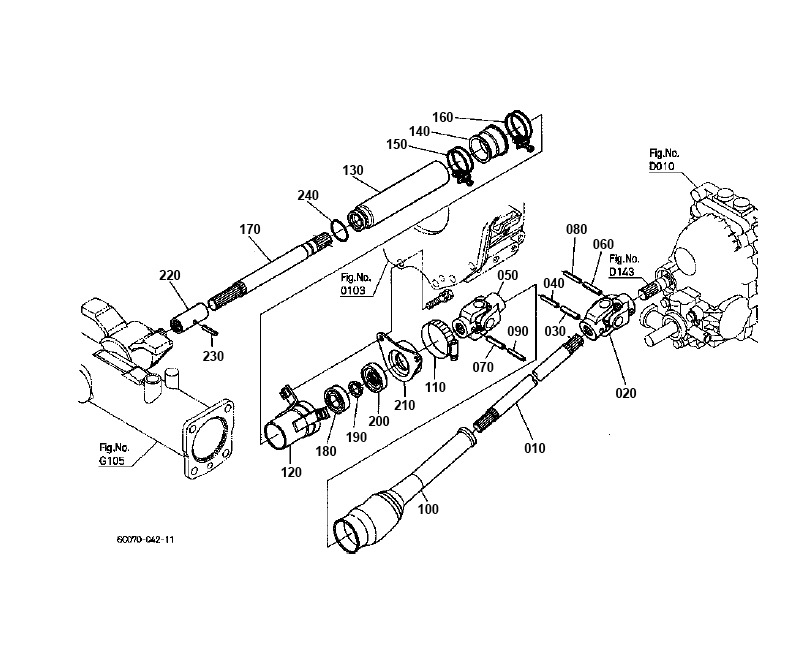

Here is a cut section of the front wheel drive (6). Did the shaft break on the transmission side of the U joint or the front side?

Look at the parts picture and slide back the rubber cover on lower universal joint there is a pin holding the joint on shaft .tap out the pin slide the coupler back and lower to the floor then slide shaft from shaft at rear.
Question did this break from lack of grease. about only way to damage the upper shaft
unless the front pinion or gears in front drive. lock up

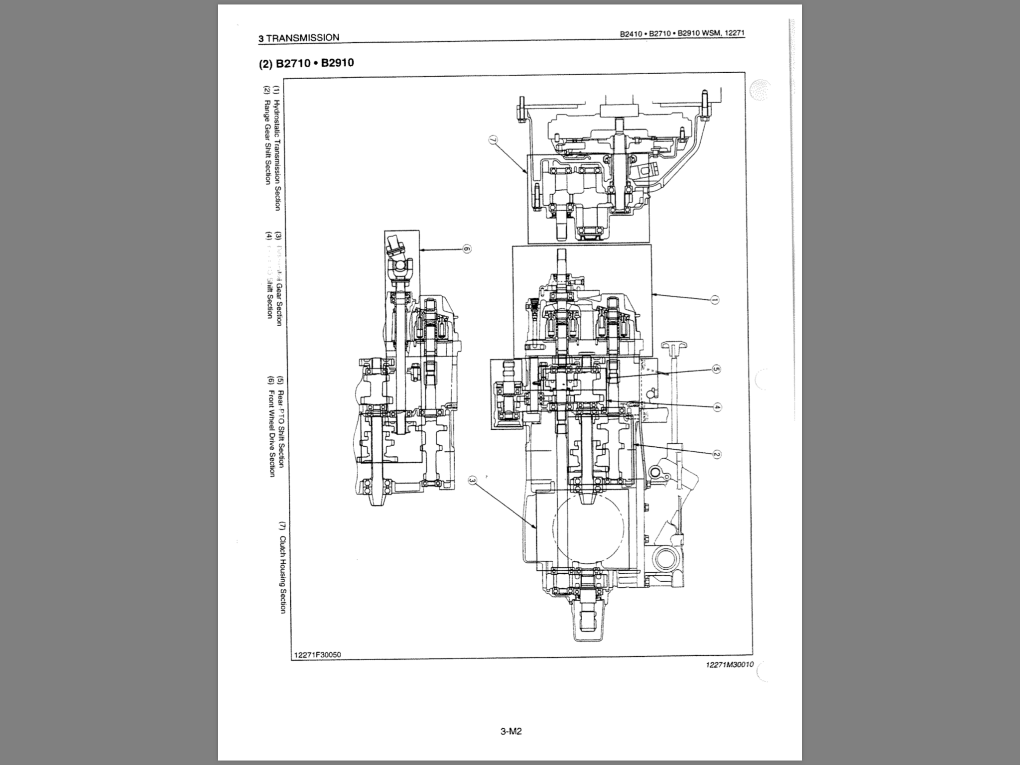

No need to split the tractor to replace universal joint. All is accessible from below.
Part # is 6C040-57500. About $118 at Messicks.
From service manual. This is for the front universal, but rear is similar.

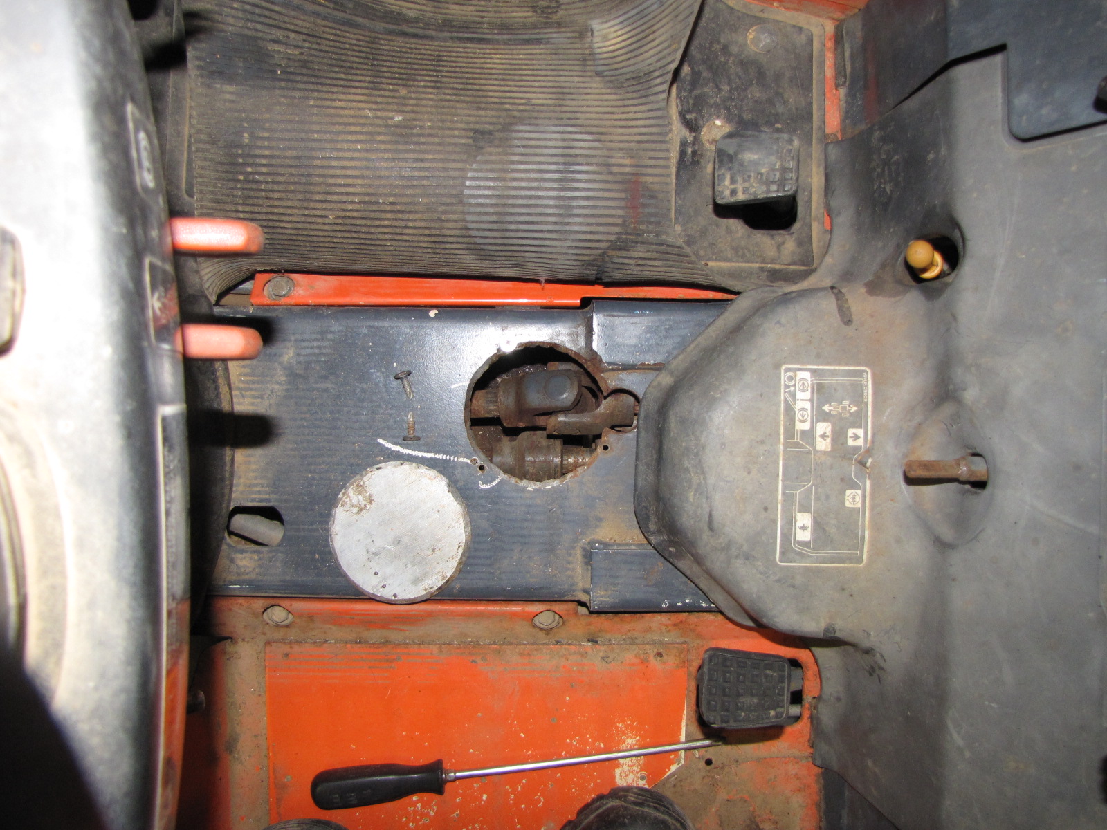

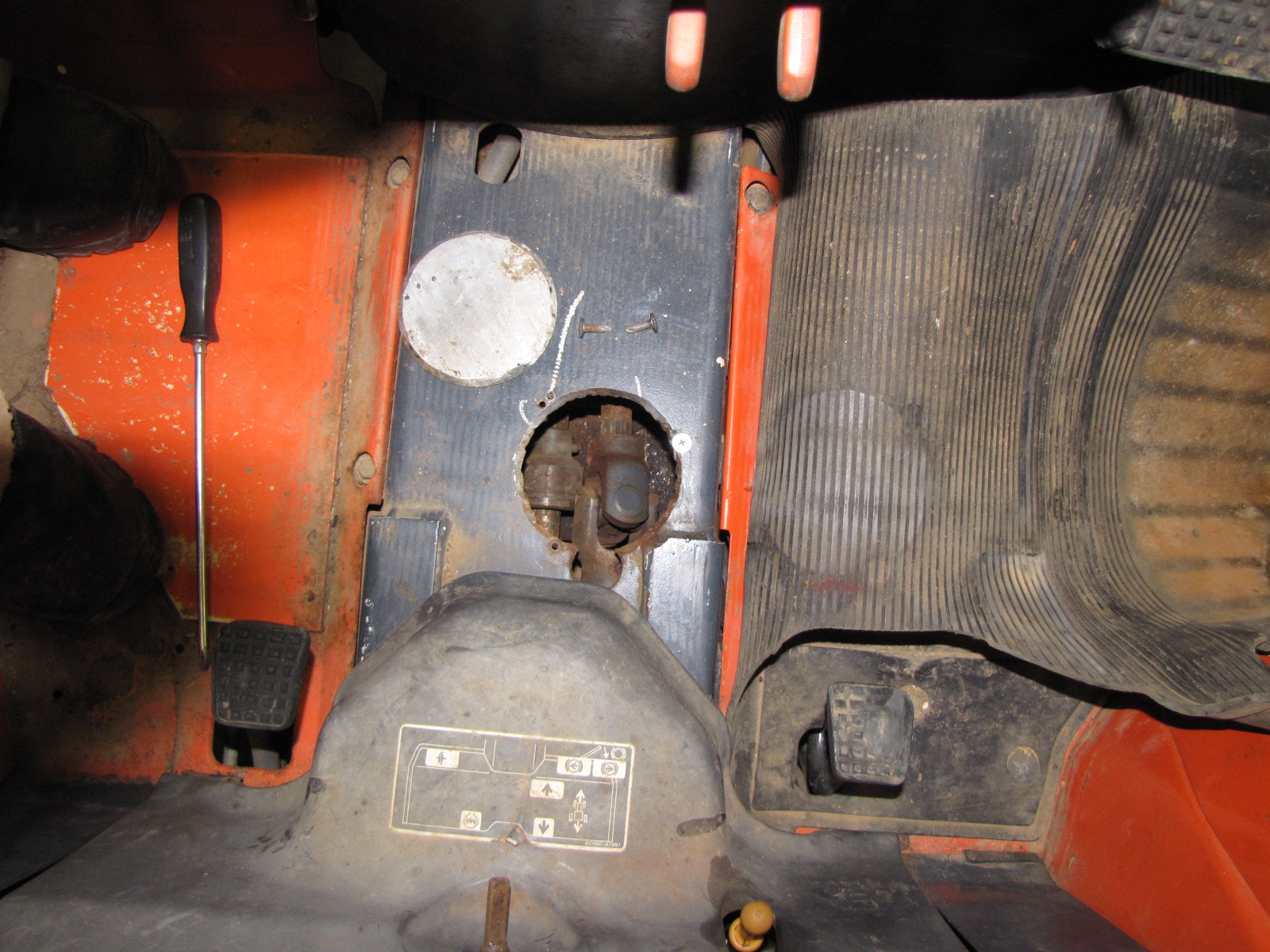

1st off if you have a loader the sub frame has to come off and there is 28 bolts holding it on. That is the hardest part of the job. The sub frame is heavy and if can get help do it. I'm 78 and did it myself but it was all I could do.
When I split my 7800 to replace the throw out bearing I went ahead and drilled a 3 1/2" hole over the rear joints. Now I get at both roll pins and can line back up easy when going back on. I wouldn't want to split the tractor at the trans, that looks like a real job.
Here are some pictures of where I put the hole and the cover I made for it. See if that helps. If you do this make sure the pilot drill isn't to long and go slow.

That is exactly what I plan to do. What did you use to make the hole? Will make the job much quicker and easier. You tack welded the piece back in as well correct?
/ b7800 front drive shaft replacement #10
I used a hole saw and no I did not weld back in. Blow the picture up and you can see three screws hold it in. It is flush with the deck.
