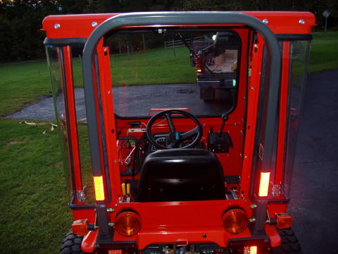

I agree with kokopelli2. I have a B2410 with Curtis soft side cab and a fixed ROPS. There is room for a short rotating beacon on top of the cab.
Your ROPS will be higher but the cab should not hinder you folding it up and down.
