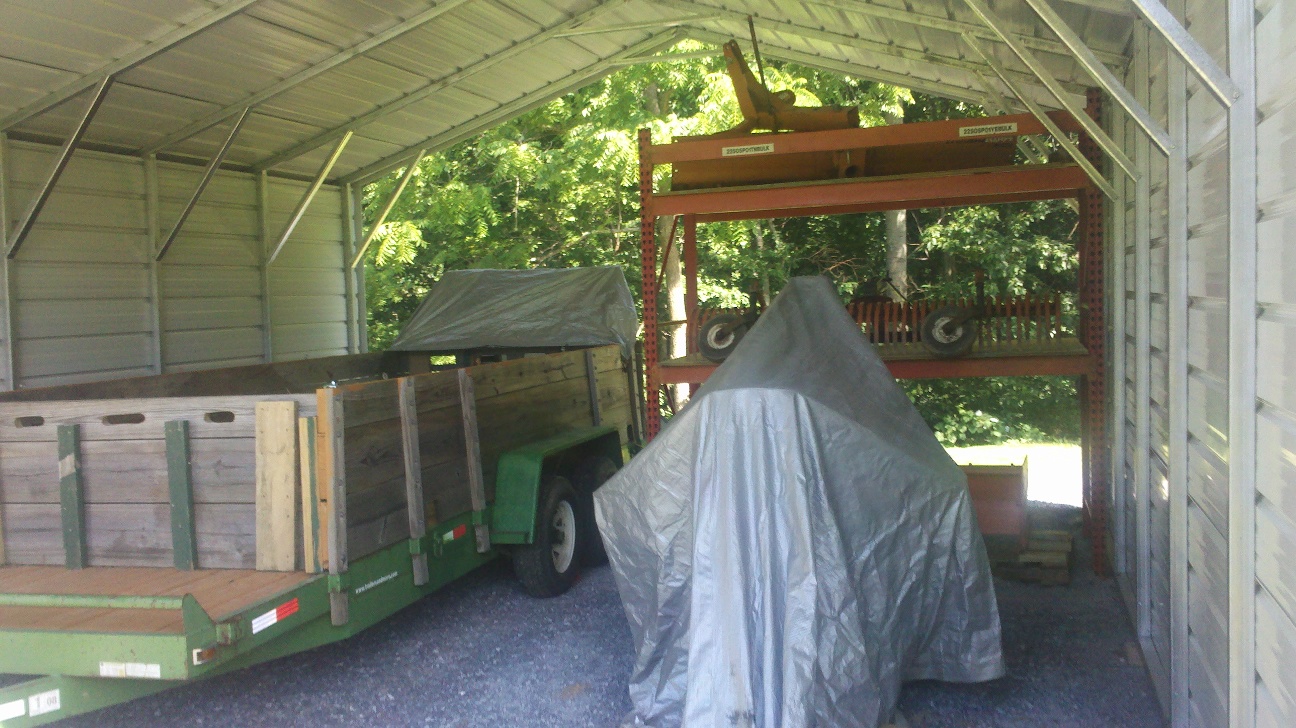

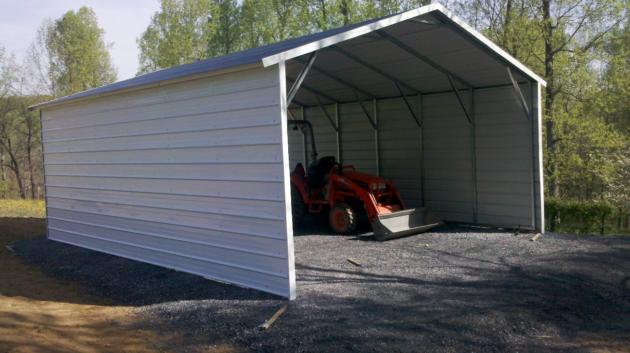

I built a leanto on the back of my barn for mine. Then I needed storage for my trailer and attachments. So, I bought one of those steel carports with closed sides. These are pretty nice, and about as low-cost as you can get short of building your own using recycled lumber. My carport is 20 x 27 with upgraded to 9' high sidewalls, heavier gauge metal frame, closed overhangs, mobile home anchors. Less than $2500 installed.
THis I an interesting option. Thank you for the picture, especially as I have been looking at pallet racks for vertical storage. I am very concerned about high winds in my area and this thing flying away. Have seen some Midwest guys on this site showing their carports blowing away. Any input? I know I could put a slab down then have his installed and attach it to the slab via anchors, or with various other methods.

Hayseed, I was a bit concerned about wind too and snow load. After watching them put in the mobile home anchors (~5" augers, 30" long, screwed in with a big slow powerful drill like contraption), I think it would take a direct hit from a tornado to lift it out of the ground. For the snow, that is why I went with the heavier gauge frame. I feel pretty secure here in northern Maryland, but if I were in Buffalo, ny I would probably make other alterations to it. Great little shelter so far.
