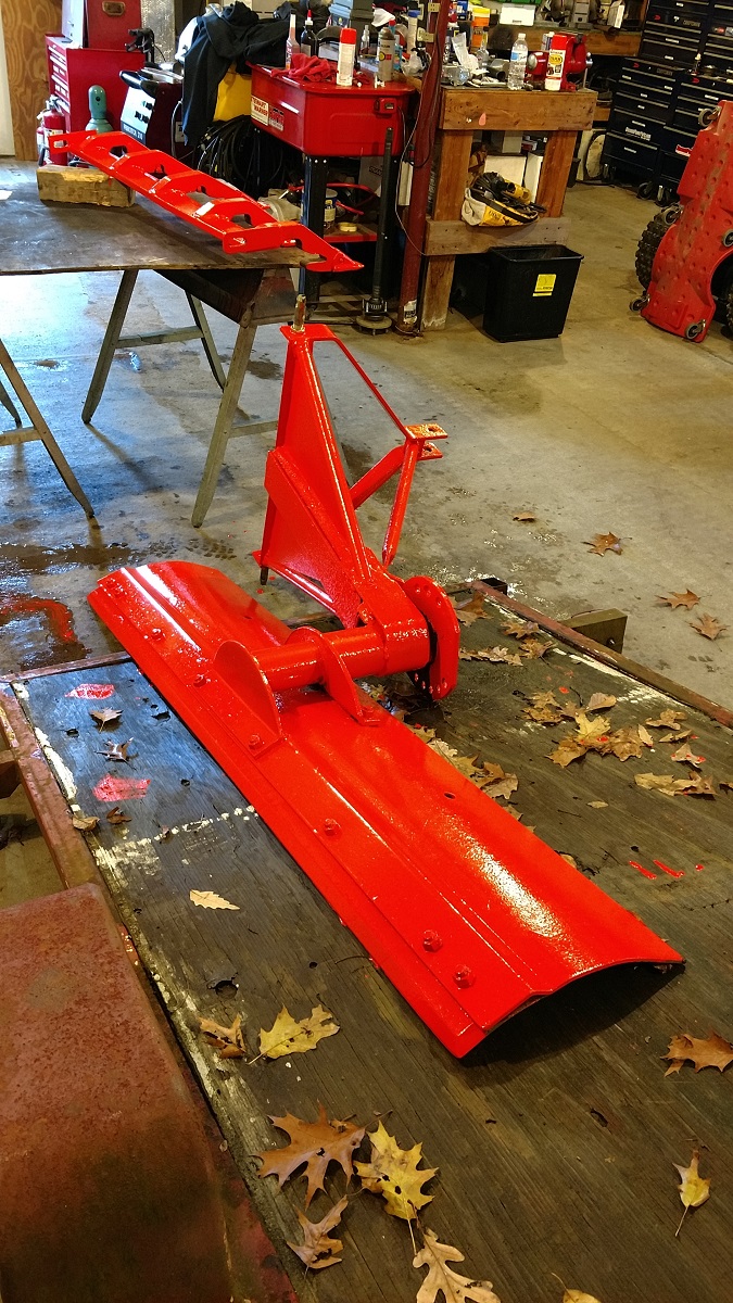

I just knocked off the small amount of scale rust, then I put 2 brushed on layers of Rustoleum Kubota Orange. It smooths out and looks sprayed overnight. It's been used well on both dirt and on driveways as well as some snow removal and other than the blade, all paint is still perfect and I don't expect to need to do much of anything to this old blade for a number of years.
I did not wire wheel it, no sand blasting, no chemical pre-cleaning, no primer. Just scrape the scale crap off, and slather on Rustoleum.
