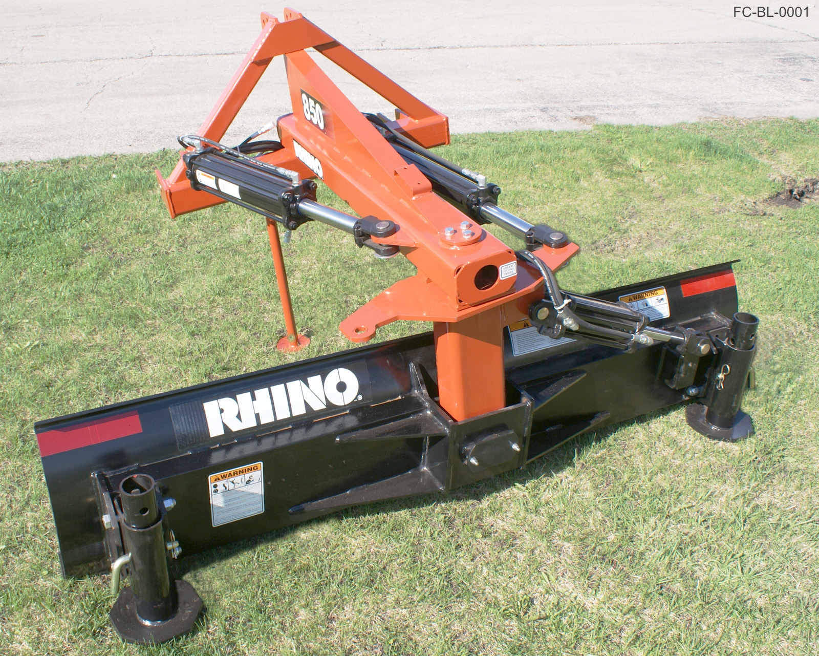

Some blades (e.g. Rhino), they just put a second hyd. cylinder connection 180 degrees apart from the other. Just pull the cylinder pin, rotate blade 180 and reconnect. Maybe there's a way, a will, and a welder that can do same?
