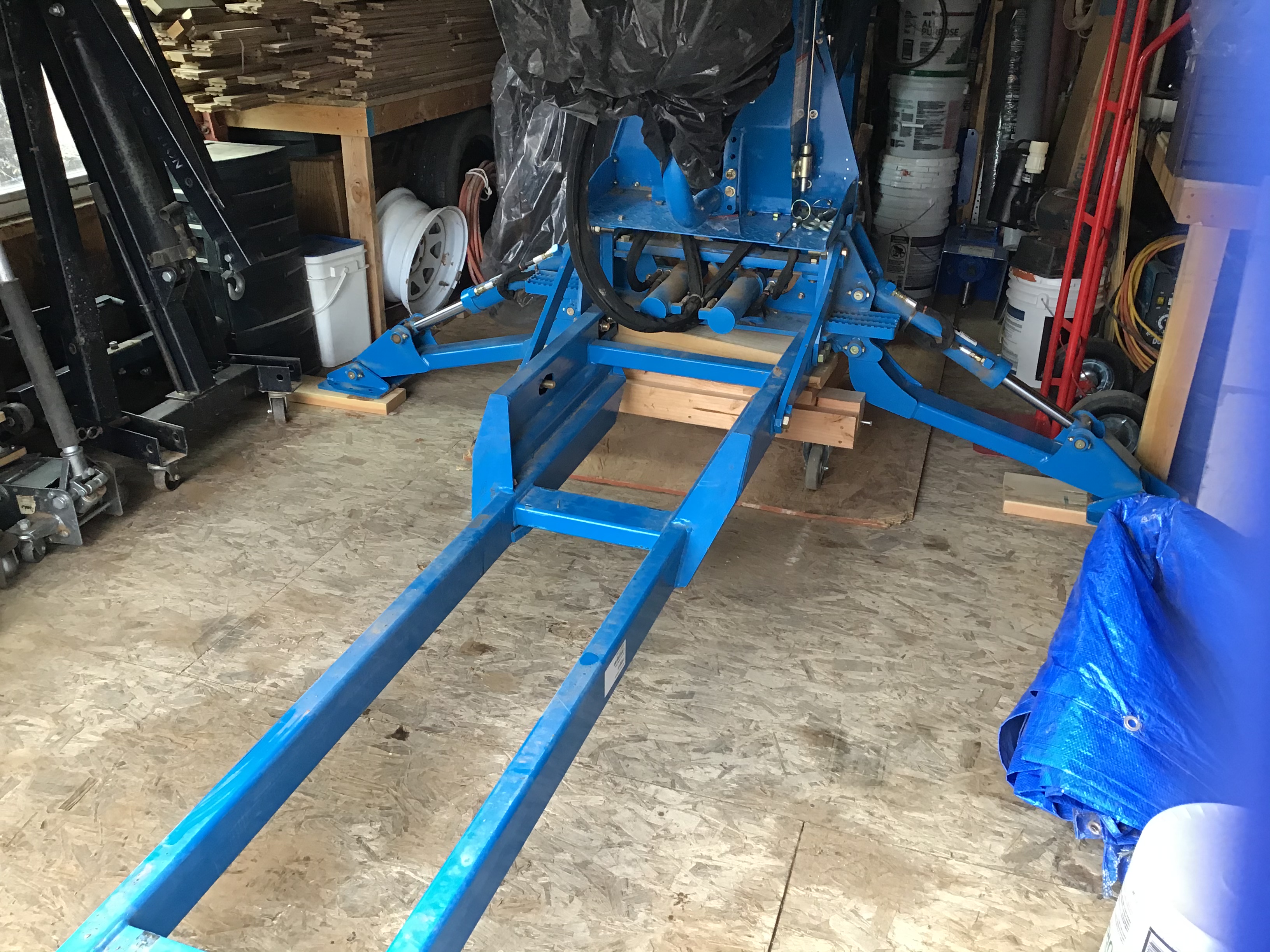

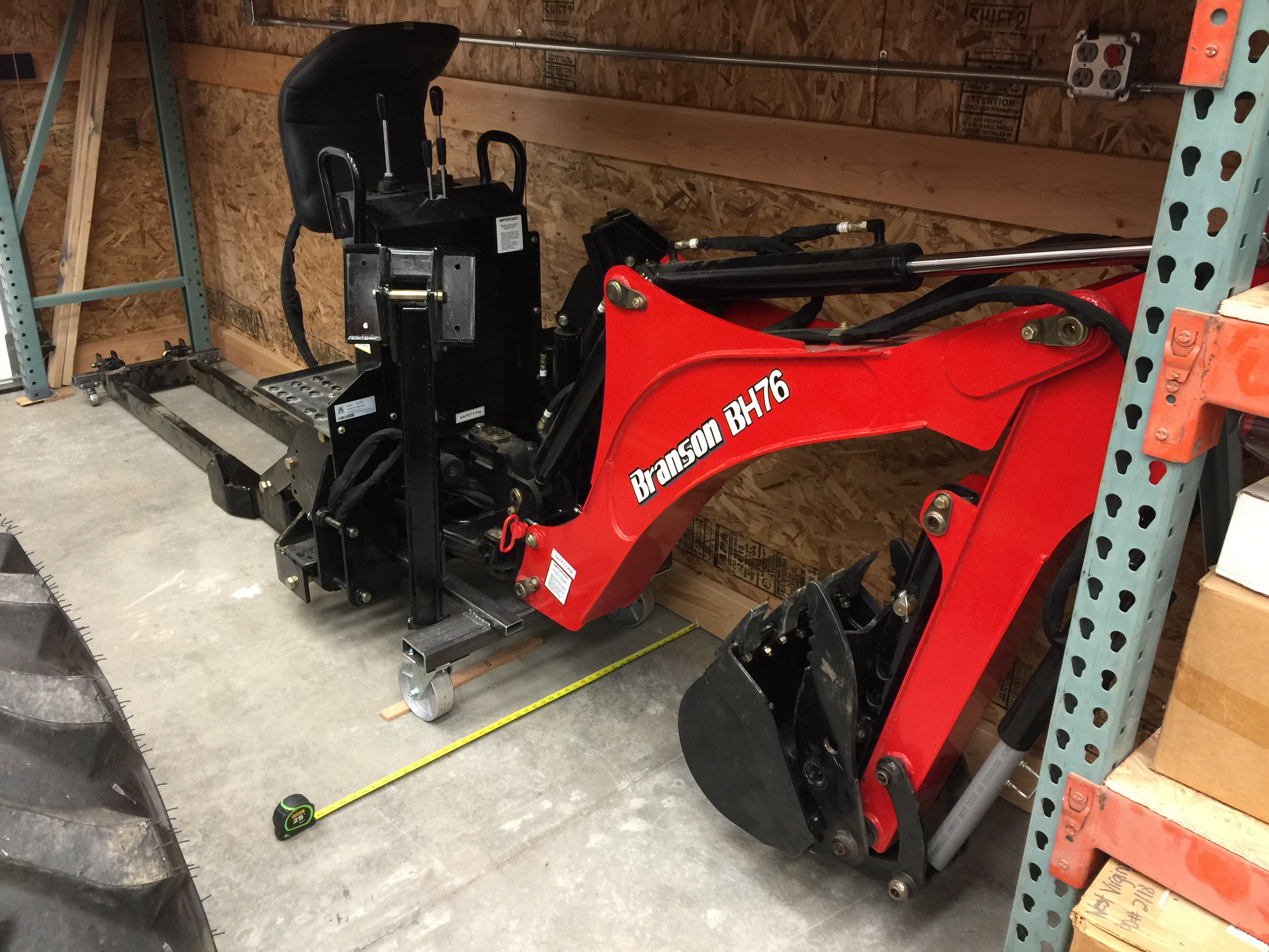

I have. Basically had to find the center and fabricated a small dolly with steel wheels attached to it so I can mount it on before setting it down. It’s important to keep those wheels outside the center of balance or it’ll tip. Fortunately, I found the spot under the pivot pin and the bottom was flat. The other end was light.
The outriggers went into side “cups” made of steel tubes to narrow the profile as it was rolled underneath my pallet rack. Flush. This eliminates any straps to hold the outriggers up as they all sag. The boom was locked in place and the bucket was kept from dropping by locking the cylinder in the extended position.
I found that steel wheels on smooth surfaces are best. Neoprene rimmed wheels didn’t work as it was difficult to move.

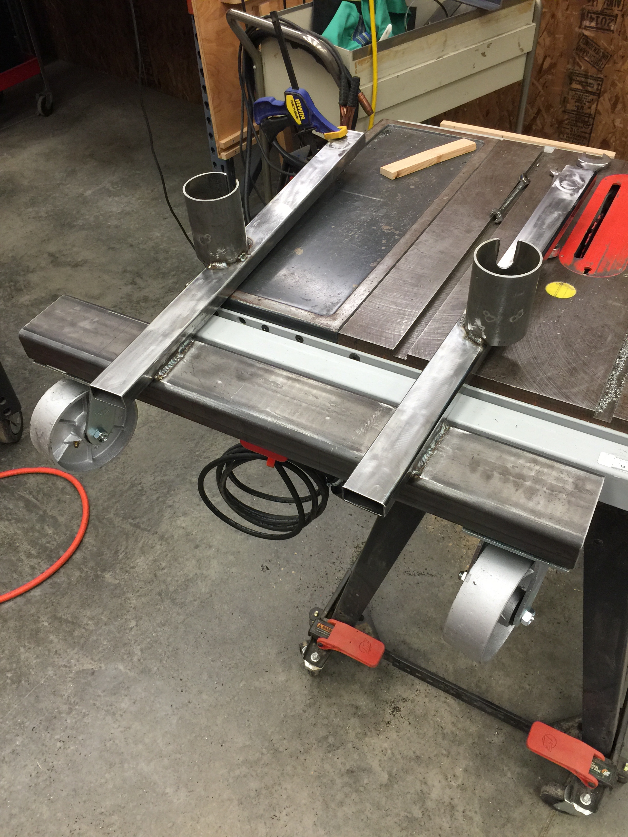

I got the casters yesterday, took some preliminary measurements. I have not decided wether to make it one piece, or go two piece. I bought 2 sets of casters, each having a pair of swivel, pair of stationary wheels, so I am leaning more towards the two piece.
I have a couple of projects ahead of the dolly build, so might be a couple weeks before I get to it....

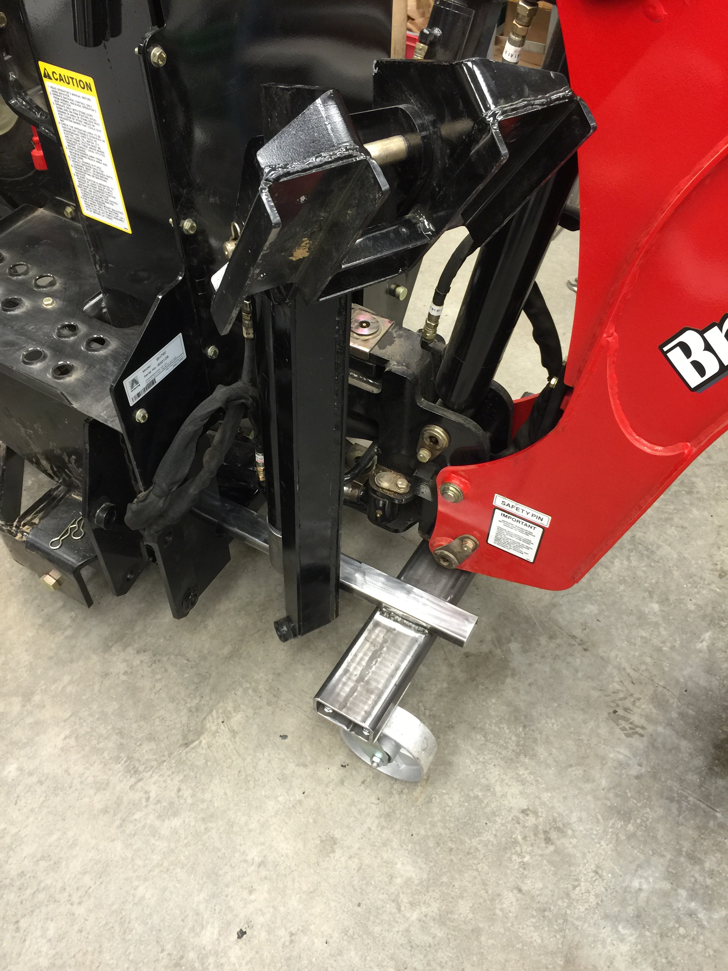

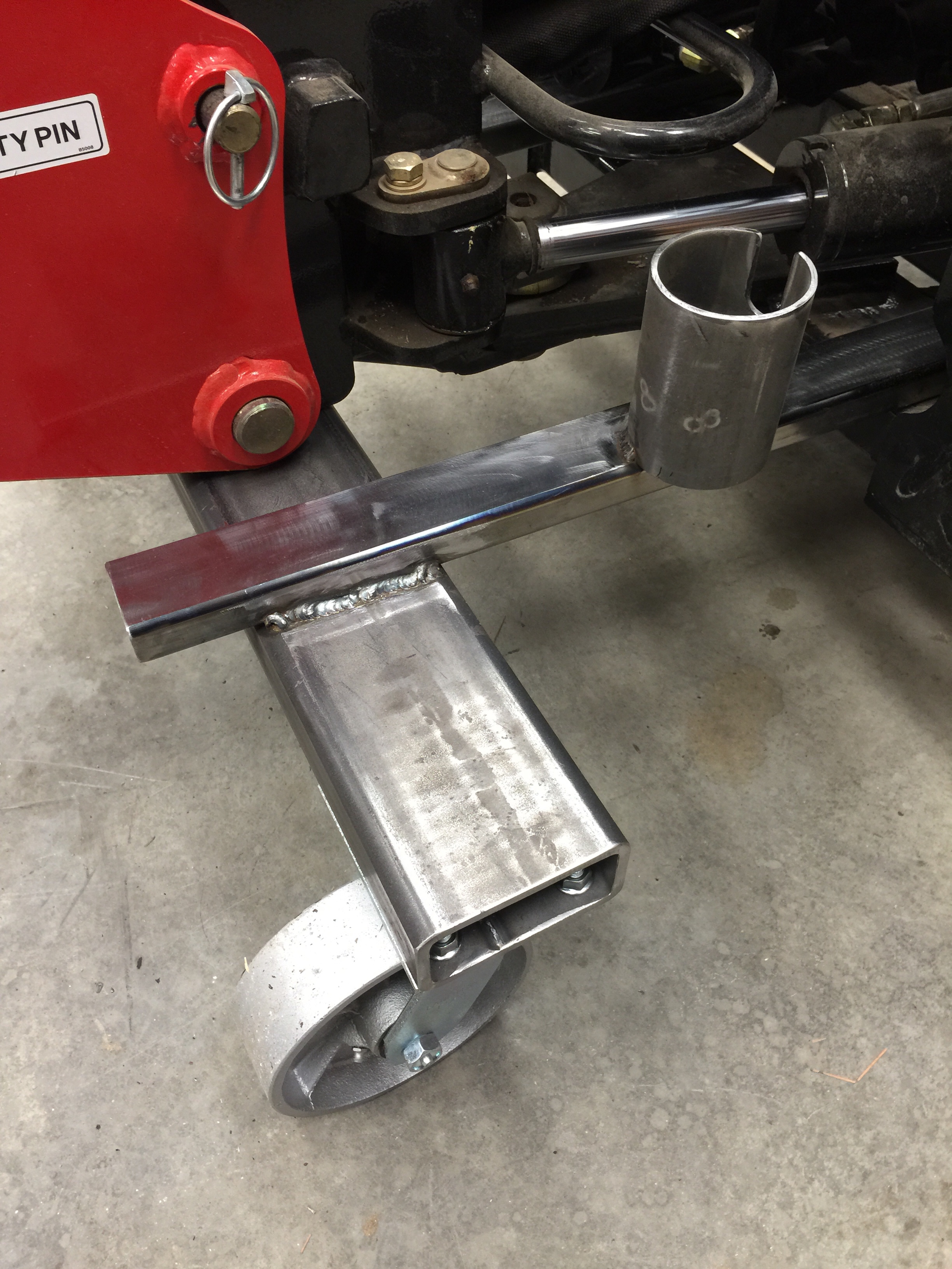

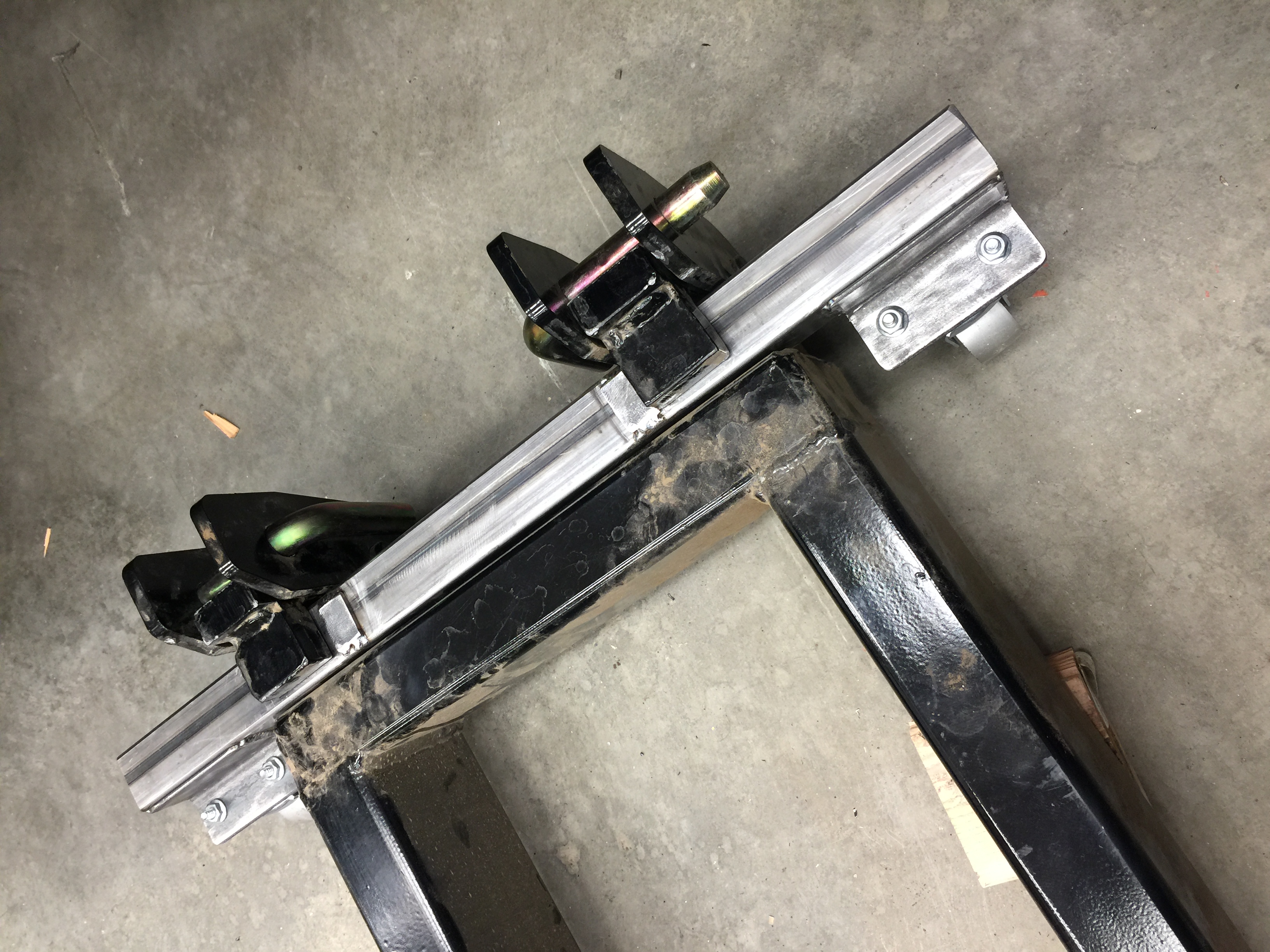

The dolly is actually installed while the backhoe still on the tractor. Since then, I’ve installed a small plate underneath the pivot to give clearance for the boom to move down to assist in the removal. The main dolly’s arms has dowels that drops in existing holes in the BH. It was secured with snap pins for security.
No tools were used at all to mount or dismount the BH except to take out the lower 3PH pins on the tractor during the conversion but none for the dolly setup. When I built it, I just figured out ways to “bolt” casters to the frame and better if I don’t have to use tools so my advice is to try to go with that approach. Start with a wood block to find your center of gravity then go from there.

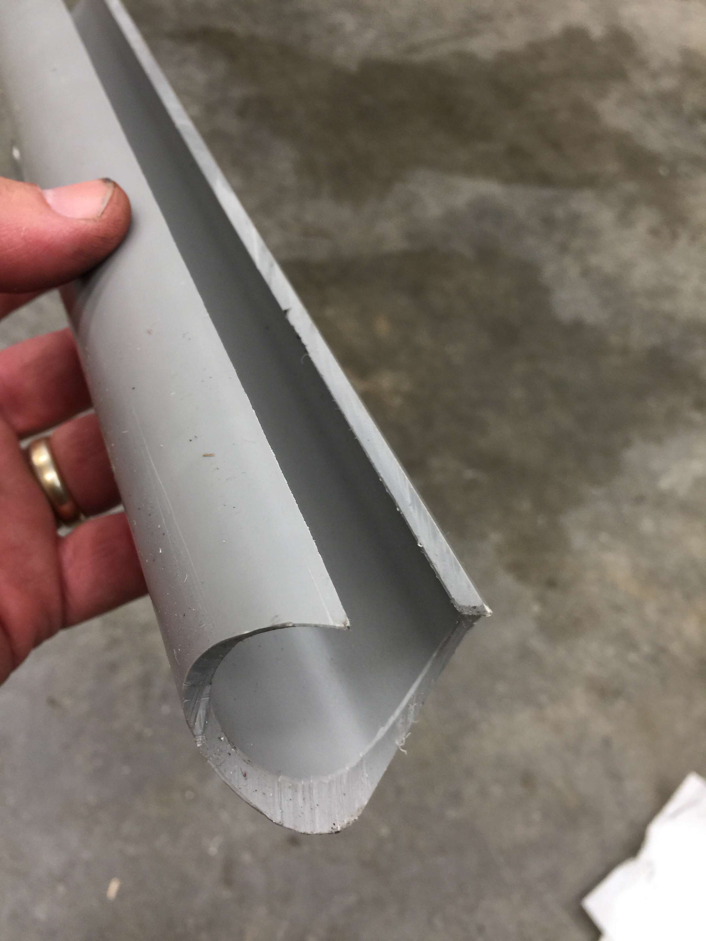

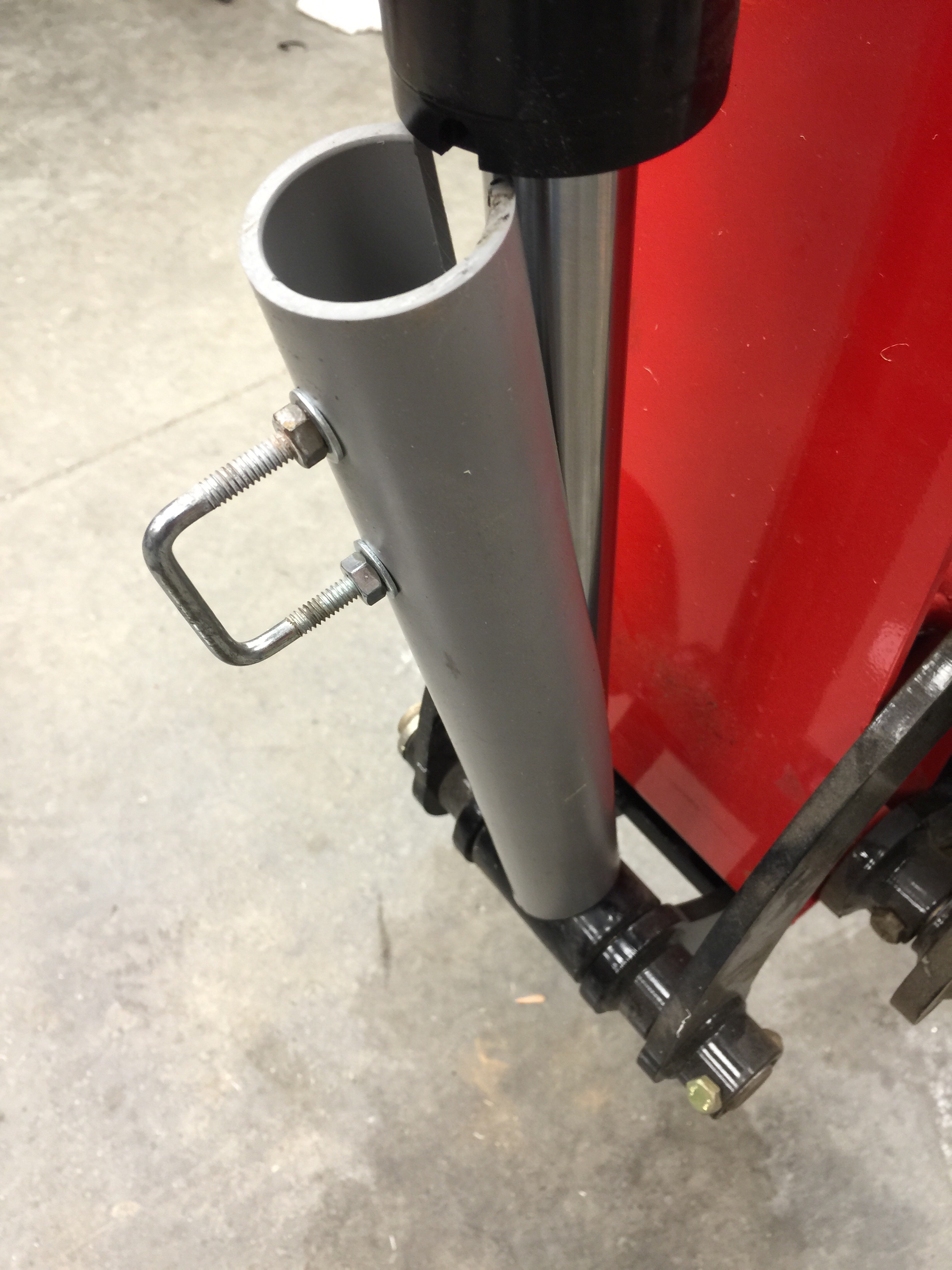

The CG was my concern, I use the boom / bucket to “ pivot “ the BH to line up the front undercarriage. I usually have set the BH down on 2x12 blocks, but leave the stabilizers down, and the bucket on the floor. It is REALLY eating up a lot of space! My ultimate goal is to get the BH “ folded up “ like you have done with yours for more room.
I like the PVC tubes to lock the cylinders.... I am fortunate enough that the LS BH has built in stabilizer locks and a boom lock.

Liked the pvc over cylinders as well.

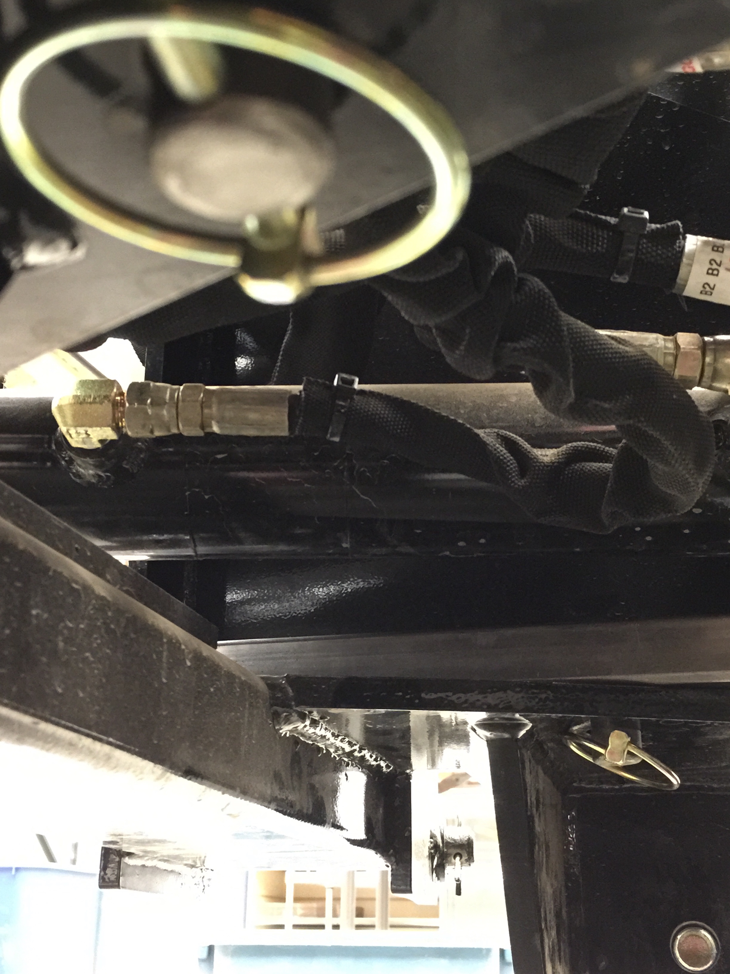

/ Back hoe dolly #12
Hope this helps. The first photo shows where the pins drop in the existing holes and secured with snap pins. If you need more details, let me know.

In building my dolly, I found that when the backhoe is on the dolly I can roll the whole thing under the tractor and attach it. However, when the backhoe is on the tractor, the tractor squats enough that the dolly is 1/2" to tall to roll under the backhoe to take it off. I use wooden blocks under the tractor rear wheels when I need to take the BH off.
