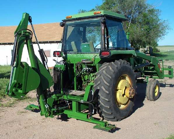

see here is a 'lighter duty hoe" the reach is close to what your wanting to build,
Truckhoe&Towable Truckhoe - Versatile Backhoe Alternative
it is using 25 gallon a min, hydraulics
a heavy duty unit would take much more,
an unless you have a fairly hefty skid steer loader that is a lot of back hoe, and you would probly need stabilizers as well, to use it efficiency,
mine is smaller than what your design parameters are as you stated them, (not a micro) but I have it mounted on a 8000 pound 100 hp tractor, and if you do not put the stabilizers now it will shake the tractor all over, (it has a sub frame),
attached is a picture of the unit I jsut finished,

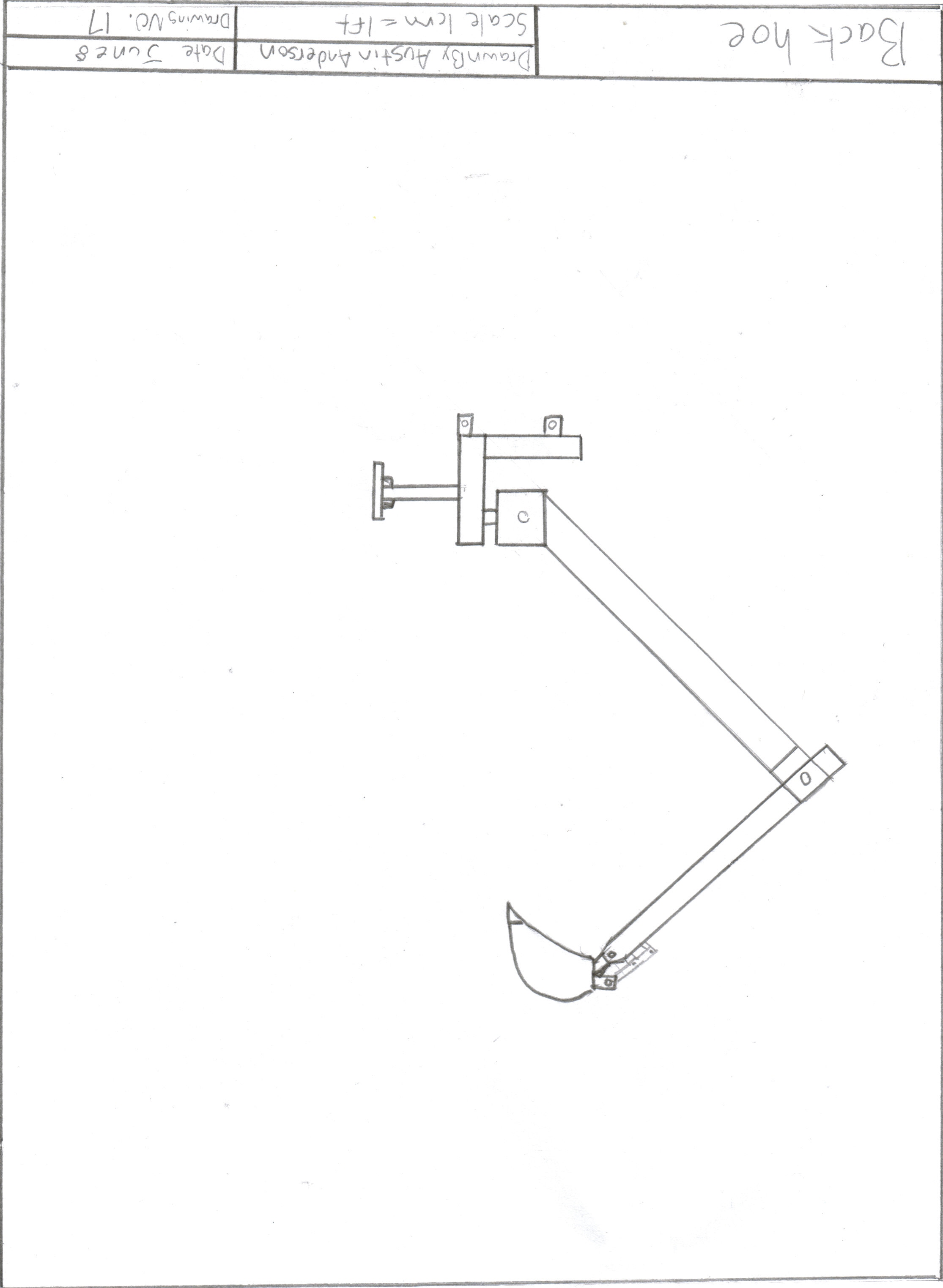

i wanted to now if the backhoe in the pic would work
sorry i forgot dimensions it has a 5' arm ,4' dipper ,2' outriigers

sorry I messed up and only posted about half of the plan, it is in two URLs
http://www.machinebuilders.net/plans/gallery/Tractor Equipment/Free Backhoe plans-1.pdf
http://www.machinebuilders.net/plans/gallery/Tractor Equipment/Free Backhoe plans-2.pdf
the machine is about the size that your drawing, it has the hydraulics and the basic plans, you basically need the second page it has the dipper and the boom and bucket,
it does not have hydraulic out riggers, but you could probly use the stationary out riggers and jsut lower it to the ground once mounted on the skid steer,
on the frame you would basically jsut want the part from the out rigger tube forward and then a heaver up right for your three point mount,
you would probly have to modify the pivot cylinder to a side mount instead of the rear push/pull it is a possibility two small side cylinders opposite of each other would work better for a three point mount.
take a look at this picture and you may get an idea what I am trying to say,
Backhoe, Build a backhoe, these plans show you how.
some other links you may get some ideas off of.
Micro Hoe <BR>pics 2
CadPlans Corporation - Where you can find designs, tips and order information to build your own backhoes, diggers and MORE!
calculators for a number of different things, hydraulics and sprockets
Baum Hydraulics :: Spec Calculator
I will not say your drawing will not work but as I stated in a early-er post, I think there are some improvements that could be done,

thats only 1 of my drawings ive bin looking at lots of backhoes on the internate and have drawn a couple more since
thanks for the ideas
