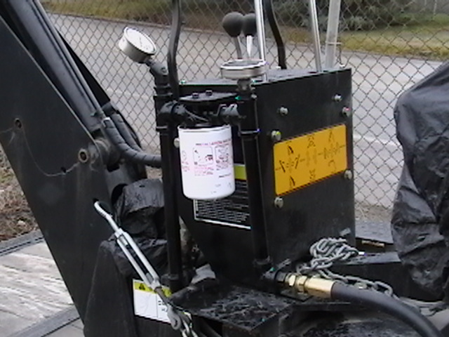

Ok,,,,update, I BOUGHT IT,,,,dug my first stump,,,it's a little heavy for my tractor, had to put 200lbs of weight in the bucket to get it to steer . But the hoe performs nicely, , a little jerky but that's expected.
Put a return filter on the return line 25 micron, but it keeps blowing apart?..
Any ideas, I put QC on both sides of the filter so I can take it out.

Not sure why you did that. Usually return filters are part of the equipment they service and are hard plumbed. I suggest permanently mounting the filter to the hoe.
Usually return filters are 10µ. What keeps blowing apart, the filter cartridge itself or the quick-connects?

There was no room to "mount"the filter, you guys were the ones to suggest a return line filter, . The filter canister itself ruptured on one and the rubber seal blew on the second,,,,obviously there's to much pressure there, this is a log splitter return line filter, 25 micon was the smallest available

There was no room to "mount"the filter... this is a log splitter return line filter, 25 micon was the smallest available
The return line must go (unresrricted) directly back to the reservoir.
This is an excellent value for $18.00. Surplus Center - 3/4" NPT 20 GPM FA1200-10 RETURN FILTER
I mounted my return line filter on the console, but admittedly I'm a little more **** than most because I also employed a restriction gauge and a thermometer.
