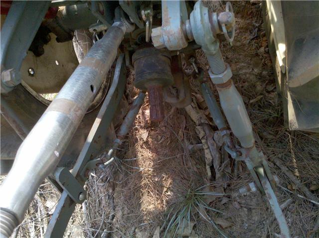

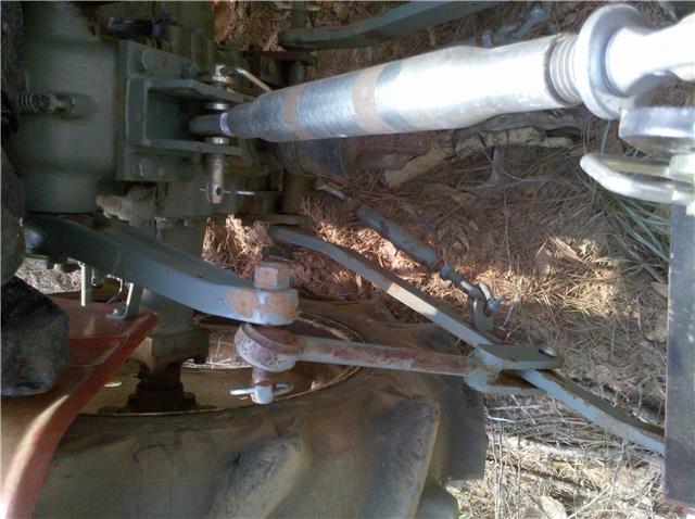

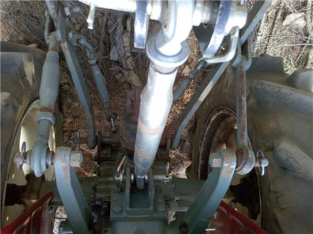

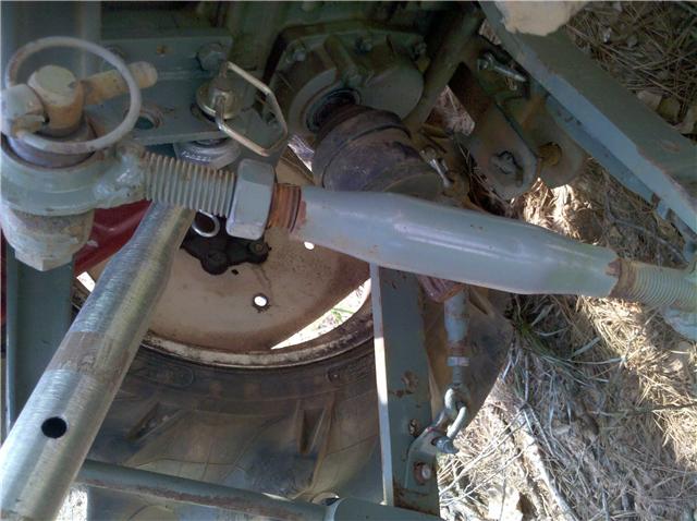

/ Backblade problem
Alright, I've had a chance to take a few photos and I think they're attached...
Photo 1 shows the left link is solid... the right one is the turnbuckle... sorry I couldn't turn the rest the right way...

/ Backblade problem #8
The turnbuckles that are mentioned are not talking about the vertical turnbuckle you see on the right lift arm. They are the smaller horizontal ones on either side of the drawbar (below the PTO). Tighten up those turnbuckles to keep the blade from swinging side-to-side.
-rus-
/ Backblade problem #9
As rus geek said, use the turnbuckles which a parallel to to ground to adjust out most of the sway in the rear blade. Raise it off the ground and start tightening until it has only a little sway. A little oil or WD40 may make it easier to adjust. Use the more verticle turnbuckle to level or create and angle with the blade to the ground such as when you would want to create a higher center (crown) in the driveway to allow for water to drain off.

/ Backblade problem
#13
Alright... I went out to tighten the turnbuckles and was successful on one... it kind of removed a bit of the slack... but the other one... the head of the eyebolt snapped right off.
Looking at the threaded portion, it was rusted completely through. I guess I'll get two new turnbuckles from Tractor Supply this coming weekend and tighten them up a bit.
