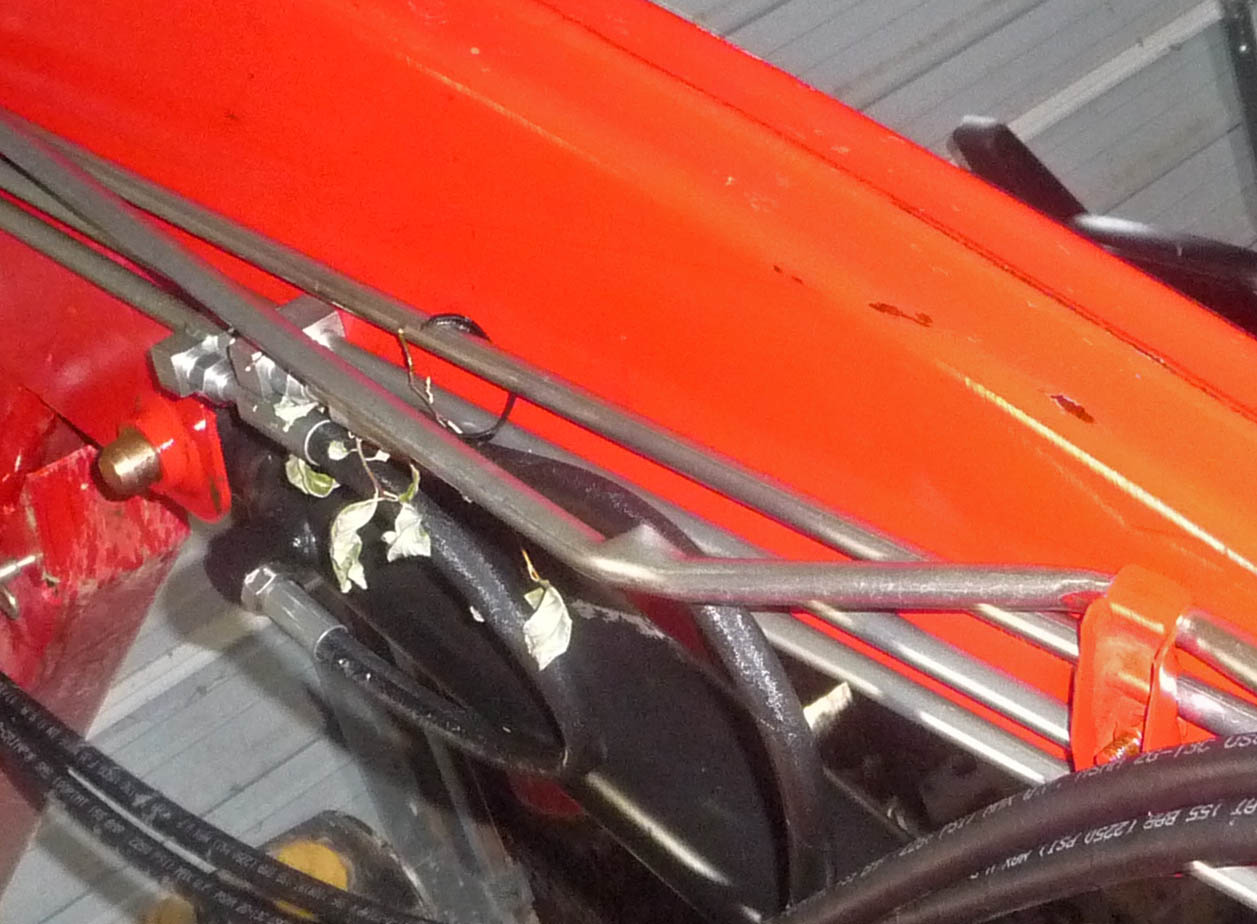

Second, me too Beowulf ... but not twice !! I suspect I concocted one of the worst possible cases of backdragging using my MF2660 (81 horse, 9000 lb as usually equipped). I was preping a building site and trying to level out some rock-hard clay. Mean hard clay. The bucket was cocked back for max digging angle. I'm in 4WD low gear, revved up well and going in reverse on a fool's errand. Plenty of traction too... The result was a set of steel hydraulic lines split apart in what sounded like (and actually was I guess) an explosion. Yes, I had a dumbass attack. If you look at the bent bursted line in the picture below ... it just blew out and scarred crap outta the operator needless to say. To my knowledge there was no cylinder damage or other effects. Dealer had the steel lines in stock and I installed them myself with no long term issues. Other than lessons learned !
