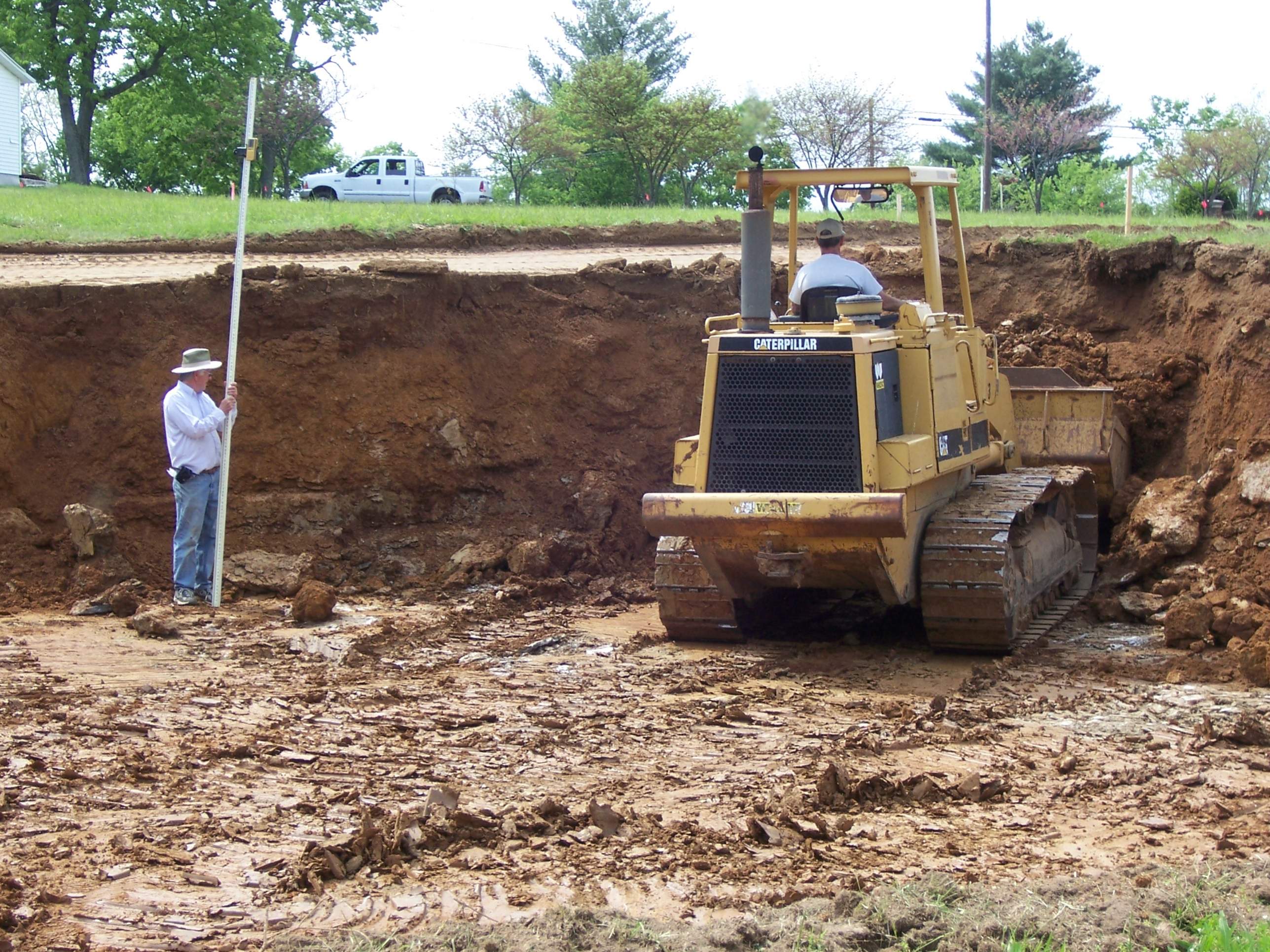

It turned into a bigger project than planned. We knew it would be rock but did not know how hard it would be. If the Komatsu 300 could have dug out the rocks it would have been over in about 4 days. That thing moved over 800 yards in the 3 days it worked.
The hill peaks less than 5' above concrete walls. I need to measure it more precisely for the perk test as we are planning to use a leech field on the other side of the hill and hope to trench through it for a gravity flow system.
This picture is taken from the top looking toward the house after the excavation but before the concrete. The concrete walls would be roughly centered.

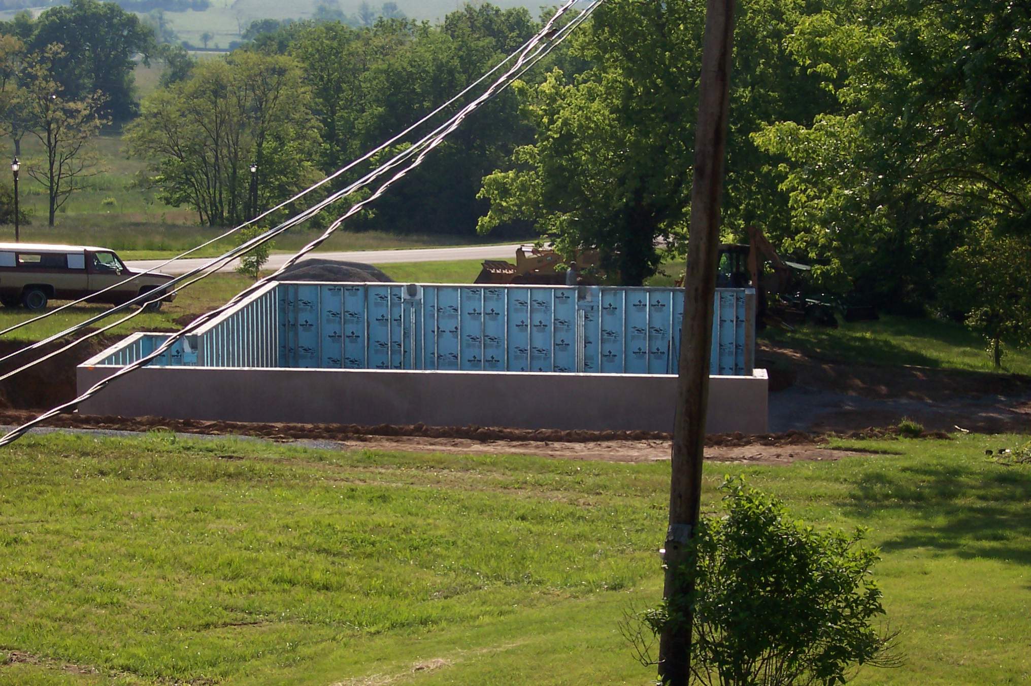

We have had a week of heavy storms. A few flash floods and 2.5" in the rain gauge. Water was running 6" deep through the culvert on my driveway today even though it has not rained for 24 hours. It was clear that water had run out through the drain pipe. The are around the slab, walls and footers was dry. The city pit was where I left it and well packed by the rain but will need to dry out before I can get the concrete truck in there.

Be careful bringing in that concrete truck close to the walls, I'm not familiar with "city pit" fill. But around here clay is very unstable, our red/brown clay is the last thing you would use for back-fill (made great bricks). Once it gets wet, it stays wet forever, like working on a sponge.

The "city pit" product is also called crusher run or bank run. It is produced by using a large dozer to push across the top of a lime and shale area. It is the choice material for road base in my area. In fact my supplier had a problem recently that the state said it was compacting too much. When it is loose it asorbs water. Once it dries out it is similar to concrete. In my experience water runs off of it and even when water pools it does not penetrate the city pit. I was planning to use it for backfill as it is one of the least expensive materials that I can get. A local waterproofing company that bid on my job also recommended it. There is 800 yards of it on my driveway. It has not washed at all since installation in 2008 and has handled heavy equipment, concrete trucks and many many dump trucks without a problem.
Looking in.
Looking out, the ramp to the road is greater in depth than the back fill area.
The concrete truck is supposed to come on Thursday. If it does not dry out before then I will have to reschedule. We will bring the 40,000 pound excavator over and test the backfill area with the bucket before the concrete truck arrives.
