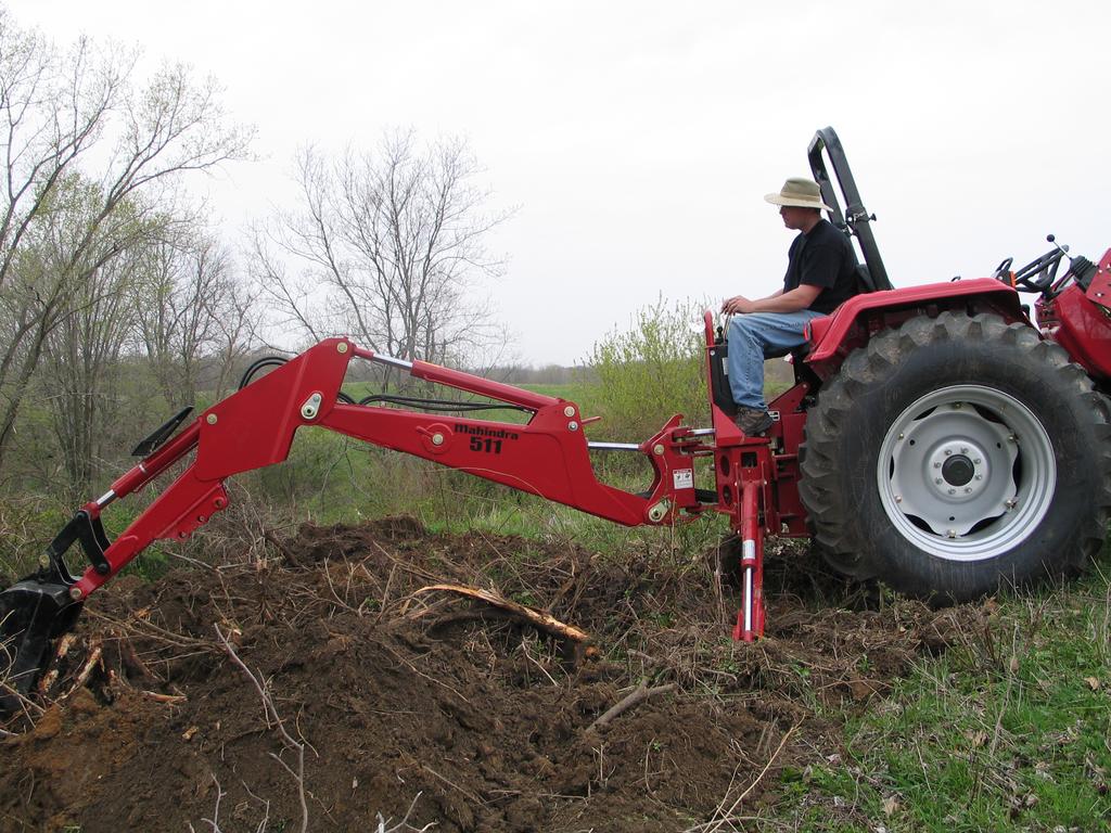

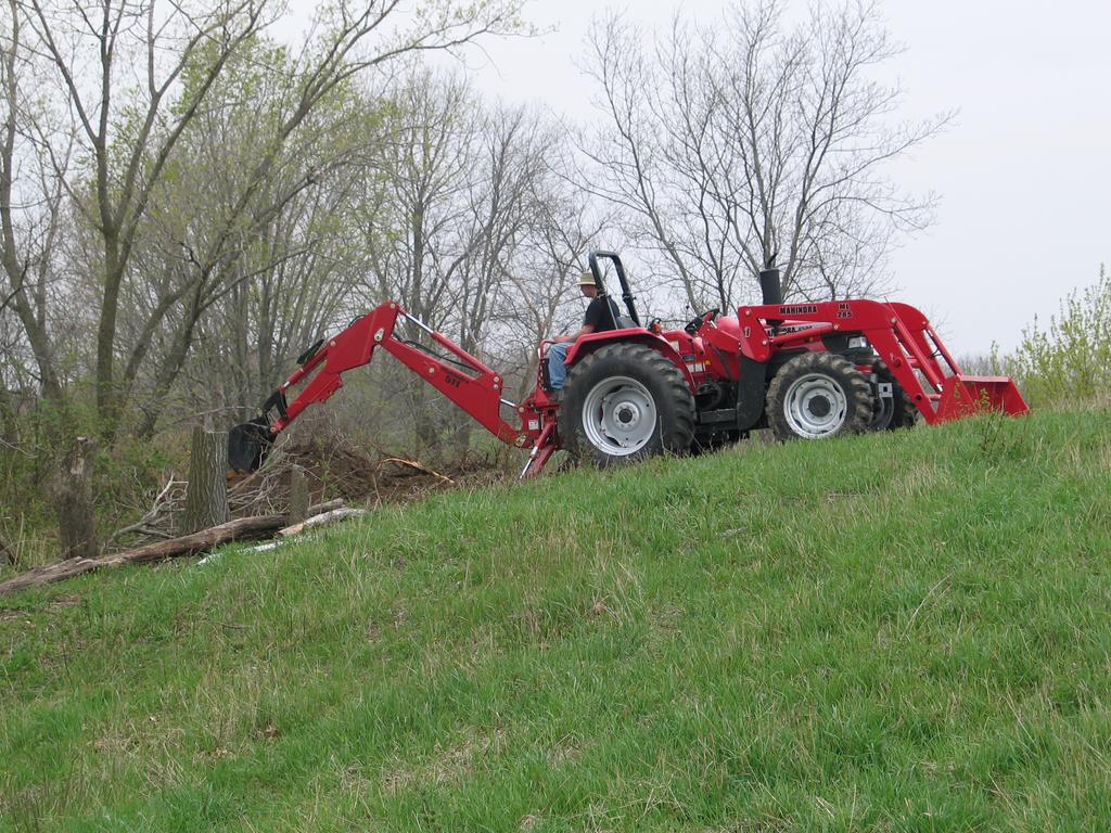

Speaking of reach. That is why I picked the 511. I can't remember the specs off hand but it can sure go deep (or far :) ). Here I am the first day I was using it.
Let me know when you are ready to trade! :D
Dougster
