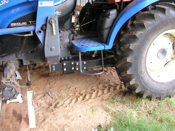

Here's a photo of my tractor setup that illustrates the problem. You can see the 3 point links that have an implement on them in this photo. You can also see the backhoe mounting brackets (that have 4 mounting points, 3 visible in this shot). Obviously, the backhoe fits in the same place on the tractor as a rear implement hooks up. I'd just ditto my earlier comment about removing the 3 point arms. It's not that big of a deal.
The backhoe mounting brackets are part of the backhoe subframe, which extends underneath the tractor (see photo in earler post). On this tractor, the subframe is permanently mounted to the tractor. Other backhoe designs have a removable subframe, which comes off when the backhoe is removed (see Dave1949's comment).
A subframe mount gives a much stronger support for the backhoe than would be possible using the 3 point links, and a well designed subframe limits how much stress is put on the tractor itself when the backhoe digs. There are many threads on TBN about 3 point backhoes... get a pint of your favorite beverage and enjoy some extensive reading on the subject. Generally, the 3 pt ones are OK for occasional or mild use and not the best for heavy work.

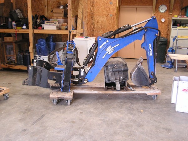

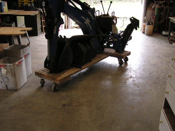

I'm going to ask y'all to be patient with me. I'm going to make a few posts here with pics and it might take me a bit. (I'm not real good at posting pics). Here is my hoe on it's pallet. Some guys here have built theirs from metal - I'm not a metal guy and I had the 2x12s inherited from Dad so I used them. I bought the 6 casters at TSC. You can see that when I back the tractor into the shop it's easy then to roll the hoe up to it to line it up and connect.

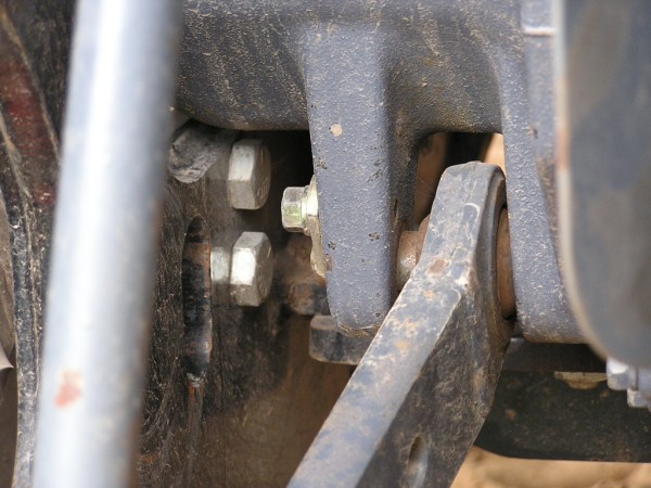

When I do my lining up I set the lift arms so they fit inside just above these hyd cylinders .....and YES you need to be extra careful NOT to bump or move the control that moves those arms while the hoe is on........pic 2 .....here you can see the lift arm at the tractor, to the left the small keeper bolt that holds the pin in, and to the left of it a hole in the hoe subframe that the pin is suppose to slide into during removal. Mine almost lines up which is why I leave my arms on. If you can do so easily I also recommend you remove the arms --- I am not able to do so ....easily. I did do a small modification to the pin so that if I need to I can get them out -- but I have to remove to rear tires to do so. Consequently -- I do what I do.

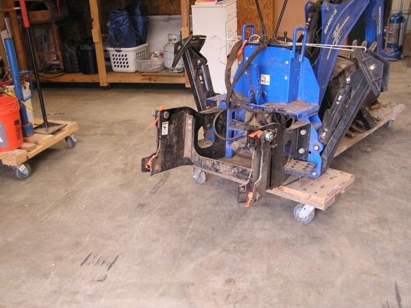

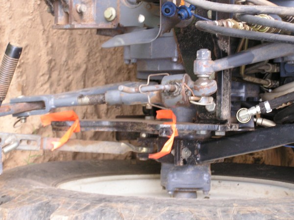

The orange tape are the 4 mounting points. 2 pins on the bottom that "catch" on lower hooks on subframe, and 2 bolts on top. I roll the hoe into position, hook up hyd, line up the lower hooks, then use the stabilator arms and bucket arm to move the hoe around to line up the bolts on top. Sometimes there's a bit of air in the system that makes the hoe jump during this process ---which makes my heart jump a bit too.
