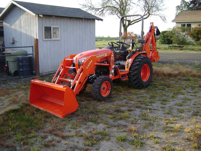

I am looking at buying a Kubota B2650 with FEL and Backhoe. I could not find a pdf owners manual on the BH77 BH that it would come with, buy did run a across a BH75 manual that stated that the tractor tires should not be filled if a BH is attached.
Is this correct? Is there a problem with having filled tires on a tractor with a BH?

I think they say that because many people use the backhoe to lift and reposition the tractor when digging. They think loaded tires make the tractor too heavy to lift and may cause some sort of damage. I don't think it will be an issue.

I have a L3800 with a BH77 and loaded tires. I can't imagine what the issue would be with having both as the weight in the tires isn't directly supported by the axle/axle bearings. Interested to hear why the mfr would say to avoid it.

If you do not use the hoe to reposition the rear of the tractor and never dig downwards with the bucket you are correct. If you do reposition with the hoe or put high loads on the backhoe to break out large rocks then you are incorrect. Anytime the backhoe is lifting the rear of the tractor up the weighted rear tires are loading the axle/axle bearings, sub frame and other related parts.

I have the Kubota BH90 backhoe and the manual says the same thing, no loaded tires with the backhoe on.
   / Backhoe and Filled tires #10
The only thing I can think of is that the loaded rears would add to the digging force and may break something on the mast.
The mast will lift the tractor which would provide a measure of safety, or relief, from something getting bent or broken.
Somehow I don't understand how the rear axle/bearing can be loaded when the tires are off the ground and lifted on the outriggers. ???
My advice would be avoid a backhoe that requires unloaded rears. It would be a deal killer for me. A different choice may be made better and beefier. However, Kubota does seem to overdo it on caution.
Oh, and my L48 has loaded rears that require the mast to be used to extend the outriggers to full length. I have also repositioned the BH using the mast and lifting the whole rear quite often when digging out stumps.
