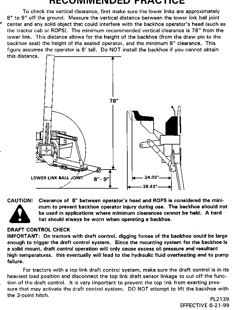

How many hoes has this dealer worked with? It doesn't sound to me like they are quite on the ball re: sub-frame mounts. The 7500 is quite a bit smaller then my 9000 but I still wouln't consider anything but a sub-frame mount.
I agree that Wood's website (and possibly catalog sheets) are confusing. 'Even more surprised when I just looked at the manual and it only shows the "Saf-T-Lok" 3 point hitch mounting system! Wierd. They do make a few references to the sub-frame - I think it has it's own manual (why they don't list it in with the BH is beyond me). Also noticed the mounted clearance requirements of 10" horizontal from back of ROPS to inside of the seatback and vertical clearance of 40" ABL (above butt level).

I have attached a WARNING sheet that Bradco sent with their model 3375 spec sheet. Interesting reading.
the next post will have an attachment that is entitled "Recommended Practice" and details how to measure or ROPS or Cab tractor to safely fit and use their backhoe????????????

Recommended Practice See attachment
