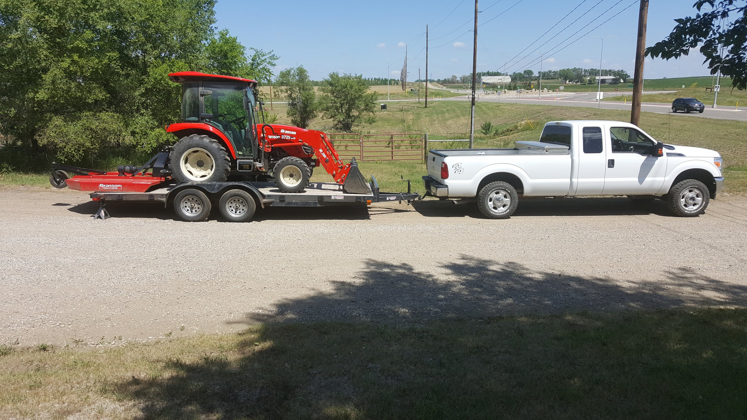

OP,
If you set the bucket at, or slightly over the front edge of the trailer, and hang the backhoe over the rear it will fit.
I don't have a backhoe, but this is a 6' mower hanging off the back of my 18' trailer. Notice the bucket is all the way forward, but still sitting on the deck. You could move it farther forward by sitting the bucket on top of the front rail. Your backhoe will not stick off the back of your tractor as far as this mower is sitting off the back of mine. Just make sure to hang a red flag off the back.
   / Backhoe attachment transport no front loader #12
And I wouldn't run yours around with the backhoe on and the FEL taken off.
That sounds like a stability problem waiting to bite you.
#13
OP,
Nice, I also considered dropping my bucket with the quick detach, raising my loader arms up and driving upwards as close as I can. My property is less than 15 minutes from my house so maybe it won't be an issue not resting the hydraulic for a short time when it's just the loader arms. That would save me some room I'm sure.
Yeah I don't feel comfortable driving with the backhoe and no loader.
