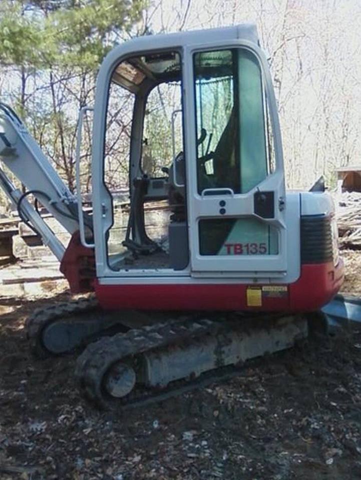

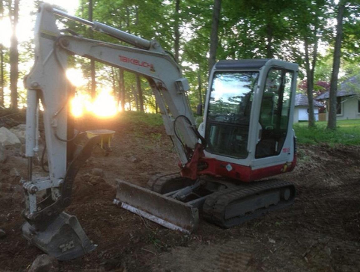

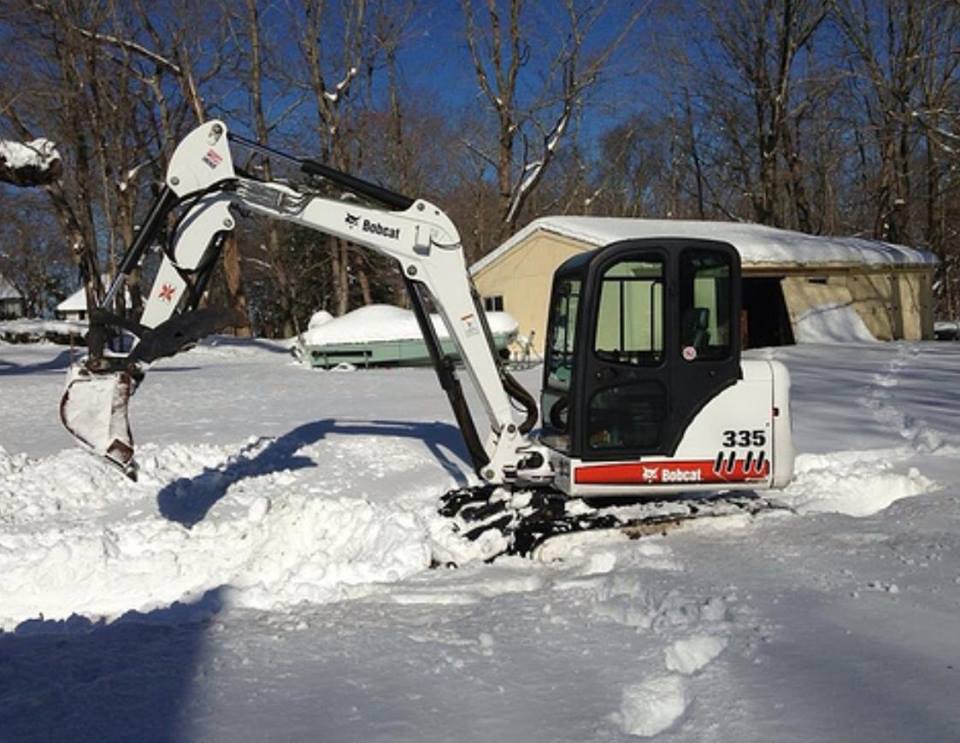

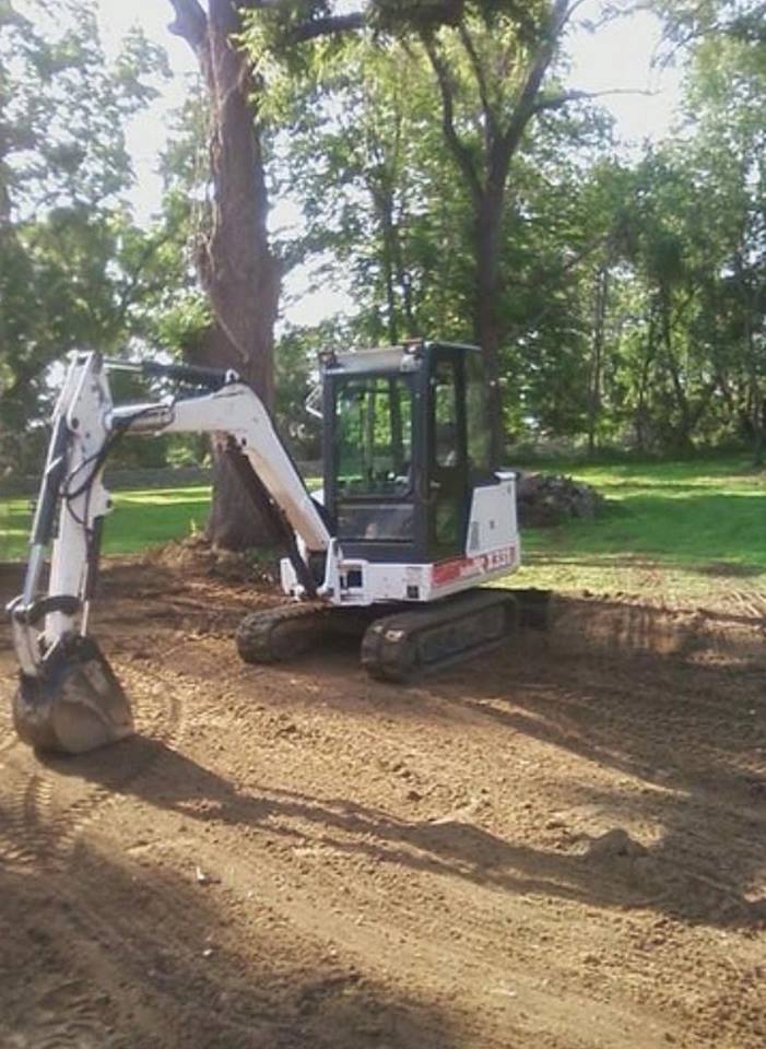

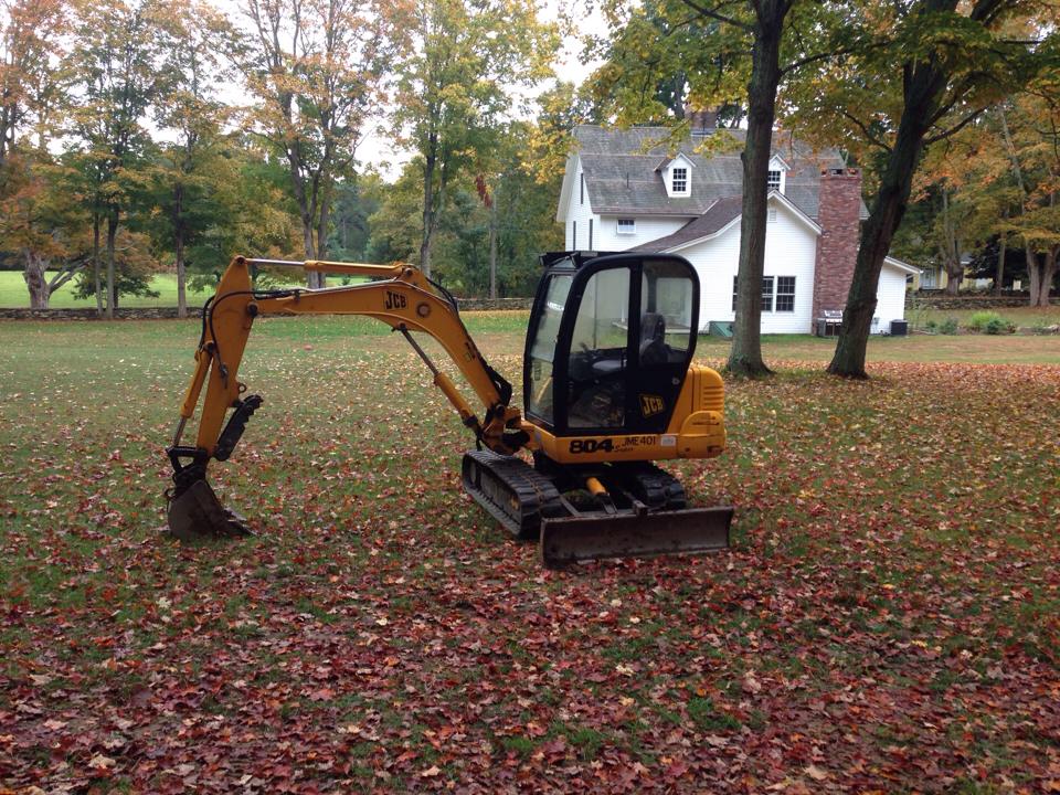

I had a few mini excavators over the years, and more that Ive ran. I started with a Takeuchi TB135. Then I got a Bobcat X331. Then I got a Jcb 804 super, and then after that, we use a Bobcat 335. All are good machines, but this bobcat is by far my favorite. If you are doing residential landscape work I would suggest getting a 3-3.5 ton zero tail swing machine. Space has never been an issue for me because more of my work has been building and demolishing stone walls, barns, building pads etc. I have only had one Mini without a hydraulic thumb (the job, it had a fixed thumb) would never buy one without it. The hydraulic thumb is your best friend in landscaping, rock work etc. I would look very hard at the 430 bobcat, and a cat 303 depending on your price limit. If price isn't and issue, then i would go with a 2010 or newer deere 35d, or a Cat 303ccr.
This Is the Jcb 804 Super which belongs to a friend but I used for a while 1530426_421374471327309_718279334_n.jpg
