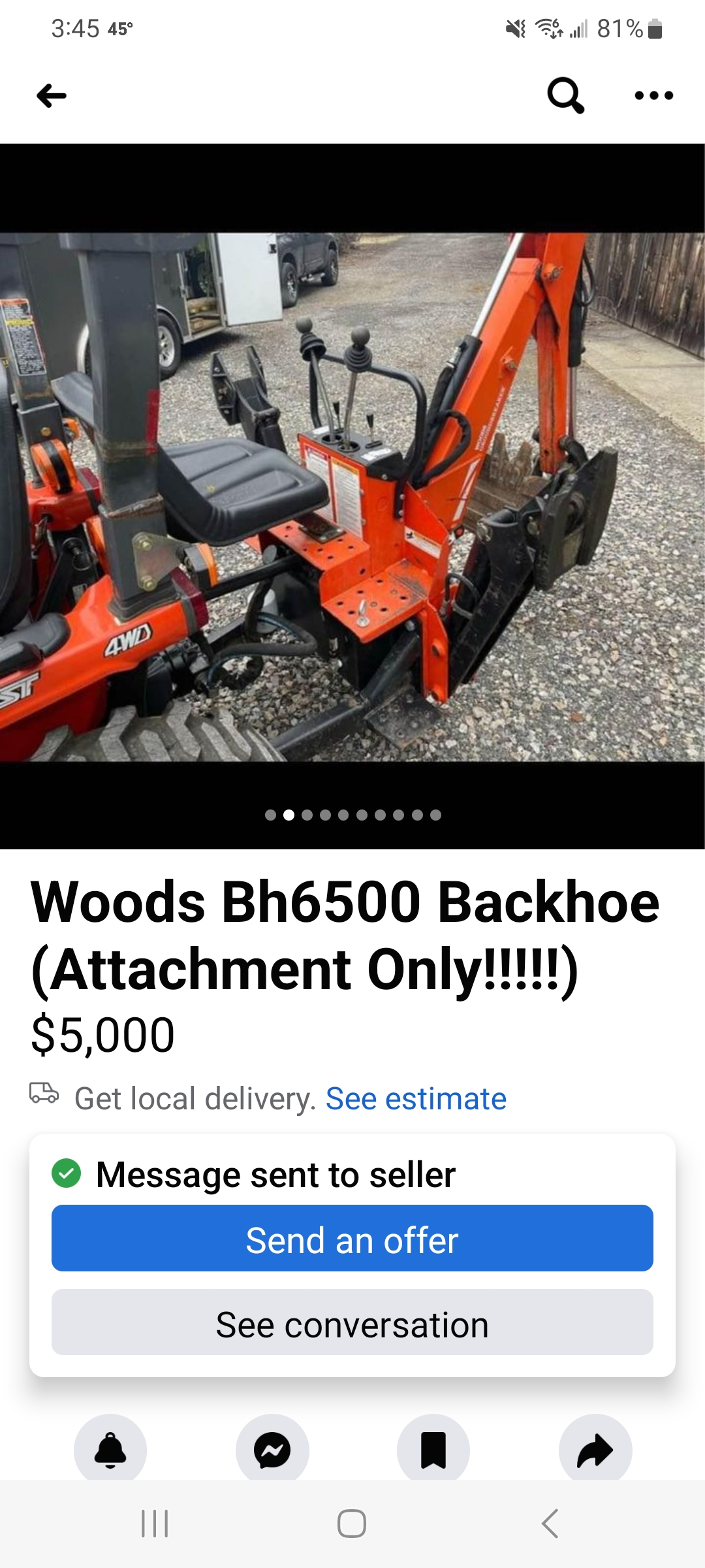

I have a B1550 tractor I'm looking for a backhoe for. Specs call for a bh65, 650,6000 size for this tractor. Looking to buy used. I found several bh7500 models but the smaller one I'm not having any luck. My question is would a 7500 with a sub frame work on my size ?

My concern is the 7500 calls for a minimum of 20 hp where mine is 16 hp and it's also 200lbs heavier than the 650.
There's a nice 7500 for sale local with a sub frame for 3500.00 so I need to make a decision I guess

   / Backhoe attachment
So my tractor has a 826lb lift capacity on the 3 pt. The 7500 weigh roughly 900lbs with the bucket I also found this which I'm told is the right size for my tractor around 700lbs

   / Backhoe attachment #7
DO NOT GET / USE A 3 POINT BH! They will eventually break the tractor in half or cause other problems.
You initially said you would have the subframe..... if so, the 3 point lift is irrelevant. You won't be using the 3 point if there is a subframe.

I've had several small 3pt and subframe backhoes. Judging from the video, this is not a 3pt backhoe because it has a subframe. As long as the subframe will fit your tractor, you won't have a bit of problem with the backhoe itself. If it were my choice - the price sounds good. I'd get it IF the subframe will fit. Use it cautiously until you are comfortable with the very slightly greater power and weight distribution and enjoy. If the subframe fits, the Backhoe itself will be fine. A subframe protects the tractor. You'll be glad you got it.
If you have any questions about pressure or flow, ask away.
