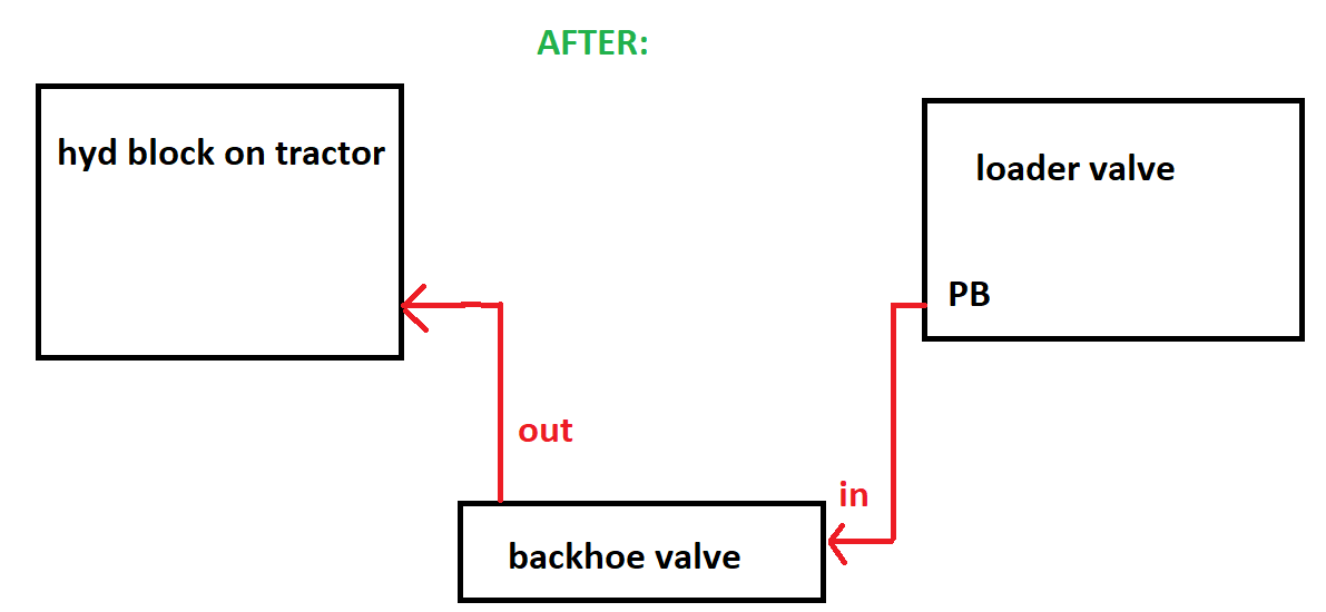

Don't I lose my loader function by doing that ?
No.
The PB port is an outlet from your loader valve, not an inlet. The loader will function exactly as it already does. The only caveat to feeding the backhoe from your loader PB port is that pulling a loader valve will cut power to the backhoe, which is a total non-issue because you never HAVE to use both simultaneuously.
If you think about where that hose starts at your loader PB port, and ends at your hydraulic block, you are basically inserting your backhoe valve between those two points.

No.
Don't you think that plumbing the system that way also depends on having a PB port on the backhoe valve stack? I think it needs a path to take the high pressure flow from the backhoe back to the hydraulic block.

So this is an assumption..but MOST backhoe valves are sectional valves where you can stack up more valve sections. On a monoblock unless you can find documentation that says so you have to wonder if the ‘return’ or tank port passages can handle full line pressure without cracking the housing. But my ASSUMPTION is that on a sectional type valve set, for SURE all the galleys in the valve sections are designed to hold full pressure and the only part that MIGHT not be rated to that pressure is the outlet housing, but i suspect it would be fine in nearly all cases.
So even though it is not always a good idea to subject a valve set’s tank port/passages to high pressure, im suspecting that on a backhoe sectional valve set that usually is fine.
I replumbed a backhoe on a small kubota tractor to work this way and it has been fine so far. I put a gauge on it and im subjecting the backhoe valve outlet to ~1400psi, no problems yet.

So the way i recommended plumbing it would technically put pressure on the outlet port of the backhoe IF you put the 3pt under pressure somehow. But if you didnt, or if the tractor has position control i dont think you even could (because it would just hit the target and stop pushing?), it is simply routing the backhoe exhaust flow through the 3pt plumbing before returning to tank, just as that flow currently does now. I recommended to do it this way because it is the simplest in terms of making or moving connections. Just ‘put the backhoe valve in series between the loader and 3pt on the power beyond line’.

I believe that Vigo327 is saying that since the 3pt hitch is not going to be used at the same time as the backhoe is installed, then it is possible to use the 3pt hitch's internal circuit as a path for the backhoe fluid return flow. (backhoe fluid OUT).
He is drawing attention to the fact that there is a return path that already exists within the 3pt fluid circuit that has the right characteristics to be able to accept flow from the backhoe and directing it to the sump. It is the same bypass pathway that the tractor uses when the hydraulic pump is running but the 3pt is not in use.
Tractors all have some position on the 3pt control that selects that bypass path and directs incoming high pressure flow directly to the sump. On most tractors - not all, but most - this is the path selected by the 3pt control when the control is pushed all the way forward.
Some Kubotas even have a thumb screw designed to hold the control in the full forward bypass position.
He is also saying that if you plumb things that way, you do have to be careful to leave the 3pt control in the bypass position and not to actuate that 3pt control when the backhoe is connected.
I think that might work. It's worth a try. It has the advantage of simplicity.
If you are going to try it that way, I'm thinking the sketch needs to have some more detail so that everyone is on the same page. There are some high pressures in this solution, so be sure to use hydralic connectors, not standard plumbing connectors.

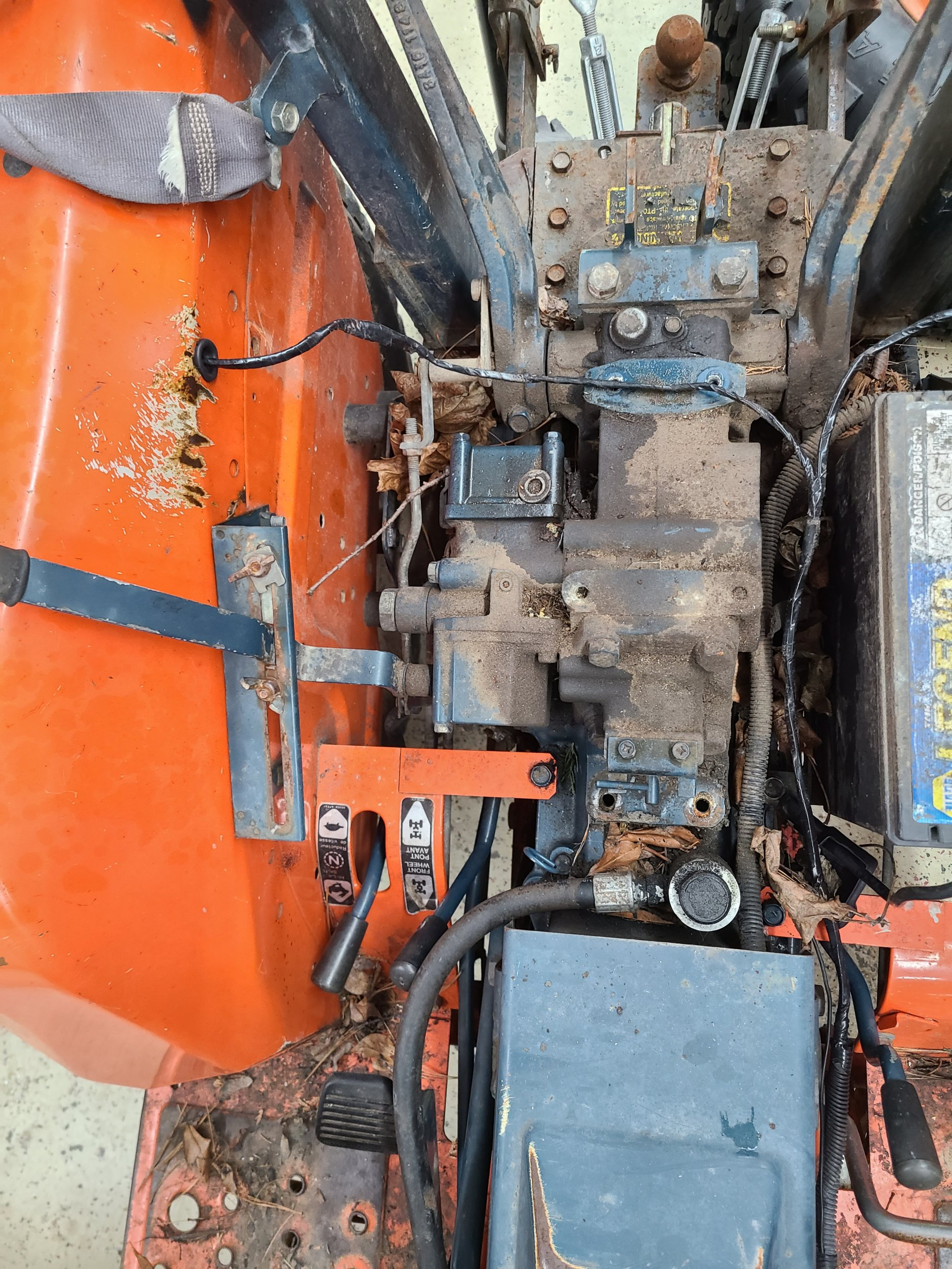

I ran out of welding gas so I can't complete the front bracket just yet but the rear hooked up rather easy. I had to take the hitch off though. My only concern is I had to remove a bolt on each side to get the frame to slide on. Deciding if I want to remove the frame and grind that section away to get the bolts in ?
I'd remove just enough metal to get the bolts to slide in for now. It won't clamp all that well with half a washer worth of compressive force missing, but you want what you can get. Looks like it will probably need longer bolts, too. Metrics will fit tighter in the hole.
Then when you get acet. gas you can weld on an extention to that ear that will cover the hole and drill new holes in the extention.

I don't think the missing bolt is intended to be part of securing the subframe so i would just notch out that part of the bracket that is interfering with the bolt. My .02.

Yes, not the way I would normally do it - but I'm glad for your idea and think it is definitely worth a try.
The problem is whether or not the backhoe will work right using the high fluid resistance return path through the 3pt valve.
Even when the 3pt control is wide open as a bypass, that 3pt return path seems specifically designed to slow the returning fluid down and dissipate the pressure. That makes sense, tractors don't want a lot of quick movement on the 3pt piston.
So I'm not sure what effect that high resistance path will have on the backhoe return. Maybe nothing, or it might slow the backhoe down too much. Worth a try.
