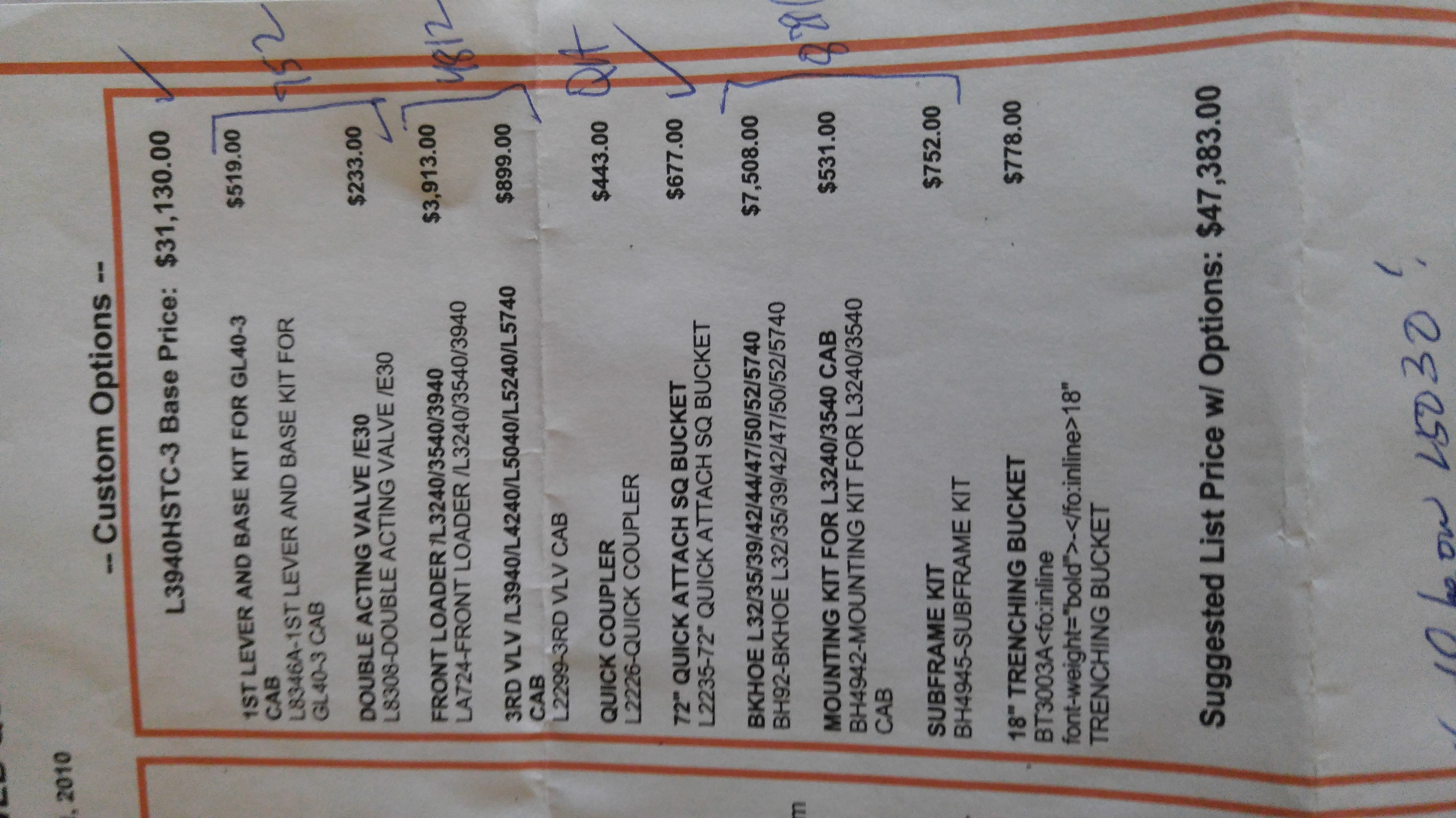

Is the extension bracket part of the "Mount Kit" for cabs (BH4944)? Or where does that come from?
   / Backhoe BH90 on L3940-3. Why not?
#12
This is only a guess on my part... Based on the difference in weight between the mounting kit for BH4943 (ROPS) which weighs 95 lbs and the BH4944 (Cab) at 225 lbs I'm going to say that it does. Haven't been able to find any parts breakdown or pictures to verify though. There is also a price difference of approximately $200 with BH4943 being cheaper.
   / Backhoe BH90 on L3940-3. Why not? #13
My L3940 has BH4942 mounting kit and BH4945 subframe. Bh92.
   / Backhoe BH90 on L3940-3. Why not? #14
Hmmm... The dealer ordered BH4944 and BH4945. I guess I'll see what happens in a few days, I'm sure we'll get it sorted out. Thanks for the photos! When I saw how the bracket is bolted onto the hoe my first thought was "My BH92 doesn't have those 6 holes" on each side but I walked outside and found that it does have them.
   / Backhoe BH90 on L3940-3. Why not? #15
That sounds right! Thanks!
   / Backhoe BH90 on L3940-3. Why not? #16
Bh4942 list price was $531 in 2010, according to build your own prices that I saved. Dealer did not break out all the part numbers and individual costs.
1486334575614.jpg,
My overall cost was way less than this.
