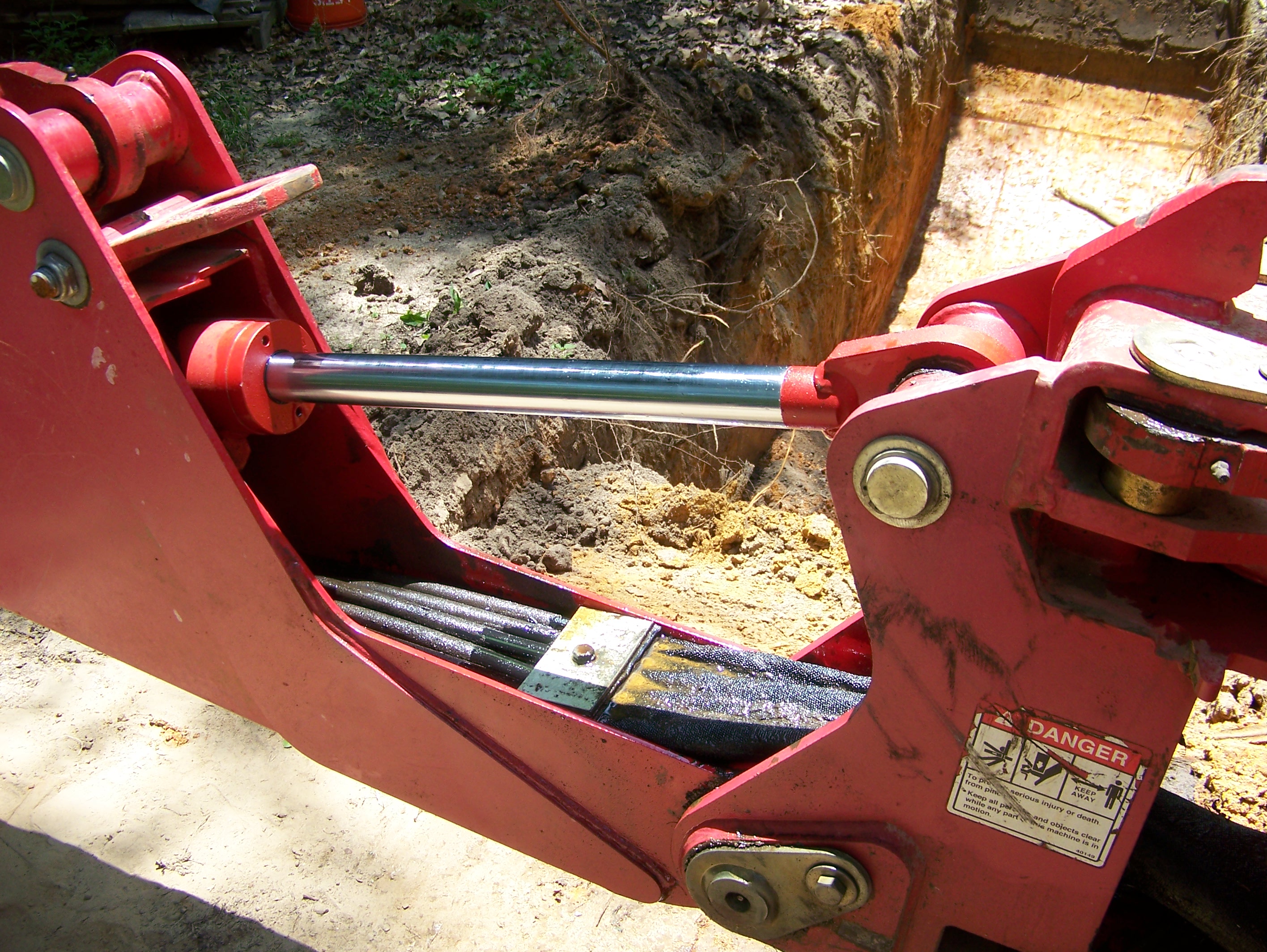

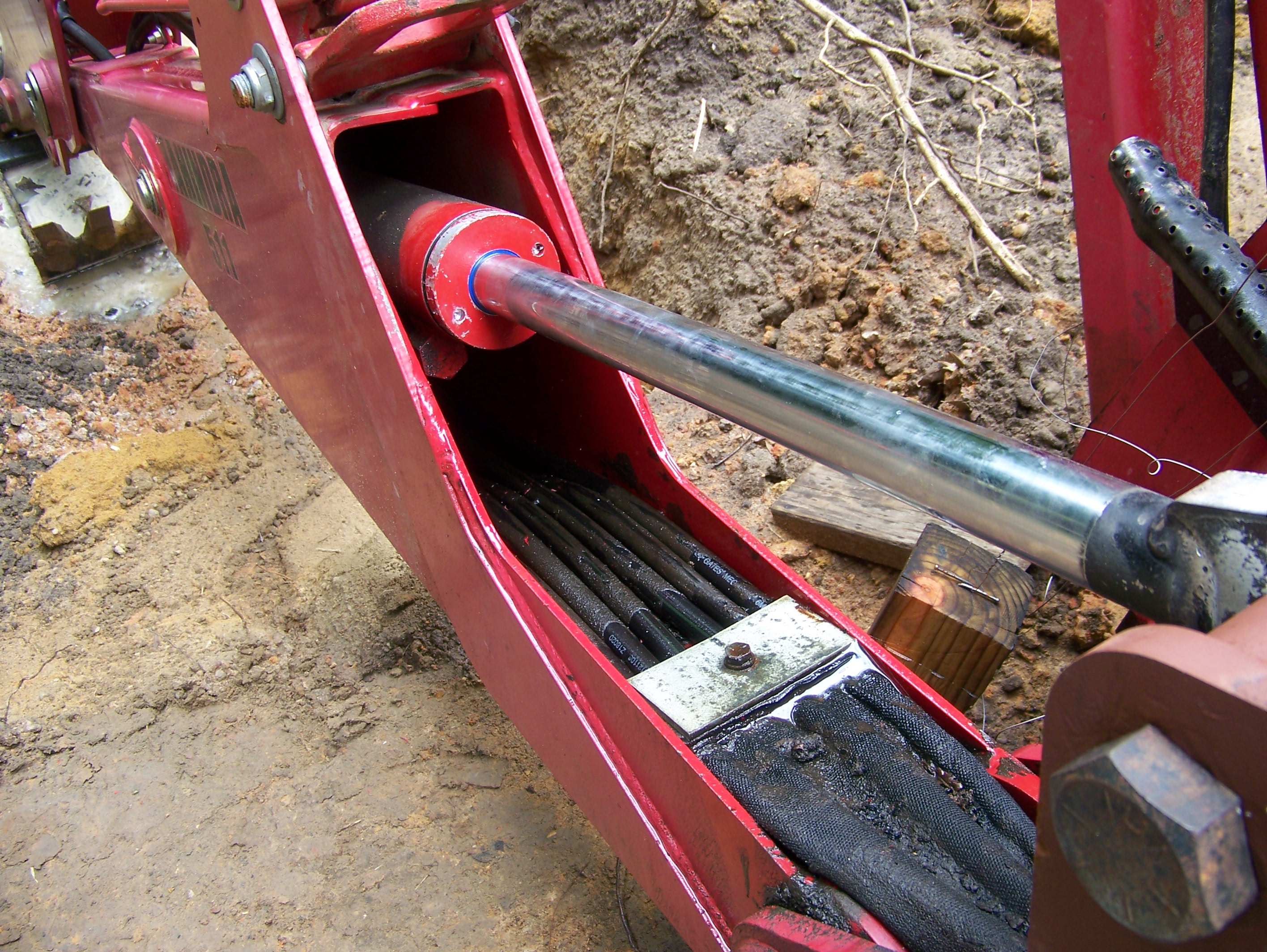

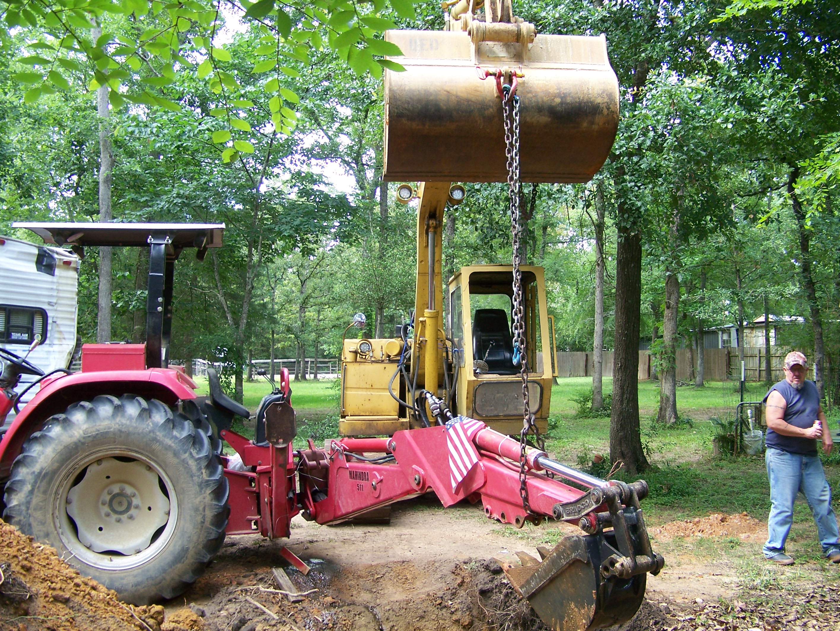

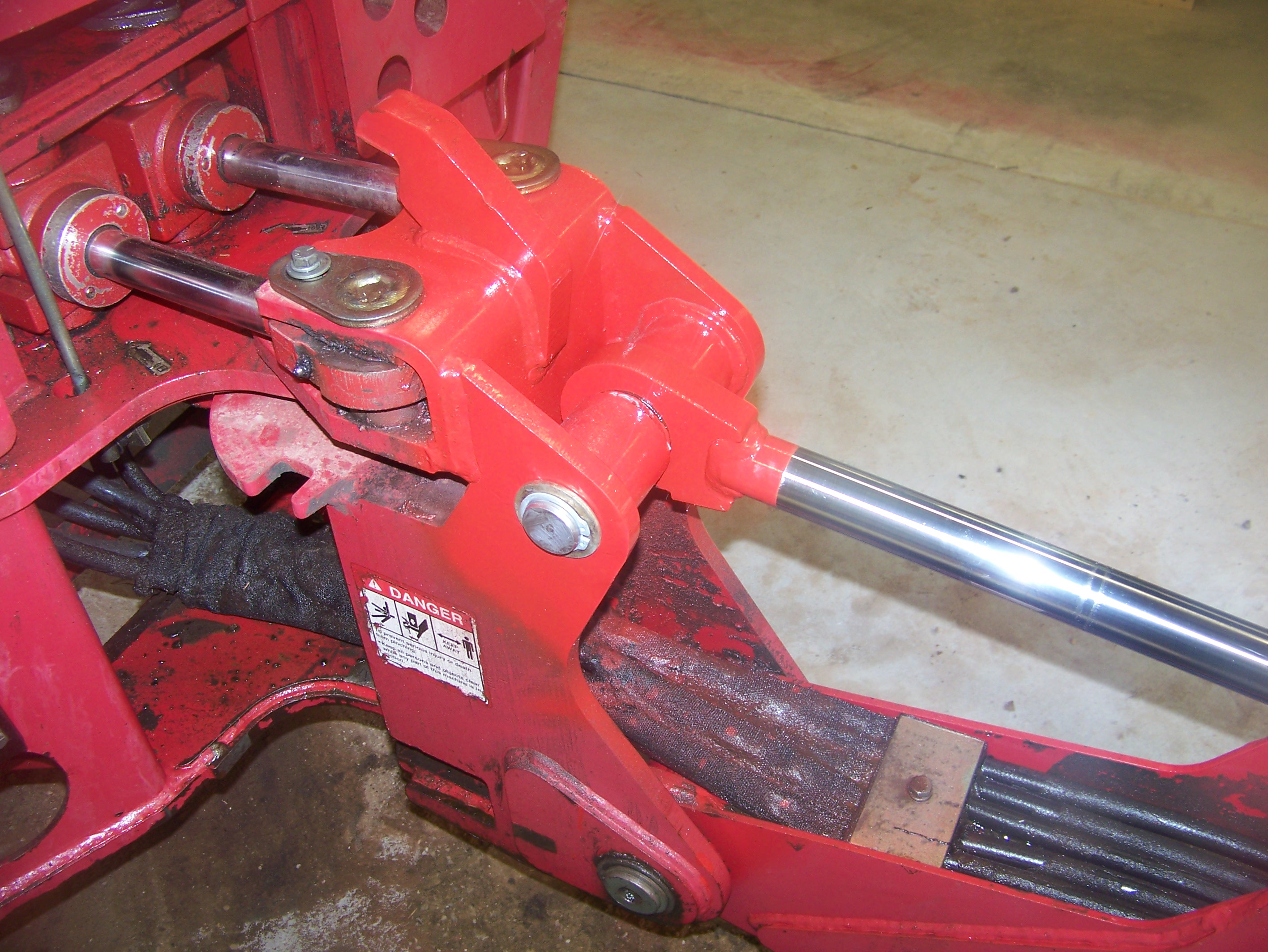

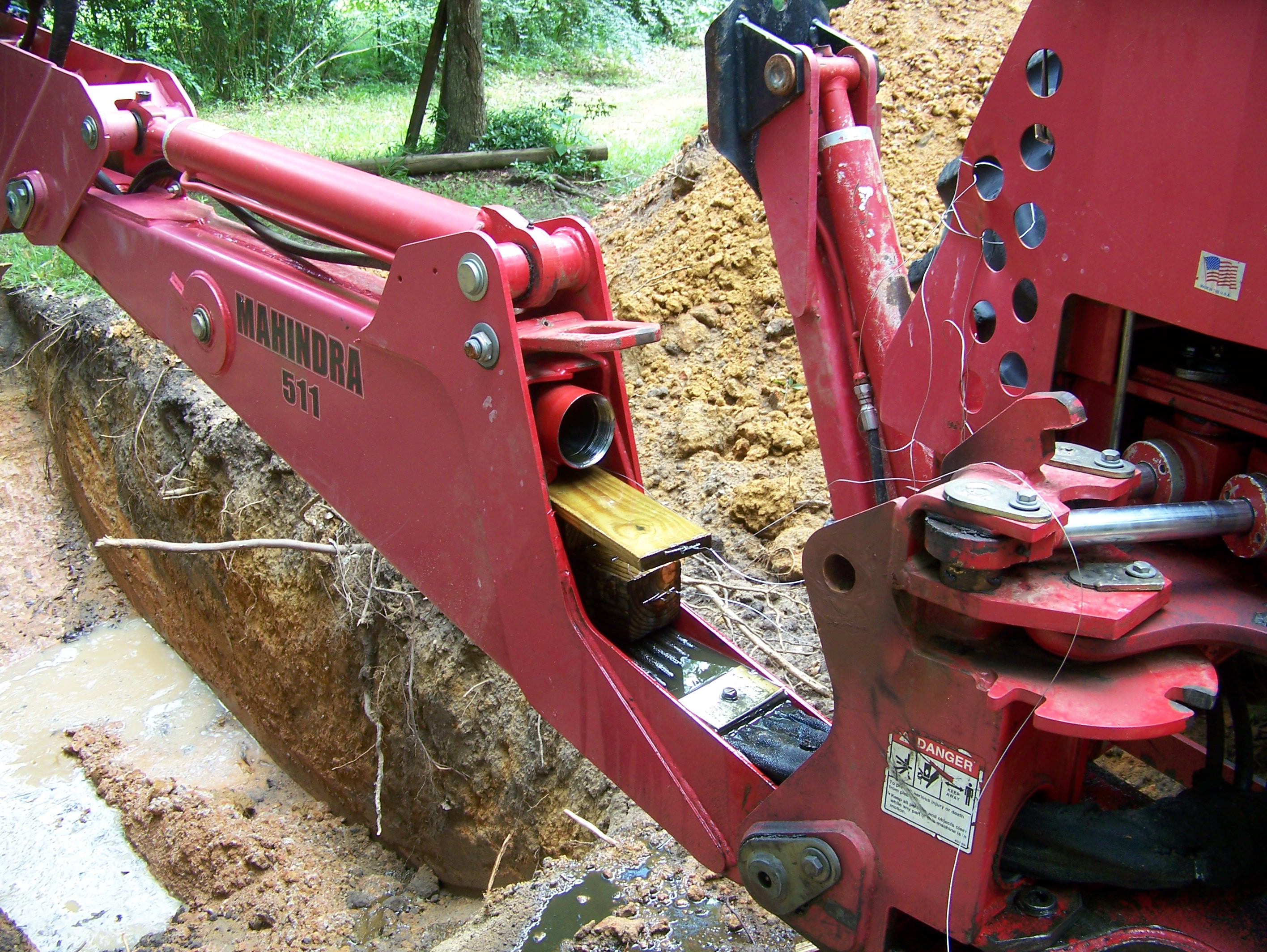

I figured I would share my plan to rebuild my backhoe's (Bradco 511) boom cylinder. The cylinder is enclosed in the boom structure.
![5-7-20 Boom Cylinder Intallation.jpg 5-7-20 Boom Cylinder Intallation.jpg](https://www.tractorbynet.com/forums/data/attachments/566/566114-e9e8550661cc54c83c9f51c3c7f4adee.jpg)

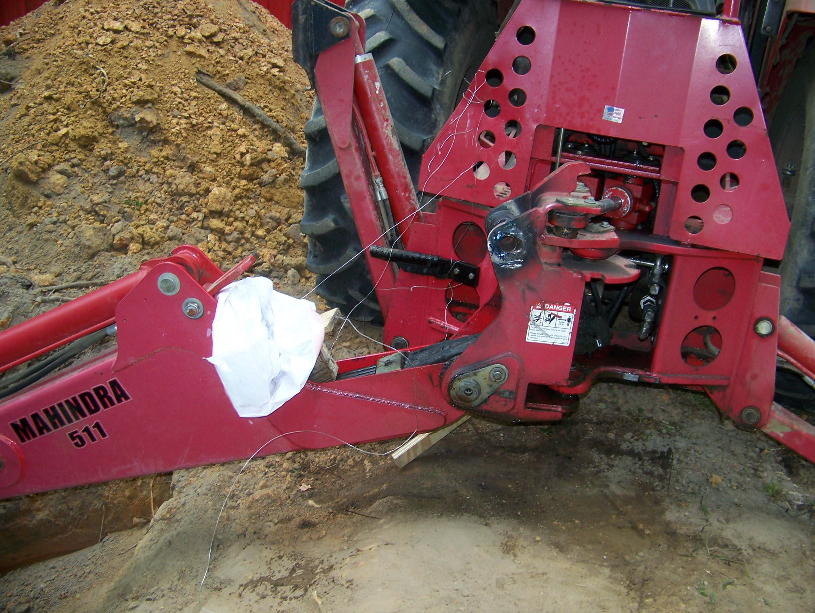

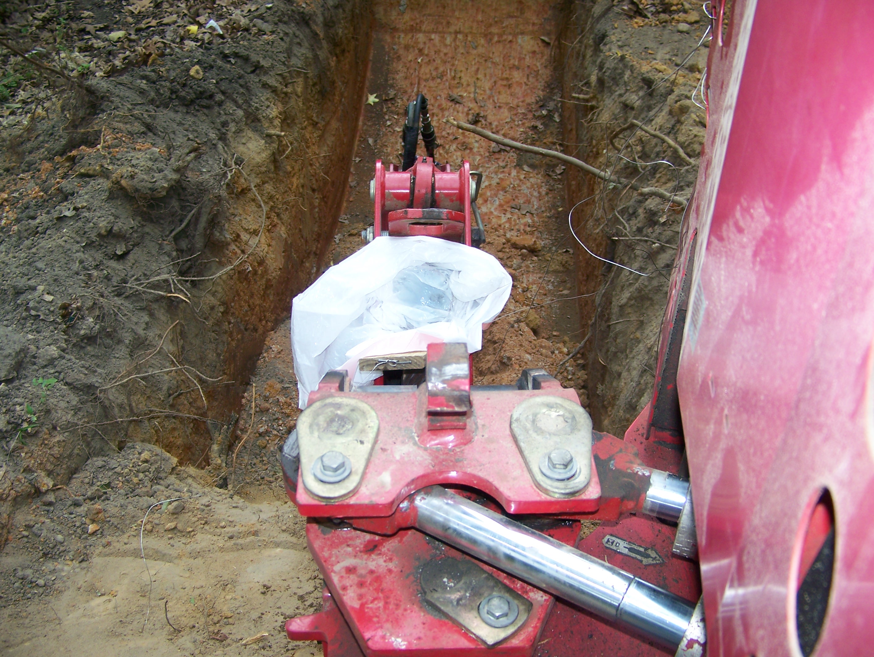

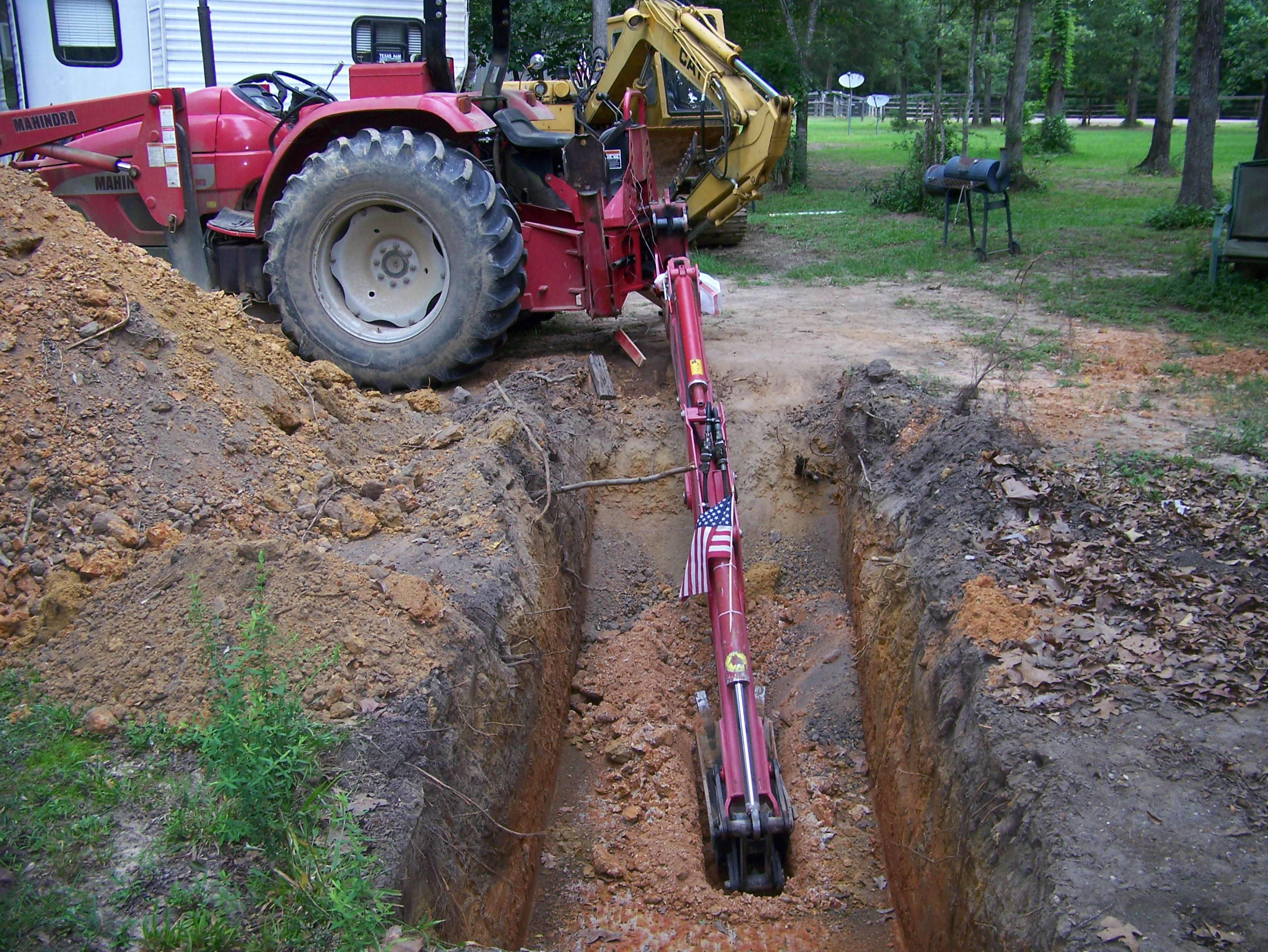

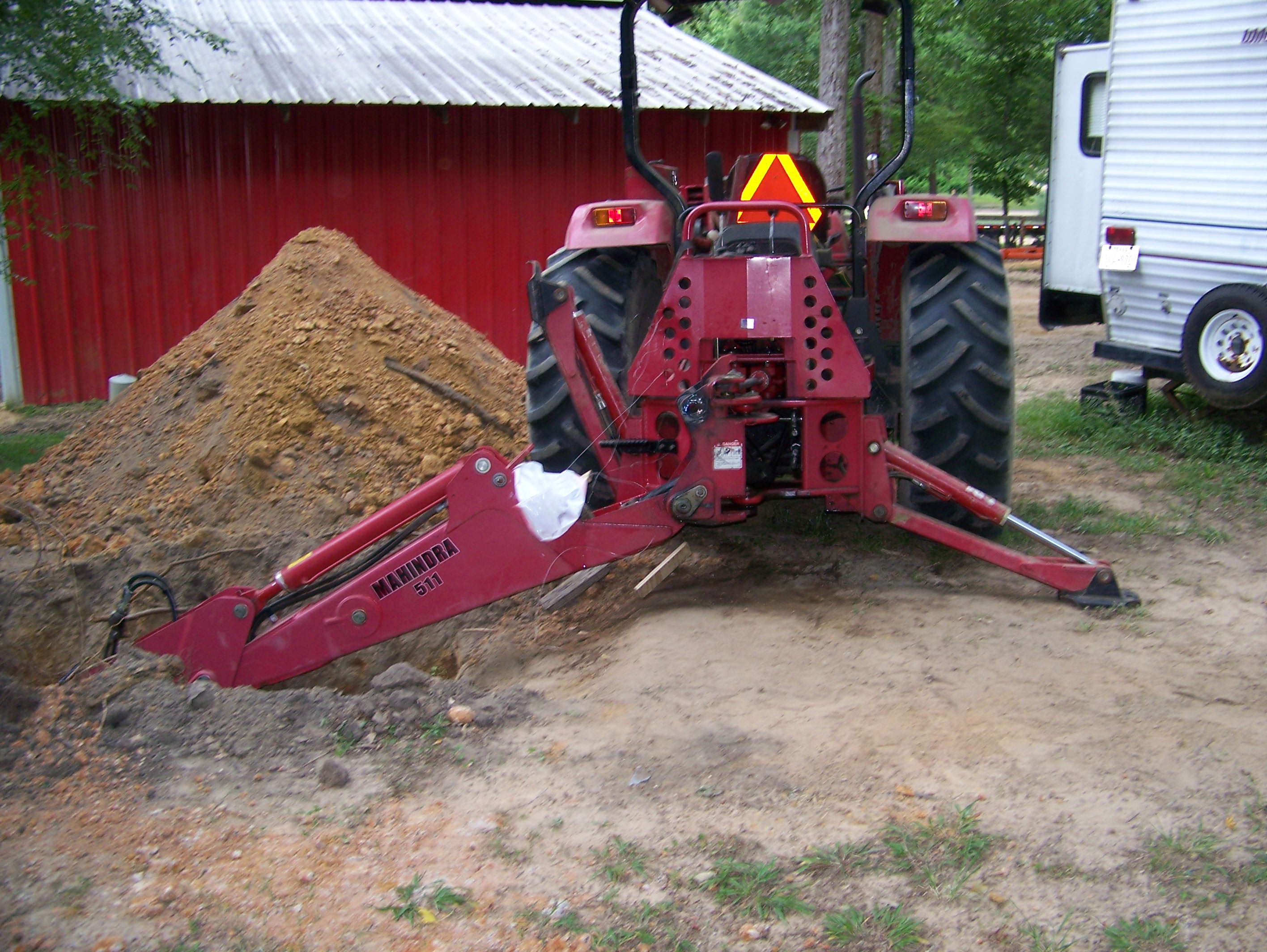

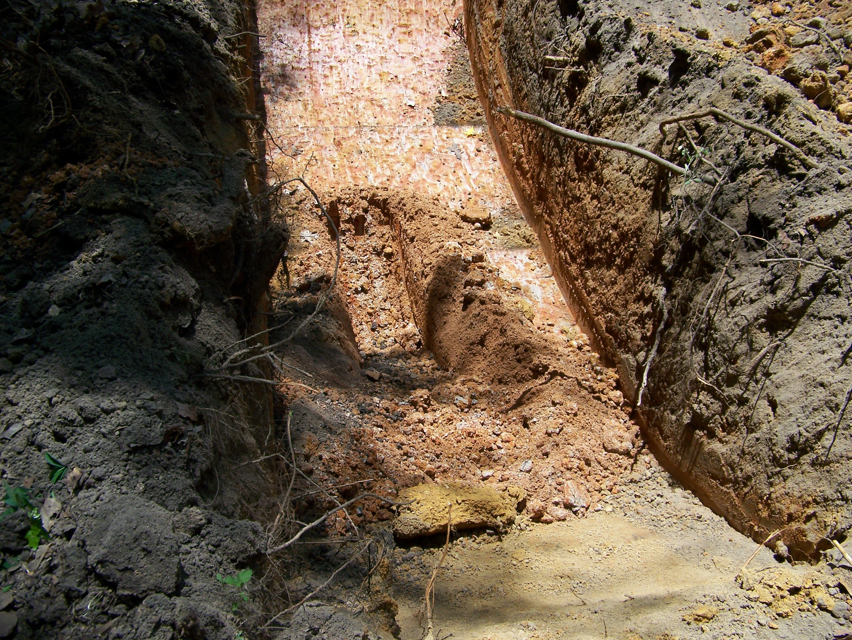

To get it out, I had to dig a deep pit so the rod could be removed while leaving the cylinder base installed, buried inside the boom. ![5-12-20 Backhoe In Hole.jpg 5-12-20 Backhoe In Hole.jpg](https://www.tractorbynet.com/forums/data/attachments/566/566080-a49fef870e5f4f56da51a48bf7984500.jpg)
![5-12-20 Backhoe In Repair Hole.jpg 5-12-20 Backhoe In Repair Hole.jpg](https://www.tractorbynet.com/forums/data/attachments/566/566072-ddae746fc2c9cd36730570999a2ba4be.jpg)
![5-7-20 Hole For Boom Cylinder Rebuild.jpg 5-7-20 Hole For Boom Cylinder Rebuild.jpg](https://www.tractorbynet.com/forums/data/attachments/566/566093-ad29574791411936e39746fef0aa1bdf.jpg)
I have rebuilt all the other cylinders while leaving the cylinder bases installed.

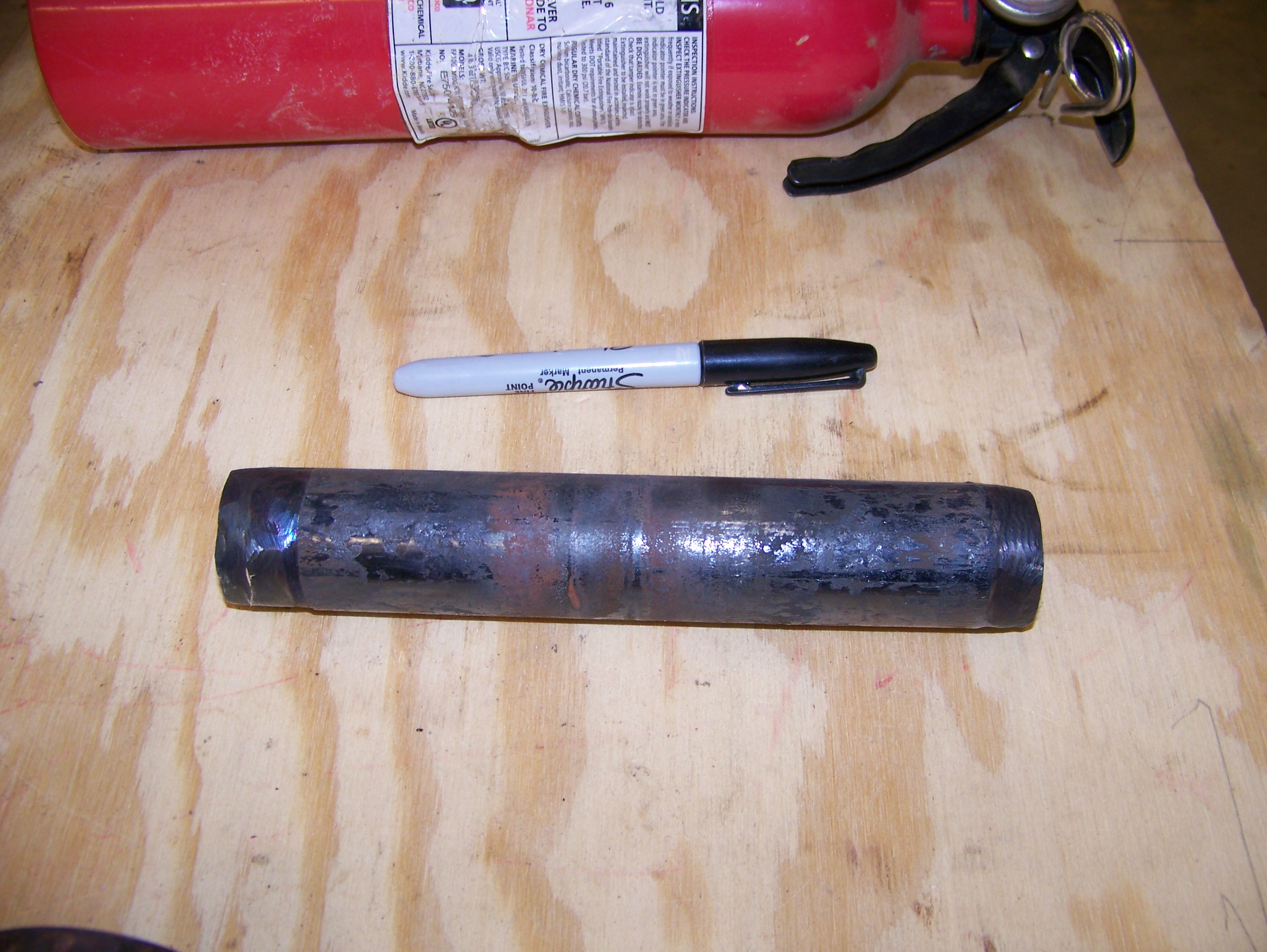

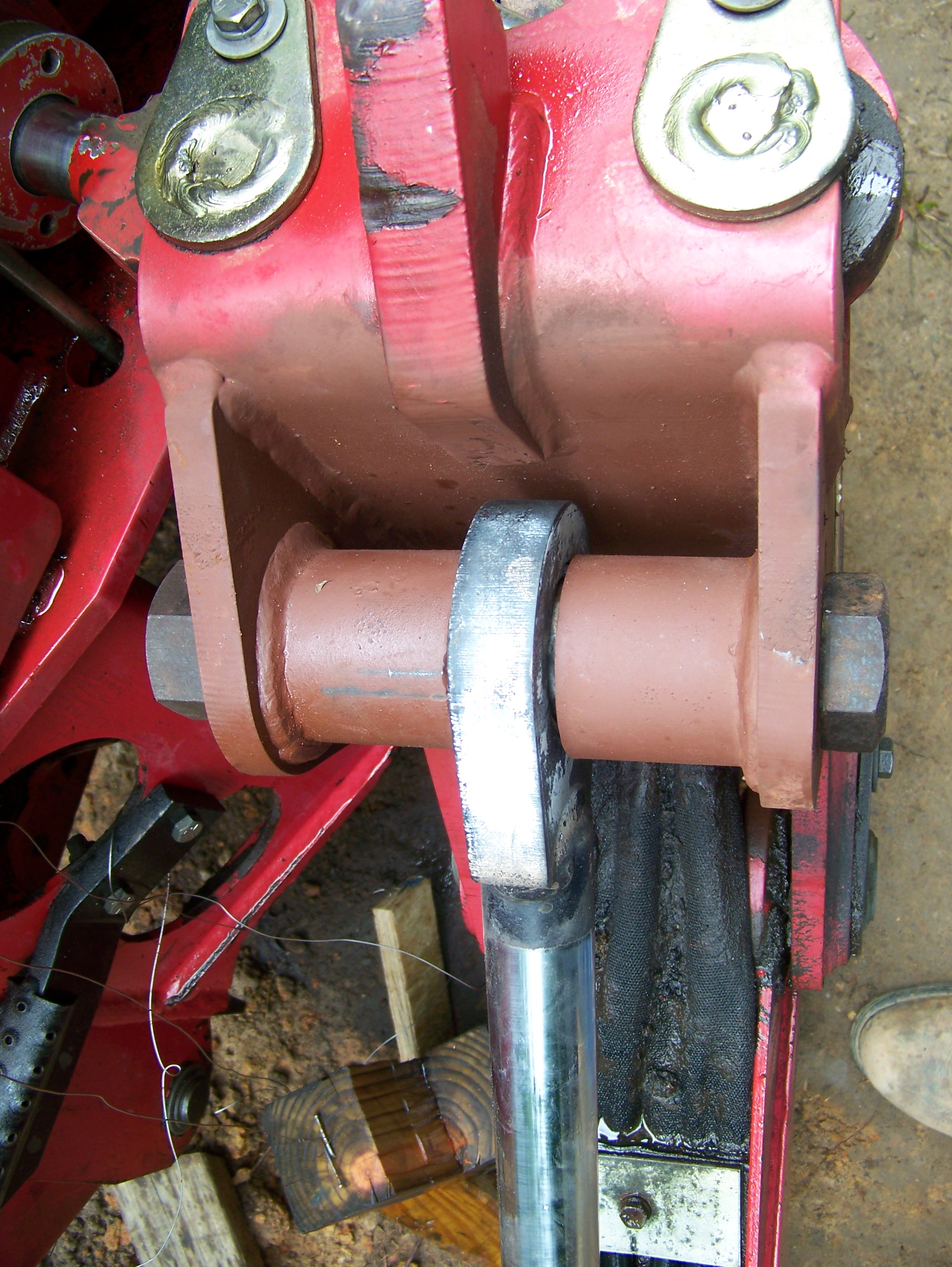

I wasn't sure if just being in a hole would work, so I backed the tractor in 90 degrees to the hole. Then I swung the boom to the left and lowered the bucket into it's new temporary home. I then loosened the gland nut enough to know I could unscrew it, without taking it all the way out. Next I went to remove the pin on the rodend. I couldn't move it.
So I went to my welding shop friend and asked for advice. He said he could help the next afternoon, so I wouldn't need to buy a torch to heat it myself. Well, he was busy and I decided to hire a heavy equipment outfit to take the pin out.
The heavy equipment guys were swamped in their shop, but they could send a truck today. 4 hours mininum. I told them to send the truck out.
Long story short, the mechanic didn't have all the "right" experience to take it out with a torch. I told him I requested pin pusher service. He left after an hour to bring a track pin pusher tomorrow. Two hours later, while I was doing a 50 hour inspection on my sawmill, two heavy equipment trucks came rolling up the driveway. All I thought was the pin was gonna come out for sure, now.
A 60 something old guy drove the second truck. He proceeded to instruct the younger mechanic all about heating and banging out "small" pins. It was a small pin, as their pin pusher was a 100 ton unit and would have pretzeled my swing post structure and his smallest pusher pin was way bigger than my "small" pin.
Anywho, they banged back and forth heated, heated, heated and had it out after about an hour. Then I saw $$$. I was paying for the old mechanic to train the younger mechanic how to remove my pin!

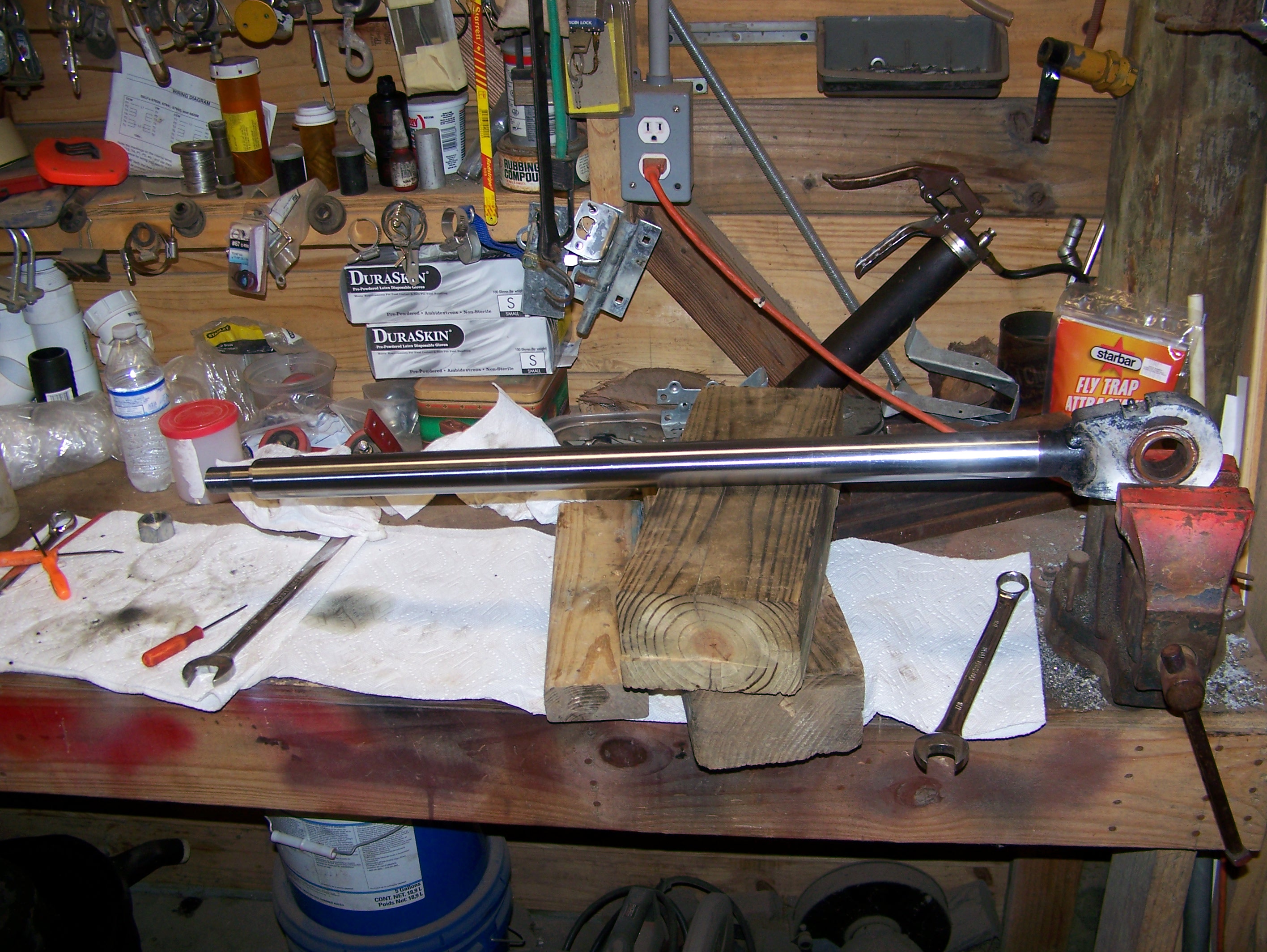

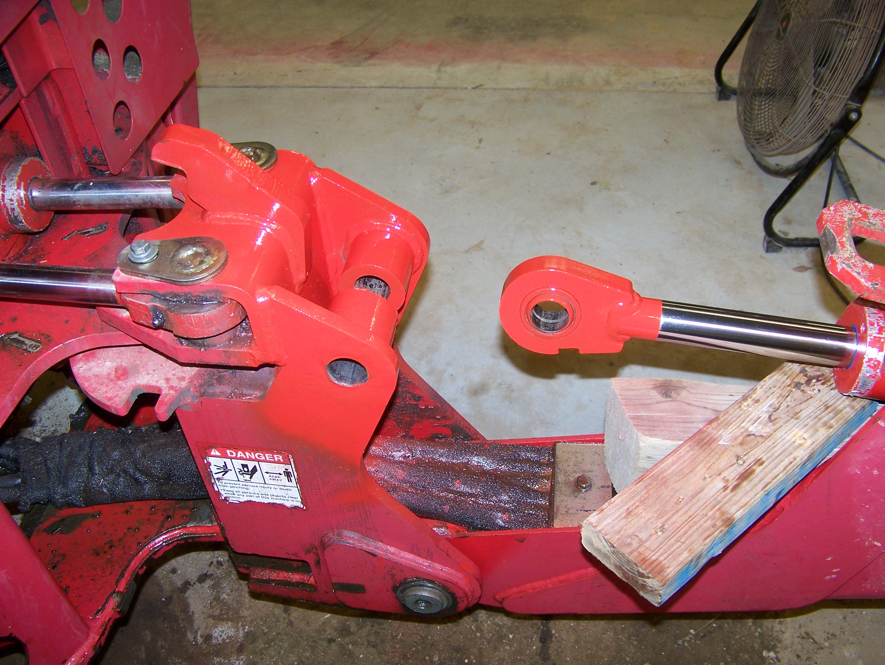

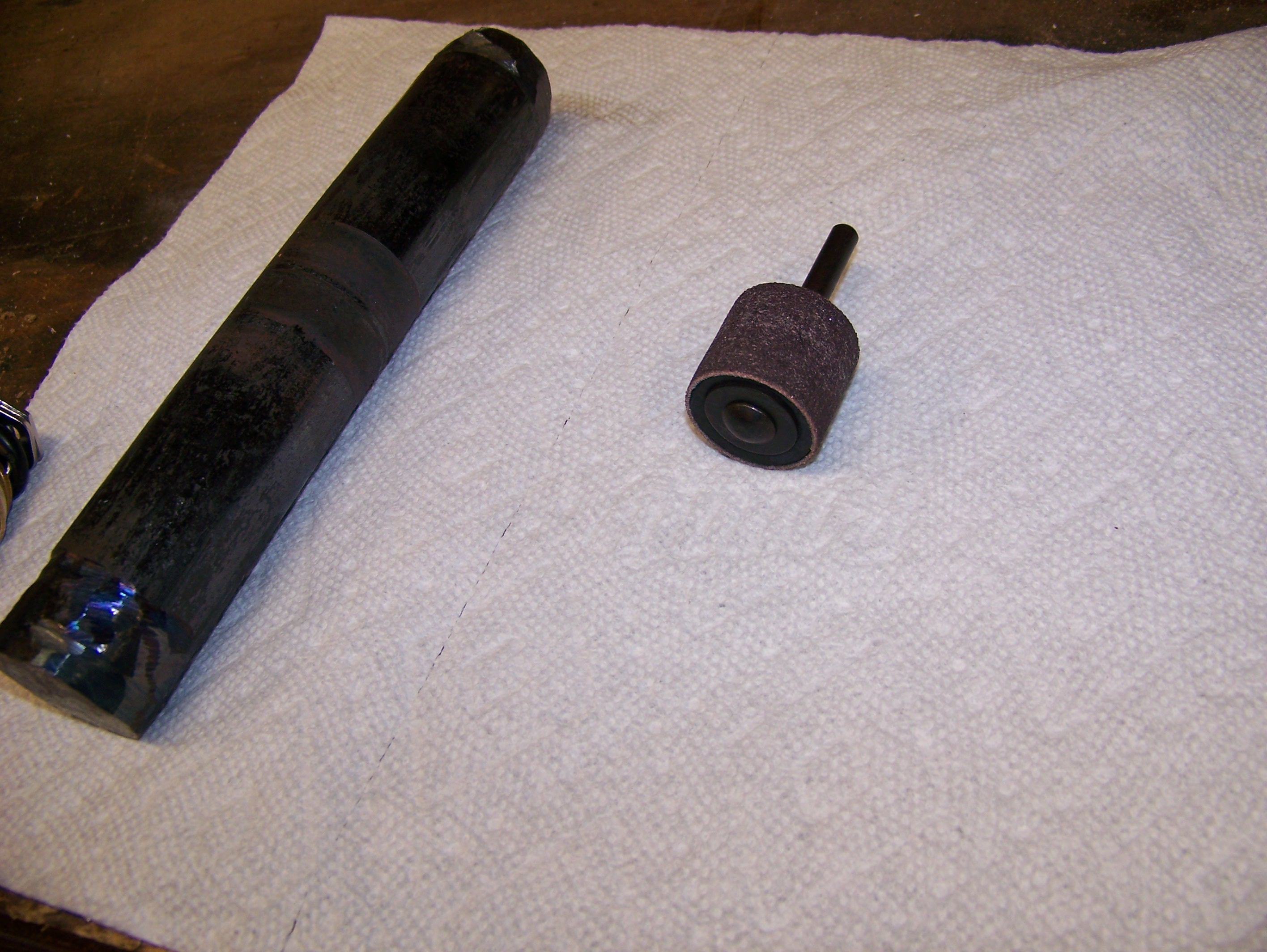

Shortly thereafter, I had the backhoe in the hole and the rod out.![5-12-20 Backhoe Rodend Pin.jpg 5-12-20 Backhoe Rodend Pin.jpg](https://www.tractorbynet.com/forums/data/attachments/566/566132-23265f4b7924eefb48558259f8e4cea1.jpg)
![5-12-20 Cylinder Rodend Apart.jpg 5-12-20 Cylinder Rodend Apart.jpg](https://www.tractorbynet.com/forums/data/attachments/566/566127-0d93099b1e6a235f26ed9a84c9019c18.jpg)
It's all apart now. I'll pick up the new pin and orings tomorrow.
